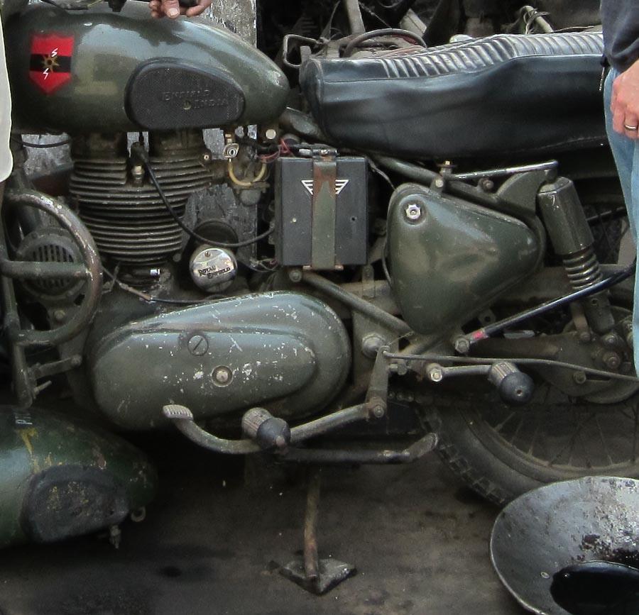

Working on a project with a Royal Enfield Bullet, 1977.  Left brake, right shift.
I am making it a street-trackerish sort of build, so I want to move the chairlike seating position to something more truly mid-set.
Attached below is a photo of the brake side, as stock.
Would like to use a set of universal-style rearsets (pegs with concentric levers) at what is the current pivot point of the rear brake lever.  Will need to fab a bracket for mounting the shift side in the same spot, but that should be no problem.
What I'm concerned about is how much leverage I'm going to get on the rear drum.  Dealing with both a shorter brake lever and a shorter actuator.  Can anyone assist with science and/or experience?  Will this work out?  (Edit:  Waitaminit.  A shorter actuator is going to give me MORE leverage, no?)
The Tarozzi rearsets I was looking at from Fastfromthepast.com have an especially short actuator.
 Would like to order one of Durgam_K's folding sets, which are a bit taller coming off the peg, but he's out of stock at the moment, so I started looking at the Tarozzis.  (need folders to clear kickstart lever on opposite side, so the Loaded Gun and most other universal sets are out.)  Neither set, obviously, is going to match the big honking brake setup on there now.
Thanks and happy holidays!

No universal rearset brake lever will have the same lever ratio as one for a stock drum brake. It's a trade off between looks and function. The Tarozzi lever will need around twice the pressure as the stock setup to apply the same braking force.

Thanks for the reply!  In my case, it's about the location of the controls more than the looks of a trick set of pegs.  Universals just seemed the easiest way to go.
Any ideas on something I could do with the ergos I want that would give function closer to the original?

AgentX
Let's assume you need a 20lb force (or whatever number you like) to stop the bike with your foot at the stock brake pedal. Mulyiply that 20lbs by the distance from the center of the pivot to the pedal pad. Take that number (the torque at the pivot) and divide it by the distance from the center of the pivot to the brake rod. That will give you the force on the brake rod. Now take that number and multiply it by the distance from the pivot to the brake rod attachment on your new rearsets. Finally divide that nuimber by the distance from the pivot to the toe pad on your new rearsets. The result is the amount of force you'll have to apply to the new rearset to equal the 20lbs on the stock brake. This assumes that the forces applied to the brake arms are at 90* to the arms which they're probably not, but it will get you close.
