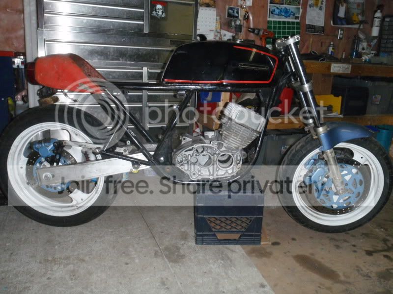

  i should have started this thread here about 12 months ago when i started the build but i've been spending more time in the garage than on the computer. here's my project anyway.
 i started out with a pile of 1974 h2 and an fz 600.
i had this mocked up for a while but just wasnt feeling it.
i picked up an 88 fzr 1000 doner with the plans to use the bigger forks, 17" front wheel and the wider rear wheel and swing arm.
 just a few mods to fit the triple clamps
with a bit milled off the ends and a little bore to fit the bearing the swingarm fit right in. the rear of the frame will still need to be modified to fit though.
here it is with the fzr parts in.

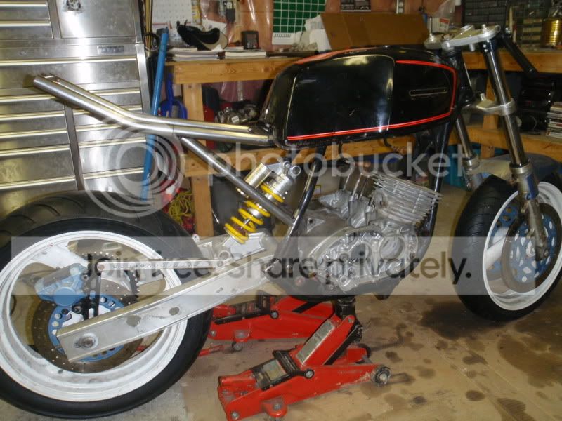

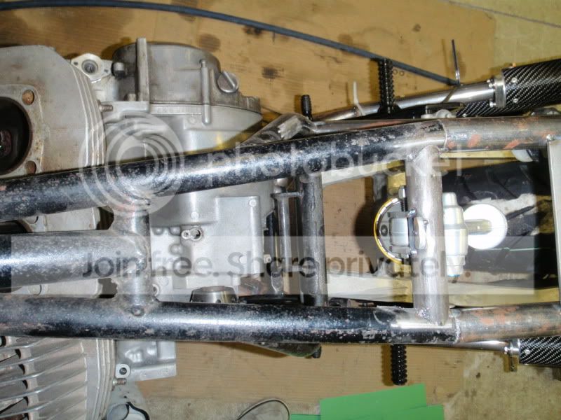

next was fitting the mono shock that i picked up at a swop meet for 10 bucks
i cut off the bottom part, cut it in half and welded it on the top.

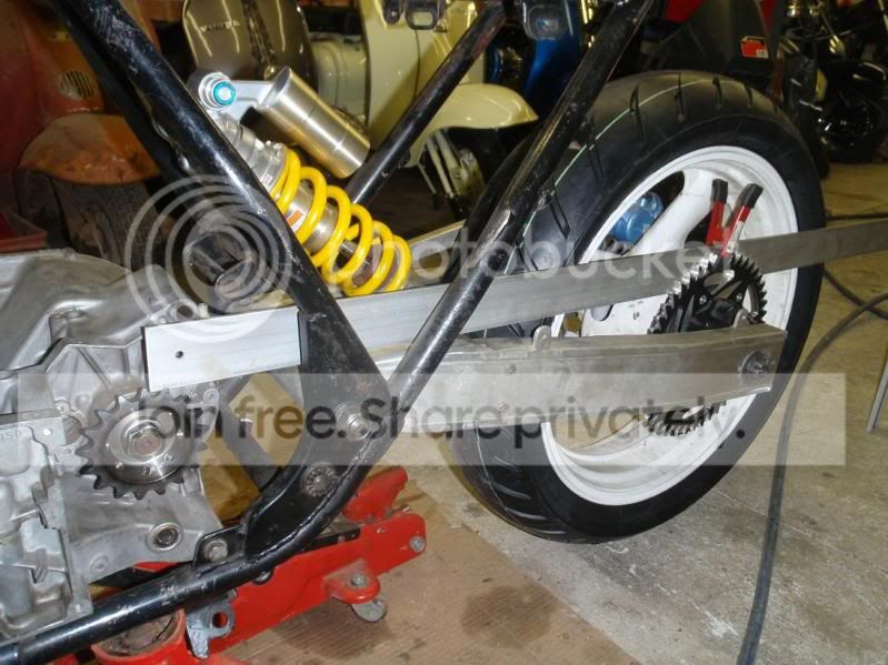

a few mods for chain allignment. got an offset front sprocket along with a spacer and milled a bit off the rear hub.

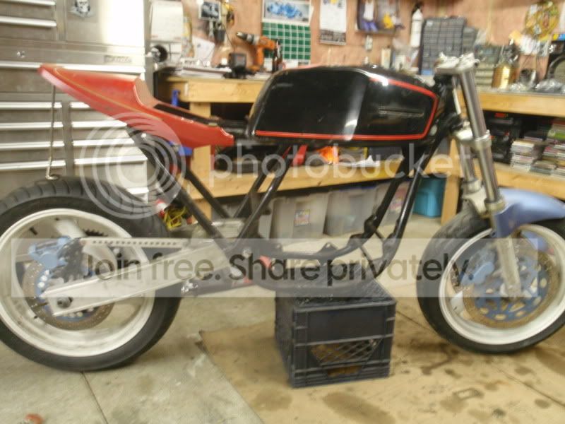

i wasnt sold on the seat/tail section either. i went through a few settling on this bimota seat.
next was the frame. i picked up some steel tube and a conduit bender from work and made it look like this.

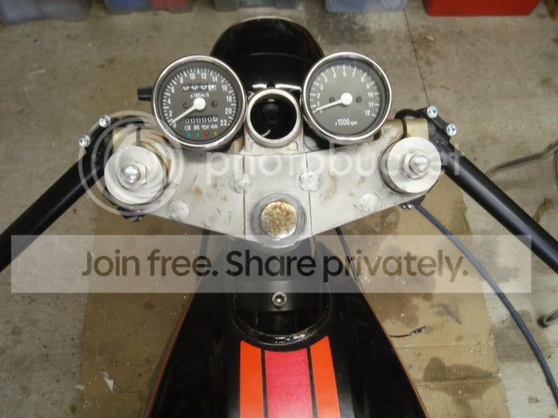

gauges,
lights,

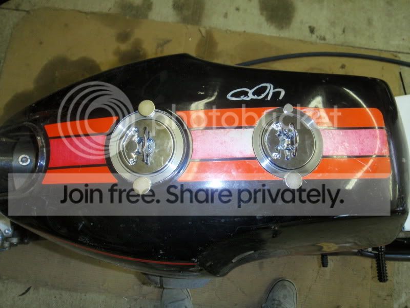

and now the tank. i added these flush mount aircraft caps and incorperated an oil reservoir under the gas tank with the filler going down through the gas tank.
here it is with a new front fender and some primer on the tank and tail. these are my most recent pics and how it looks today. hopefully off to paint and powder this week.
if you're not bored yet, keep reading. the engine is a whole other storey!

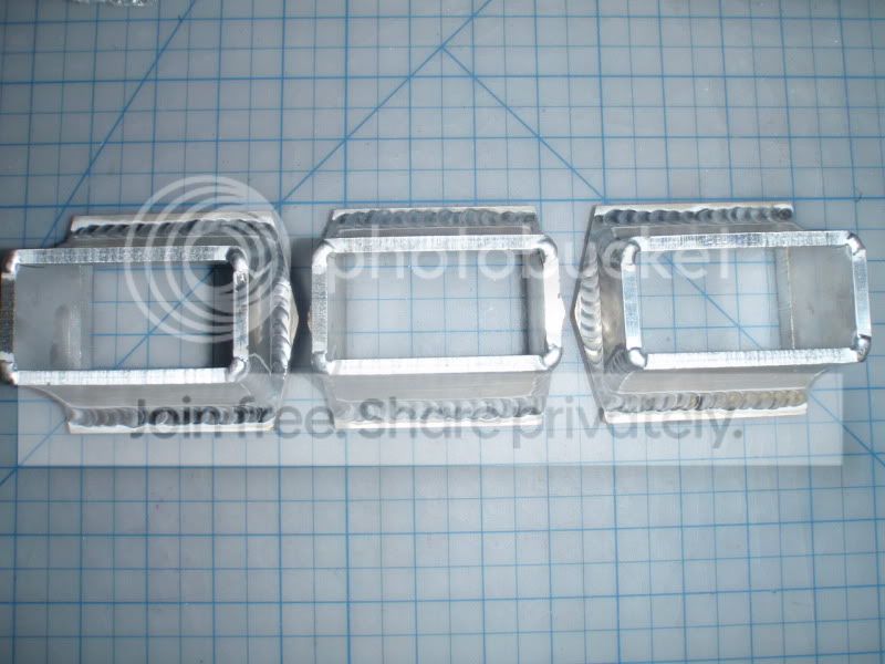

and custom reeds! from my genius brother inlaw!

Nice job man, the oil reverse is neato. love the welds on everything

wow.. looks great. this is gonna be one hell of a bike.... do you have any more pics of the mono shock up? im thinking about doing something similar with a seca II swing arm on a rd350 and trying to get some visuals on how to mount it up

hey Ryanbfast, sounds like a cool project. heres a pic of the top mount for the shock. i made a cross peice of tube and a couple tabs welded on the bottom after i set the ride height and shock angle. hope that helps a bit.
