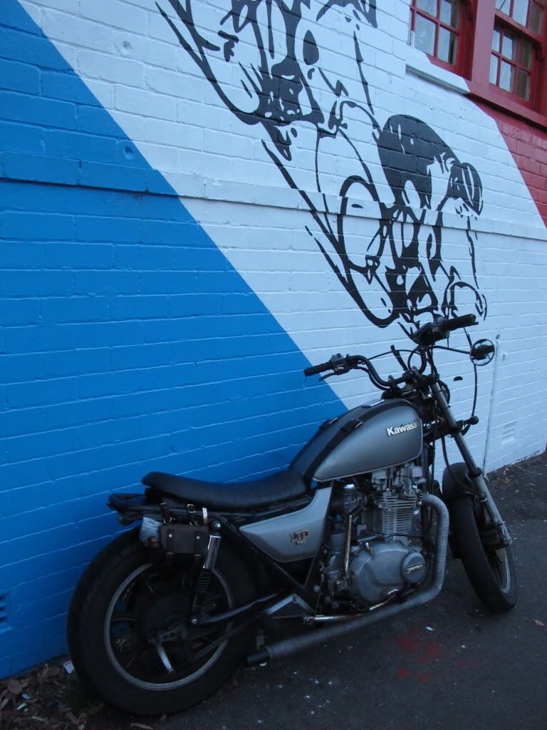

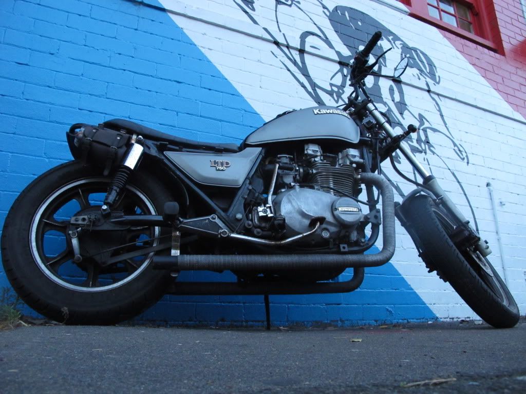

 traded for this baby last april and now its finally starting to look alot more like i had envisioned.....
i like the wrenchmonkee bikes and anything that has been bobbed chopped slammed stretchedand super clean....also im more of a fan of bare metal than paint....so after i painted the side covers silver with the tank....i decided i wanted metal
here is my progress.......so far....

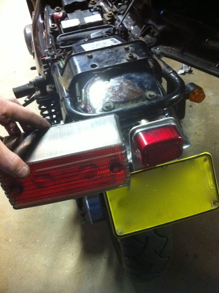

made up a smaller brake light using a trailer plastic i had lying around....
i actually used the kz globe and housing with the trailer surround.....hybrid style....ha...and smaller dirtbike indicators....
then on went the original honda postie bars.....
as seen in the first pic..... these were a little lower than the original plus alot more straight.....i felt they gave it a much more badass stance....
sourced some shorter shocks from ebay....
bring that ass end down abit.....
also it feels though the change in geometry it wants to track alot straighter now.....(harder tipping into corners) but its ok itjust means you need to steer with the ass a little more...
ive had me n the missus on it no probs with the shorter travel....
heres where the bikes name comes from.... the shocks are on the hardest preset....strap on sally is doing gnarly things to your ass.....all in a good direct way though....haha.
the huge stock seat had to be excused of its duties.... now sally bites....hard!
i love the nitroheads seats so i decided to get one......thanks ebay.....previouse owner didnt like the seat coz the stitching is slightly crooked....so he sold it to me for a gem price....
also the stock mufflers had to go..... on went some straight pipes with internal baffles to give some shhhhh...... (originally i had used the baffle bolts through to the rear exhaust mounts-they were cheap chinese bolts and coz they were stressed one blew out under hard exeleration- i thought "shit ive blown a piston/rings") but it was all sweet...
upon mounting the new seat i had too cut off the rear tab on the fuel tank....
it rattled around like a bitch and was making the bike feel very dodgy so i made up some belt straps to hold the tank down tight........(inspired by one of shinya kimuras bikes) it works really well and the bike felt solid as a rock after the straps....(also fits in nicely with the 'strap-on sally' theme....
i flipped the number plate off to the side with a custom mount coz i like the look of the clean rear.....open wheel etc...
heres some shots....
oh by the way i removed all gauges and lights..... for the clean look.....
plus you really take alot more notice of everything else on the road without these distractions i thinks.....man and machine!
you can also probly see in the photos that i changed the headlight mounts (coz i hated the built in reflectors on the original...)
i had some from an old cb250 lying around.... i cut and tie-wired them on dodgily (but strong) till i get a new smaller headlight....
i also changed out the huge rear indicators and gave a slight bobb to rear guard but for me it still was no where near short enough...... i wanted a nice metal hoop to follow the curve of the seat....
also the new rear indicators i had put on were shoit quality dirtbike ones......which broke..... so i had to replace with some good quality ones.....
new......vs old (taped up with silver electrical tape so they would stay on after they broke)
and bare metal tank

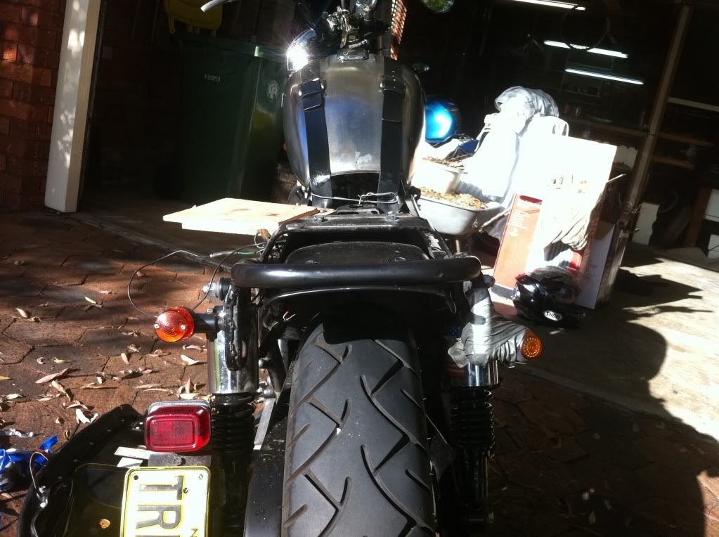

decided asap that the rear needed to go.....
i am a very impatient person..... so as usual i went out bought some metal and that day rode down to grandmas......disassembled........cut grinded welded reassembled then rode home!!!!
theres nothing quite like a 40minute shakedown run..... after EVERY MOD or a days works......
i used to love leaving my bike in pieces for a month at a time while i did bits and pieces......
but the biggest positive about doing it this way is that it means the bike is never off the road.... so no money going to waste while its rego'd n off the road...its a daily rider..... and my favourite bike to date....
so here it the new tail section before welding.....
put some sleeves into the frame and hoop to give me some metal behind to tack too......(just in case) the old stick has known to be quite harsh in my hands before....
another angle...
much cleaner.....
definatelly follws the lines of the rear seat.....

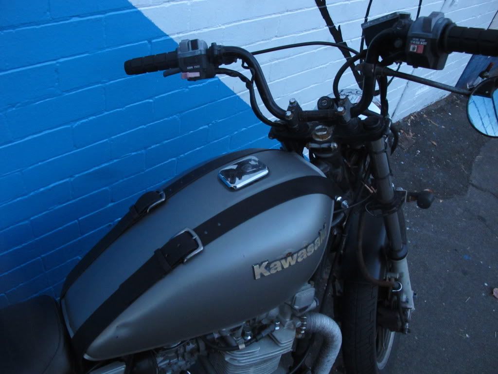

love these big kz twins.  seat and rear hoop look great.  I agree with the modern inverted fork front end swap.  ive never seen stock kz forks that werent spongy.
could you take some more pics of the mounting points for the tank straps?  it looks bad ass.
BoneDaddy: "It's like genocide without the guilt and nobody is mad about it."
74 CB360 Project: Little Boy (first bike and build) - http://www.dotheton.com/forum/index.php?topic=22976.msg243623#msg243623
80 Kawi KZ750 twin Project: Warhorse - http://www.dotheton.com/forum/index.php?topic=23885.0
Offline sinbad85
  • Posts: 329
Re: here goes: 1983 kz750 twin (strap-on sally) from down under!!
« Reply #9 on: Jan 24, 2012, 19:19:36 »
dp- took some photos this morning with my old camera......
to attach the straps (just vinyl belts from jay jays 10 bucks each)
behind the neck of the frame there is a tiny gap between the lower backbones and the top.....(kinda hard to explain)
i just bent a long bolt slightly and punched the bolt through the belt..... then used rubber grommets between the frame and the belt (to spread the load on the belt so it doesnt tear) and so the bolt doesnt touch the frame....to avoid any wear.
on the outside of the long bolt i used some trackstand bobbins i had originally  bought for the vtr...
i used the bobbins so i can hook an occy strap to them and tie stuff down to the tank when i go on a longer ride....
(i plan on riding this thing from sydney to cairns and back......eventually)
the bottom part of the belts has been bolted to the frame......(where the battery bolts are) {not the + or -} haha
then you'll see the dodgy coat hanger which allows the seat to slide right up.....(i plan on welding some steel bar to the frame which will be alot more permanent than this temporary fix) without the coat hanger on there the belts slip to the side of the tank)

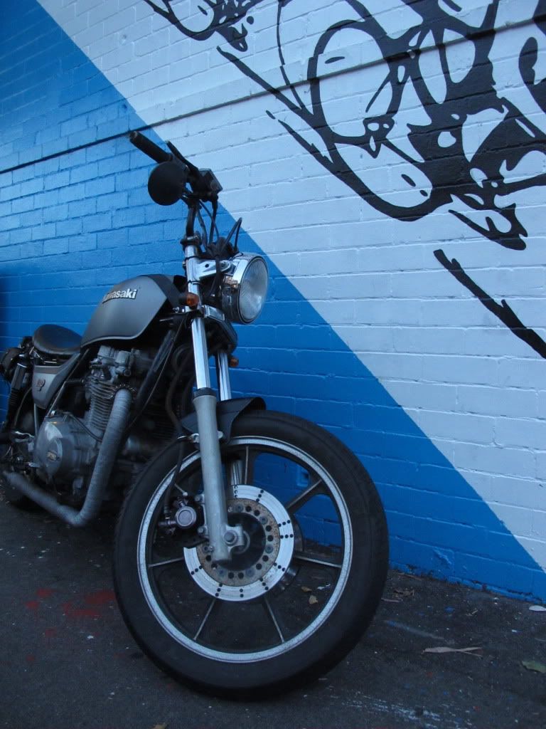

so i got the drag bars on!!!!
and the new master cylinder!!!! my custom hydraulic stainless steel lines were JUST the right size...... i had to actually drop the front end 5mm just so there was enough slack in the lines......
pulled off both calipers and gave them a thorough cleaning then flushed the system and triple bled the brakes....
FARK YES.....she pulls up so much better now.......the bike must have had the originall brake fluid in it......only 28 years old..
it is extremely tight where the banjo bolt at the m/c comes out.... it is about .5mm off the top of the fork...
i might get some new risers/slightly longer steel line...just so i can lower the angle of m/c and brake lever.....(its needs about 3 degrees more to be perfect)
i had to get quite creative with the throttle and clutch cable routing......but i will shorten and re- route them asap!
underslung postie mirror.......
i took off the old pegs a while ago and put on some bear claws that my mate had taken off his dr650
heres the shot of my tack job on the hoop.......ugly i know......but it is strong......and it will be tigd up soon. then painted....
i took off the "kawasaki" front brake line splitter cover.....i think it looks alot more raw without
new downtube mounted indicators to clean up the front forks.......(mounts will be painted)
and last the obligatory standard side shot.....

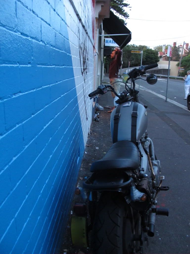

i think im definatley going to get a new front guard......and also put a tiny one on the rear...... when riding in the wet....like this it flicks so much shit all over your back! not cool...
my neighbour also wants to do some pinstriping in the tank.....and some latin script......should be sick!
need a new tyre on the front asap.....gotta mount the seat properly! tidy up some electrics/ relocate the key/lock!....
am looking at a new front end because you said it!!!! spongy shit front ends on these kz's!!!! prob the worst ive ever experienced...
peace
