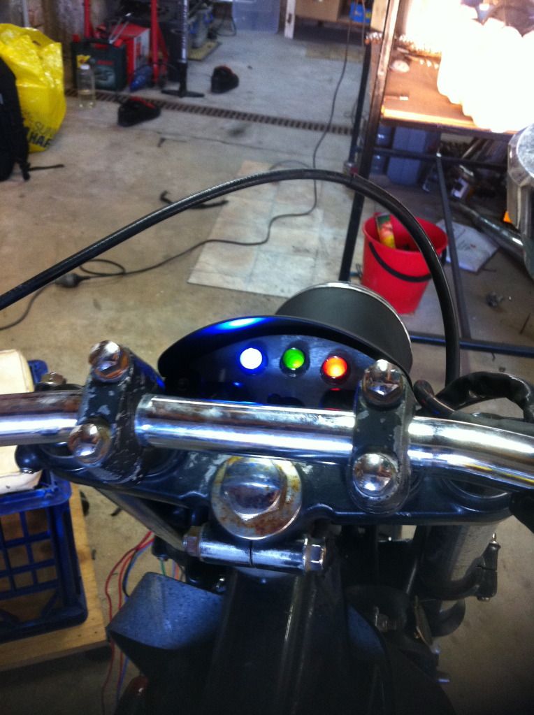

i also took a shot of the new dummy light setup that i made.....
just some 3mm ally.....also  removed the ignition key replaced with swith and hidden kill switch......

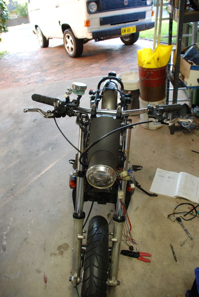

also thought ide post up how it was looking while i got the new front tyre on......
i love the look of the slammed front end and spokes......
decided to go for the more legal option for tail/brake light and license plate....

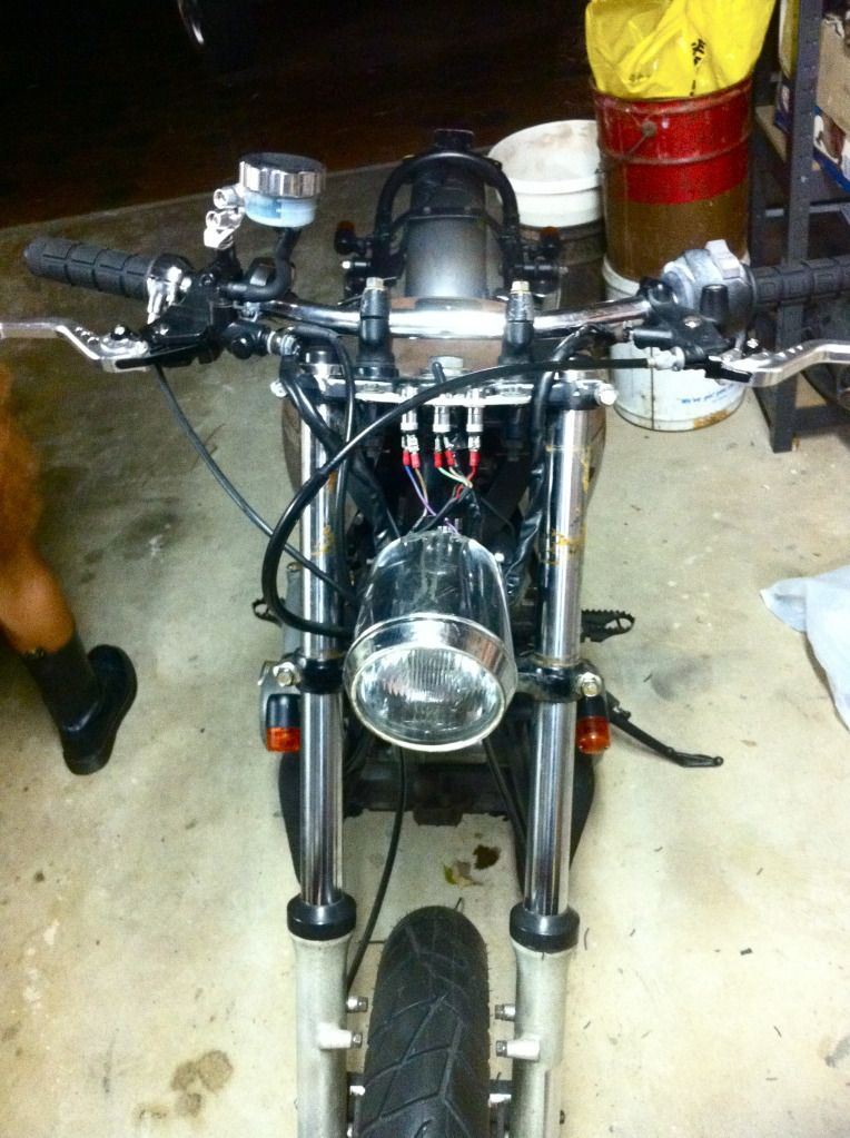

did alot of cutting and simplifying and resoldering of the loom..... re-routed the indicator wiring front and back so its all hidden and nice....removing alot of bulk.....

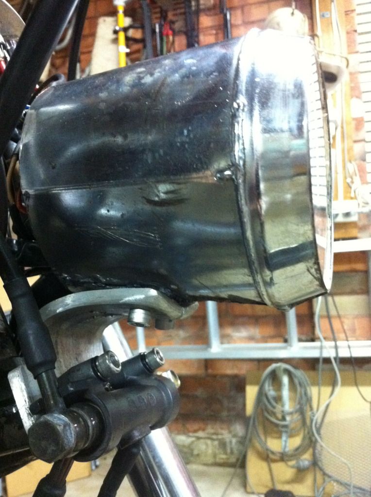

i did want a smaller headlight and while i was searching through the garage i found one from my cbr250... nice n small so i quickly searched the garage for something to house it... the plug also fitted straight up...high low beam both more powerful than the standard 7"...i was pretty surprised...
i used one of the standard exhaust cans to house the lens.... i do like recycling parts.... then i used the old front guard to create a mini bikini-ish fairing....which hides all the wiring to the leds..... ill also say that i am now a master of heatshrinking and soldering cables.... very satisfying when completed.....
then i took on the task of wiring the new left hand control.... half done at the moment.....
anyway pics tell you more than words....

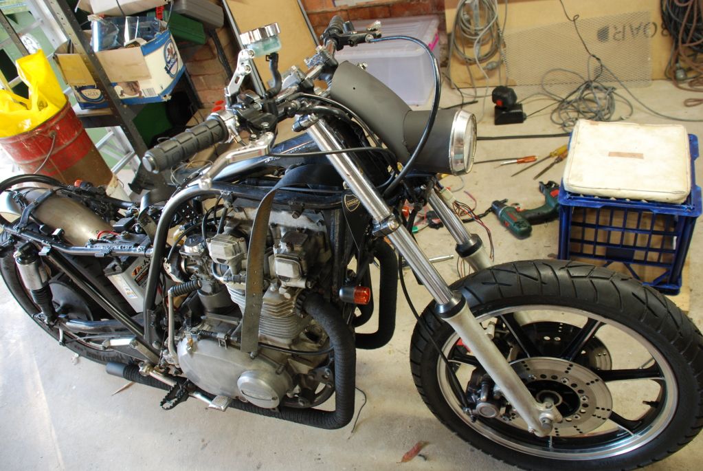

heres some of getting the position of the light......then as she sits now.....
Offline DP9
  • Posts: 741
Re: (kz750 twin brutstyle) "STRAP-ON SALLY" by sinbad
« Reply #36 on: Apr 02, 2012, 22:09:14 »
i thought the headlight was initially a little small, but with that visor/fairing/deflector piece on it looks good.  the dash is really nice.

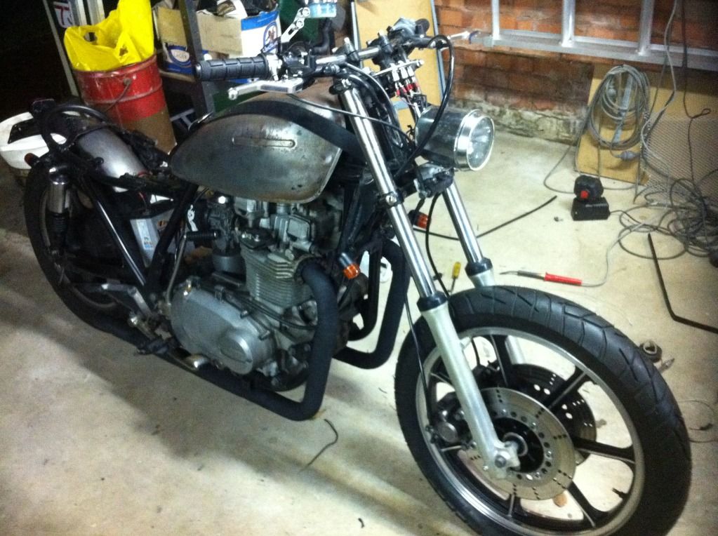

took her out onto the driveway for a quick shoot.....just to show you guys how shes looking...
