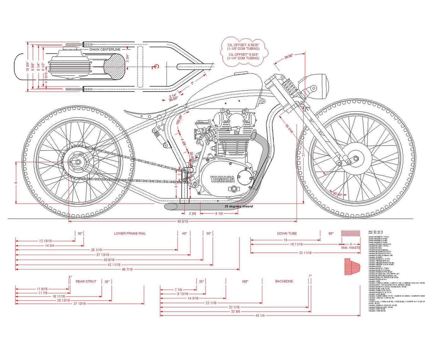

The desire to not tear into my current stock engine led me to buy a complete XS650 for $150, specifically for the engine.  This got me to thinking... hey.... I've got a whole 'nother bike here and I've always wanted a bobber.  Maybe I'll hard tail the new XS frame and slap my old engine in it.
Some further reading into hard tailing and a few phone calls to the Ministry of Transportation Ontario along with my insurance broker convinced me that hard tailing a frame is not for me.  But... then I met David from Voodoo Vintage who makes some wicked frames for the XS650.  Calls to the MTO and my insurance broker confirmed I can register and insure a full custom frame NO PROBLEM :) and David's frames are a small incremental cost vs buying a hard tail kit and having it professionally welded.  For an extra $400 you're into a full custom frame done on a jig and fully legal vs. a hard tail kit and questionable legality, at least here in Ontario.
Push come to shove.... I've dropped the hammer on an MK4 XS650 frame from Voodoo Vintage.

BTW - the drawing is Voodoo Vintage's mockup of what the bike could look like on the frame.  I'm likely doing a very small tank, either sitting up proud on the back bone or low and sleek following the curve of the spine, simple seat on springs, stock XS front forks, battery just sitting there out in the open.  Form will follow function on this build, no fancy paint or powdercoat.  Might even let the engine keep leaking oil ;)

This is the latest mockup from David with wheels closer to scale.
Last night up at Paul's shop we pulled the engine out of the donor XS and tore it down.  More pics later of the engine in bits, but it's COMPLETELY disassembled.  Down to the last nut and bolt.  Engine cases going for soda blasting hopefully this week.
