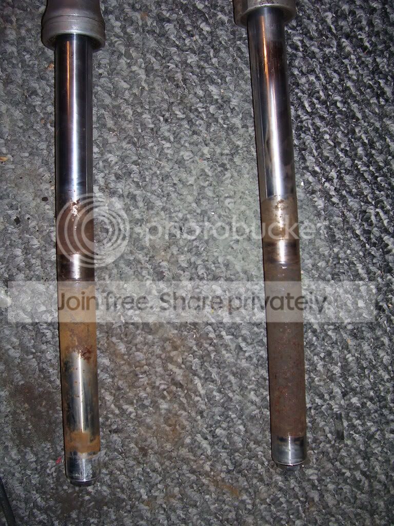

The fork tubes are in really rough shape, hopefully I can clean them up, otherwise I will be robbing parts from my uncle.

I think your fork tubes are bent though... Might want to go rob that uncle now. :D
I checked the tubes and I think they are ok. Must be some kind of illusion with the camera because they look bent in the picture but not in reality. I will clean them up a bit and put a straight edge to them to make sure.

Nice project. The fork tubes aren't chromed above the bottom tree so the rust is normal. You can sand it down and just paint it black.
