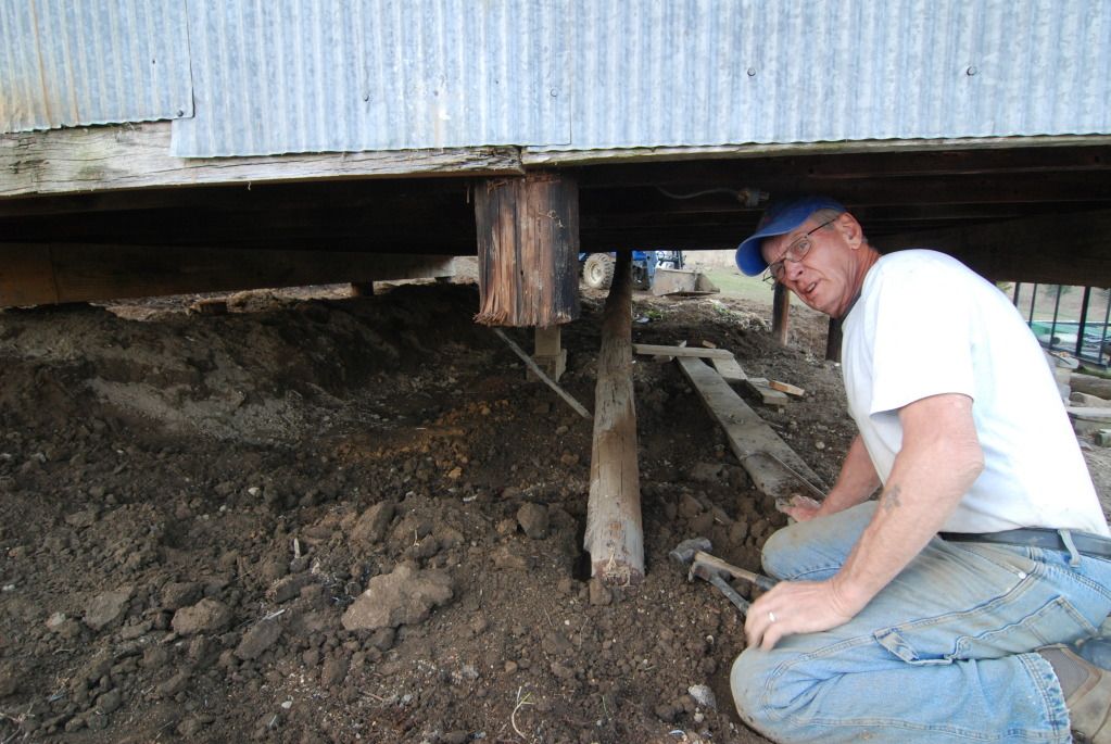

jacks were put in place to remove some of the weight off th post so they could be cut. Luckly a couple post could be cut from outside

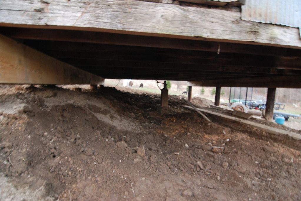

Today we cut and removed 4 posts down the center. Also cut another 4 across the back side. We simply set the building back on the post stubs (hopefully they won't be like that very long). Now there's room under the building for the trailer
A Telephone pole was used as the header down the middle (A small round pole on it's side is not strong so its now gone). It gets replaced by 2- 2x10x20' screwed together.
Building's center is open and ready for the trailer. All the post have been cut except the 4 on the front. We will crib and block it in order to set it down on the trailer. This is how it sits this evening
