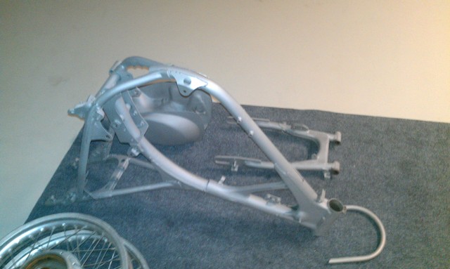

Had the frame and swing arm media blasted and painted it all in a stainless steel appliance epoxy.

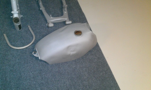

Tank was all messed up....

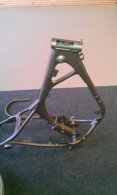

Frame color is hard to see from the pics. Kinda like your stainless steel appliances. It does have a slight goldish hue, not what I intended but kinda like it now. Reminds me of bad varnish.
Before and after pics

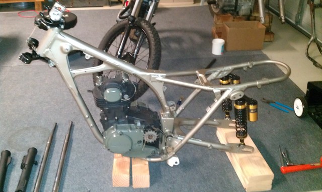

Things are starting to come together. I had anew pair of shocks I was going to use on another build but never ended up using so they went on this one.
Painted the front forks in the same black as what is on the engine. I am just waiting for the new fork seals to arrive and then they will be on. I had to get another set off of Ebay because the previous owner(s) really marred one of the lowers (probably trying to get the seal out) and the uppers were pitted really bad.
Was able to get the engine in. Still need to completly bolt it down and i also have one bolt giving me a hard time on one of the rear shocks. :mad:
I painted the tank a burnt copper and that is going to change. Going to sand it off and paint it in a chocolate brown. Just ended up not liking the color of the tank with the frame.
I have posted a "before" pic just so you could get a refresher of what a craphole this thing looked like.
