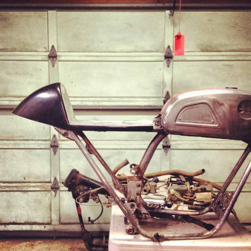

Got a seat built over at Glass From The Past. The fiarings aren't for me, thought it looked sweet though.
Got the seat fitted on the frame after cutting off the rear loop and grinding down some old welds.
