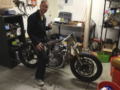

I did the USD modern fork swap several years ago.......very easy to do.....just swap the stems.
This bike is a 1969 CB350 with 1998 GSXR750 inverted forks.
During mock up:
How hard was it to use a modern rear wheel and disc break in the original swing arm? I'm assuming some fab work is called for? I took my swing arm (cl350) to a mates the other day to offer it up to a wheel (from and SV650) he wants to sell me and It looks like it might fit but with about a gnats cock on either side. Any input? I've been perving on Ohiocaferacers.com for a wile and I'm amazed by the 350 project but need a bit of help getting my head around the rear end. Any advice of help would be great.
