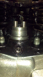

Sadly I just had to pull the cylinders back off the tappet blocks were slightly out of alignment and throwing off the pushrod tubes so they will need to come out and be realigned and drifted back in. Not sure how I missed that before getting the rings into the cylinders but such is life. Hopefully by this weekend I can have it corrected and the motor put back together and ready to sit in the frame.. hopefully.
Hard to see in the pic but the block is raised just a bit up front and flush in the back creating an angle on the tubes not by much but enough to cause a problem.

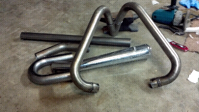

Snazzy new amals, I know I know the whole debate about stacks and how they should be track use only (I have some on order from steadfast with screens but they aren't too much bigger than these palstic jobs that come from amal) It's not a daily rider and the intent is to a`have a street legal bike that is a blast to ride on track days.. I know the risks im taking them and will deal with the consequences.
And with side panel and oil tank , and seat cowl (seat is a work in progress to get the fit just right..)
And with muffler zip tied to the frame, it will have to kick out away from the bike more that was just for the sake of mocking it up, it'd prob boil my oil as close as it is in the mock up you get the idea though.
