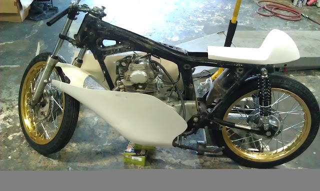

front wheel laced

got the shocks in and they bolt up and fit properly, stoked on how they feel on there too, was worried they where going to be a little too stiff.. also got the wheels trued up

started doing the fairing mounts today, i always forget how much of a pain in the ass it is to set up a fairing on something that never came with one

booby, if you don't mind what size are your FT & RR rims? I'm doing a DT250 conversion right now. I like narrow tires, 18" dia. but wondering about the width?

sure, no prob. the front rear are matching 18"x 2.15 wide rims with true 2.75inch tires on them, this bike originally had a 19'' front on it so i just used the spoke length from cb350 and a cb350 hub for a bigger brake
