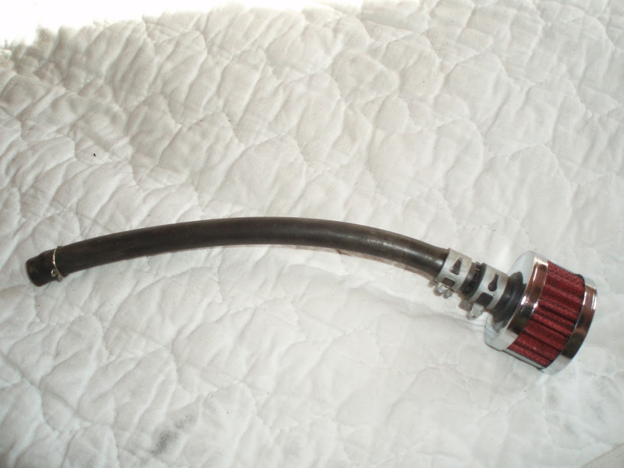

Update on project;
Picked aluminum diamond plate for electrical panel
Breather filter
gas tank seal

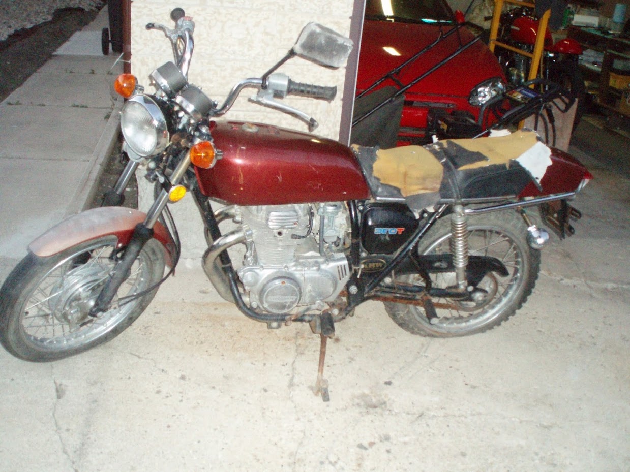

$100      1977 CB 360T

Alright...  Spare parts galore...  You gonna disassemble and catalog and box the new one for parts or make it a driver?

That's a CJ360 not a CB
Damn good deal though.

3DogNate,
Spare parts; was initial idea. Engine is seized; bike was exposed to elements (Canadian) for couple of years.
Injected WD-40 and brake fluid mix in cylinders last night. In left cylinder fluid is gone, right one holds. Will see if engine is fine it might be a driver. I like front drum brake and no starter.

PJ, yes bike is CJ not a CB my bad and will check that regulator case is not touching ground.

I need to get a breather tube replacement as my bike is without one right now. where did you get that filter thing is that needed?>
