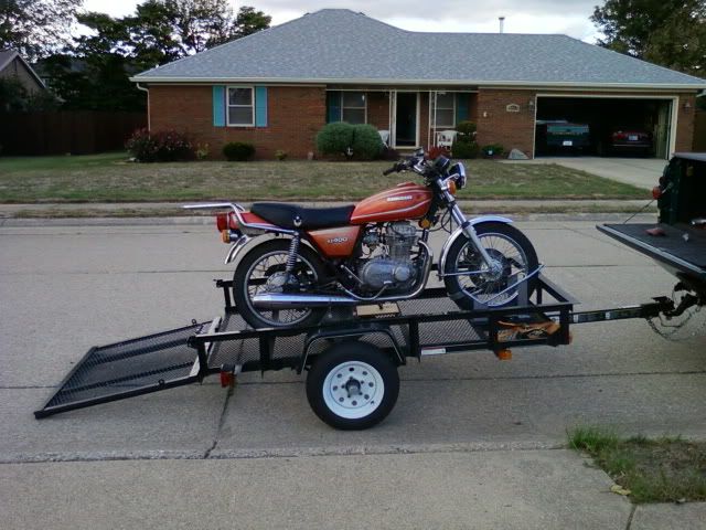

OK, here goes. This was given, yep, that's right - given to me last Sept. by a buddy for helping him move back to town. He bought it in VT and used it to learn how to ride street. I felt so guilty for accepting this offer that I gave him a barely used flyrod! I dig the kick start.
So, I began tear down over the winter. Engine was crusty, but ran two years prior. 21k on the clock, lots of leakage from the bottom end. Exhaust was toast with rust holes in both cans though the head pipes look good.
