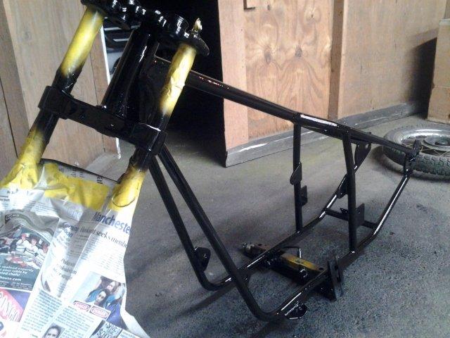

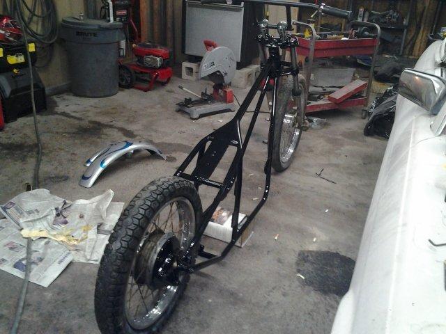

Been awhile since I posted on here! Been tinkering around a bit with my other two builds, which I have come to accept will be the longest builds ever. Here's another one that I'm HOPING won't drag on as long as the others.
Been itching to build a chopper, so I bought a bike and got started.
1981 Yamaha XS400 Special. ~5,000 miles. Bone stock.
Started out as a simple bob, shortening up the rear, installing drag bars, cherry bomb mufflers and turnout tips and cutting some weight.
Winter came, and I got bored of the bob, so I moved on to starting the chop. Plenty of beer, a couple cutting discs and some welds later...
Stripped down:
Engine out:
Parts:
AAAHHH!!!

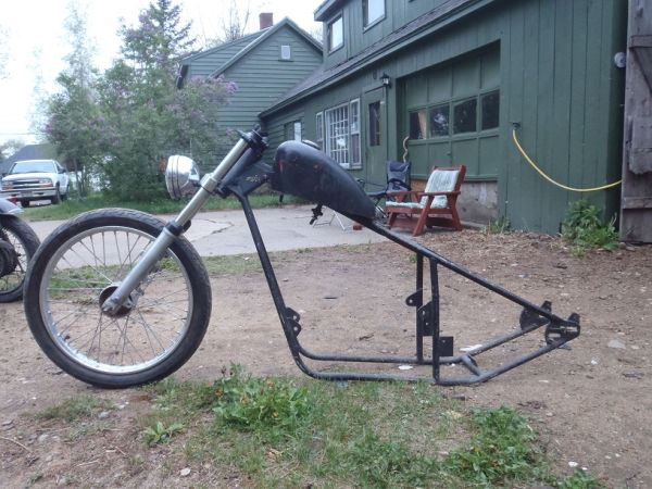

And this is where it's at right now:
Hoping to wrap this up in the next couple weeks. Let me know what you guys think!!

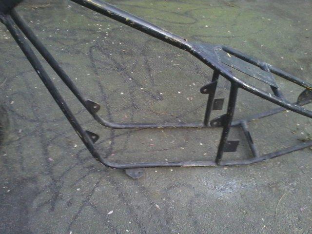

Thanks! I do plan on putting in some mini-gussets where the tail tubes meet the stock frame. There were some slight gaps on the bottom. No slugs - butt-fit, so there was a lot of steel squirting to join the two. Already got a few crossbars in at the top for the tank mount, seat mount, and fake oil-bag mount.

I too agree that it needs a bit of support, and if I may, have an idea for the lower brace. Cap the whole where the old supframe connected, from there run a brace down to the new, should be plenty strong.

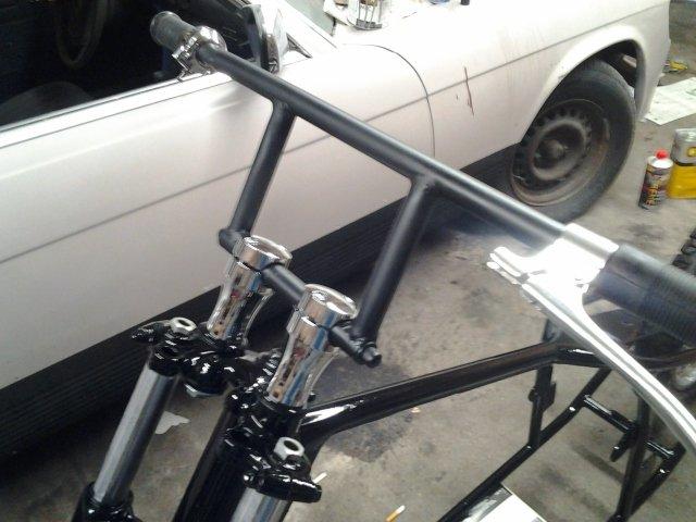

I also ordered a clutch lever, brake lever, throttle pull, grips and 33mm clip-ons. Low and tough. Now that I have my final height for controls, I need to order a new clutch cable and throttle cable, and the controls are finished.

Where I have drawn a line is an obvious point of stress or maybe collapse to my eye.It is necessary to weld some kind of support there.,,,,
It IS a safety issue....
I don't agree.
Putting bracing in that area is shortening the lower frame rail and concentrating the stresses at the new join area.
Have a look at this:
By all means you want lateral bracing between the rails on each side, but the longer you have the rails the more flex and "suspension" you have in the rear end. Hardtails are actually supposed to flex to absorb road bumps and be rideable. Where you have connected the bottom rails is fine.
Another thing - if you do gusset the joins, make sure you weld the gussets to the outer of the frame tubing, not at the centre radius because this puts stresses on the tubing as it flexes and will cause fractures over time.
