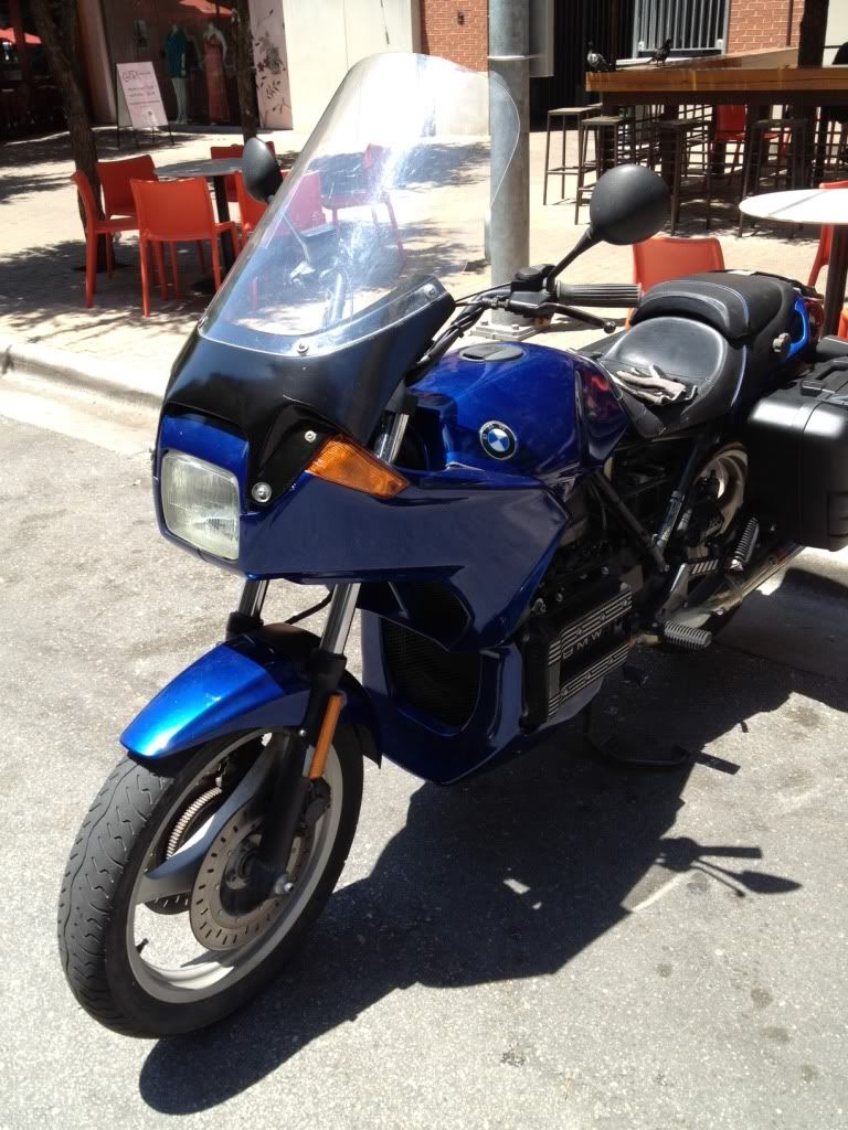

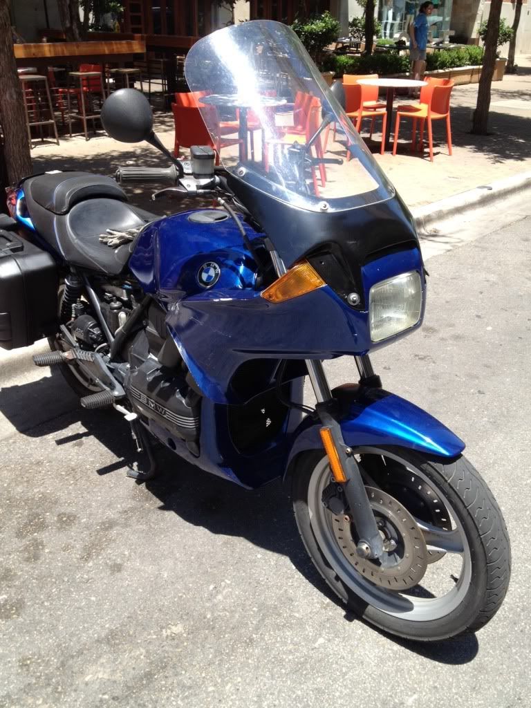

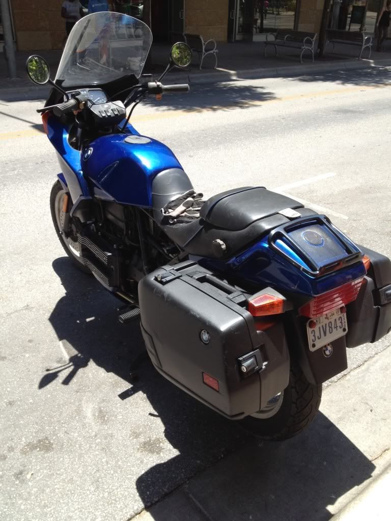

As it is today. I LOVE THIS BIKE. It is so smooth and powerful. Feels pretty nimble for a 500lb bike too.
I have gone through and done nearly every tune up/maintenance need on the bike. Trying to keep a solid record of everything too. I just have a couple more to do.

Cosmetically I have mainly been cleaning things up and done a little bit of painting. The sidebags were trashed from the bike being dropped on them multiple times. I repaired them with some epoxy and sanded and painted them with some Duplicolor Truck Bed liner.
Also painted the coil cover, alternator cover, rear fender and inner fender, and the lower windshield (the black section)
Slowly, but surely it is cleaning up.
I plan to get it back to tiptop running condition and take it for some nice long rides. Austin to Denver this fall for a backpacking/hunting trip is on the books already ;D
Here is what it looks like now
