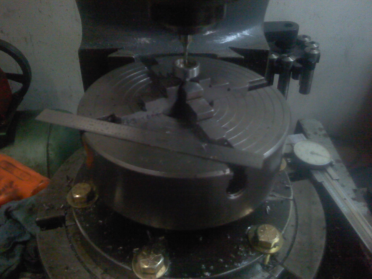

« Reply #17 on: Sep 16, 2012, 23:17:25 »
I haven't had much time to work on the crank lately.
But it's a little lighter now,down from 15lbs. 5.2oz. to 11lbs. 8oz.
Still have a little polishing to do on the crank and the rods are next.
After that off to be shot peened etc..
Also the forged pistons are matched and only 2 grams heavier the stock.
Offline Nebr_Rex
  • Posts: 877
Re: Dr. Jekyll and Mr. Hyde ( a pair of KZ400s)
« Reply #18 on: Oct 08, 2012, 03:00:05 »
Here is pic what's been done to crank.
And a pic of the carbs I'm taking off.
And what I'm putting back on.
