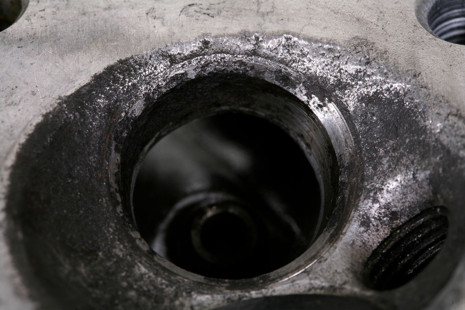

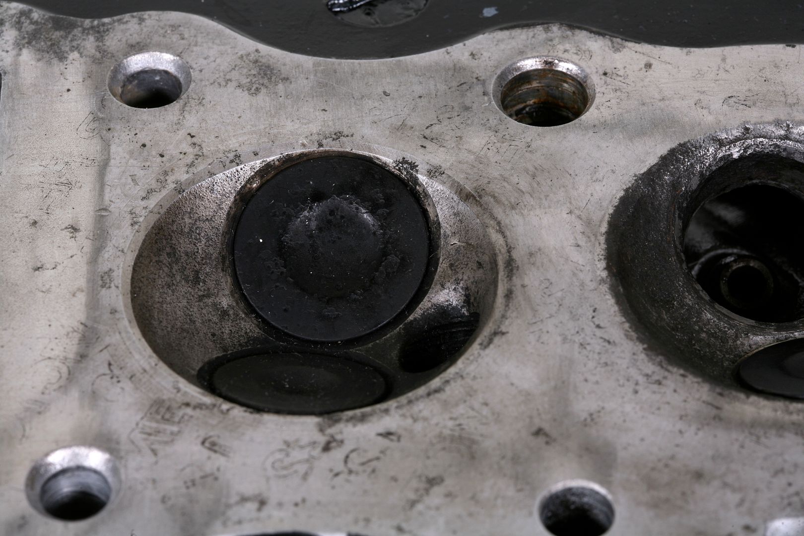

Well, last night I did a series of compression tests with the engine cold, wide open throttle (WOT), cold with a bit of oil squirted into the cylinders and WOT and after I ran the bike around for awhile. Cylinders 1,2,3 were consistently in the 130's psi on all tests with my cheapie compression gauge. Cylinder #4 was 75 psi cold, 85 with oil added and 80 psi after running, telling me there was a leak in the valves, not the rings or cylinder on #4. I checked the torque on the cylinder head and all bolts were tight and to spec. There are no air leaks around the cylinder head or gasket area. So, off with her head-I ripped her down to lower end last night. I knew the chamber of cylinder #4 had some pitting and corrosion which came with the bike. I did lightly lap the valves with rough and fine compounds when I rebuilt the motor.
#4 on the right, note the pitting.
What I discovered was some of the pitting and corrosion was also in the inlet valve seat of #4, allowing for a slight leak, causing the low compression reading. In a dark room, I shined a strong flashlight into the inlet and exhaust ports and discovered two tiny light leaks on the inlet valve seat, the culprit of my compression leak. If I did it right the first time, I would not be doing this now.

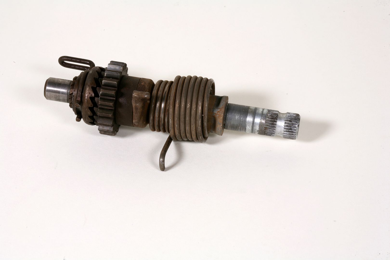

As long as I am at it, I am replacing the kick start quadrant with a slightly used one with better splines than my original.
