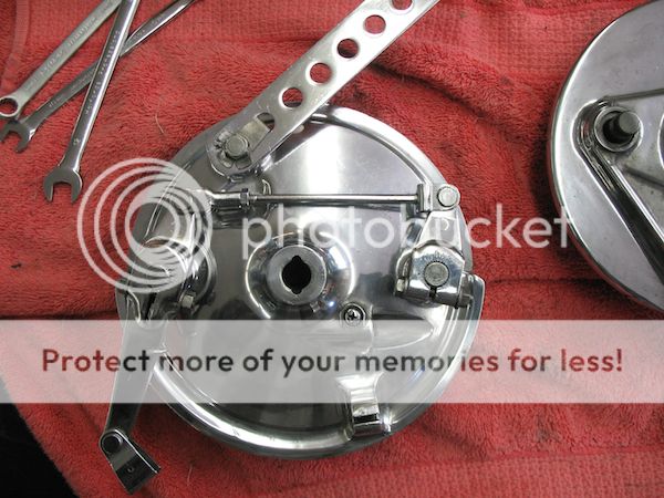

After that, I rode it for a week or so. Clutch cable was pretty gnarly and ready to snap so I did replace that pretty quickly.
Made myself a coffee, grabbed some tools and sat my arse on the concrete.
When I opened the case, I honestly believe I was the first in decades to be in there. There were sticks, leaves, mud, trolls you name it in there! Didn't capture the initial opening but you can see some of the shyte left behind in the bottom of the case there.
Easy job and got it all done and cleaned/adjusted in about 45 minutes. Changed the bike big time! I was stoked!

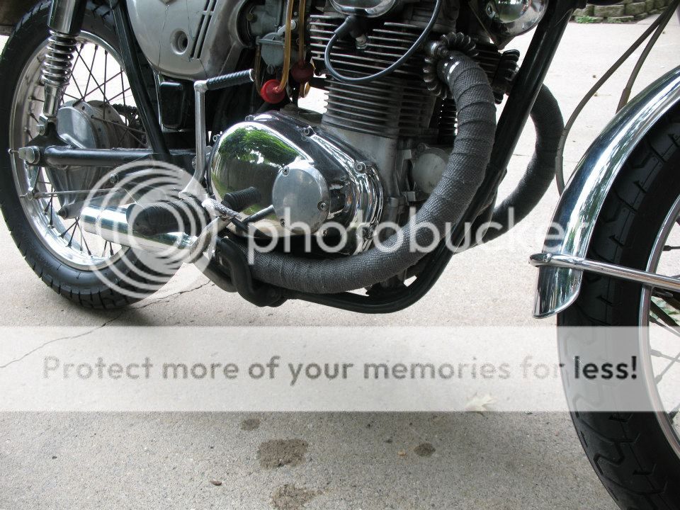

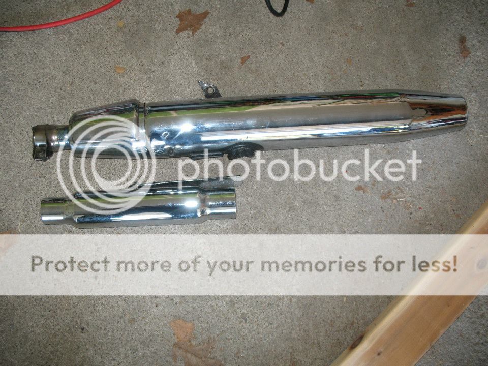

Swapped out the giant aftermarket pipes that came with the bike (Big Berthas as I'd dubbed them) for some 12" Shorty's. Holy, what a difference. I love the sound of these pipes. I take it easy in my neighbourhood as to not tick anyone off but the Harleys in the area are still far louder.
While I was at it, I took the time to wrap the pipes as well.

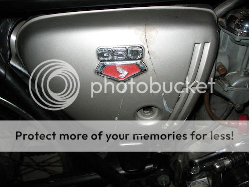

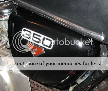

Old side covers were toast.

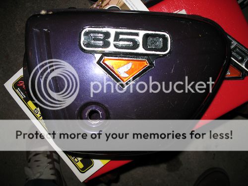

The new(er) side covers were rough but a little better.
So............started prepping for paint.
Stripping and masking.
After stripping and a few coats; more masking.
Then a couple coats of white.
Scrape and sharpen raised edges and VOILA!

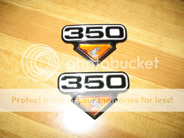

Out with the old, in with the new. Black!

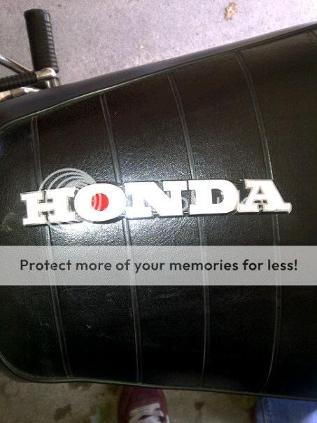

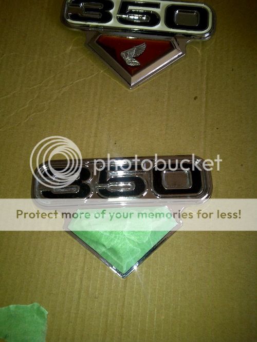

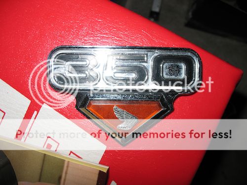

A little detail for the Japanese bike :)  Tank badges....

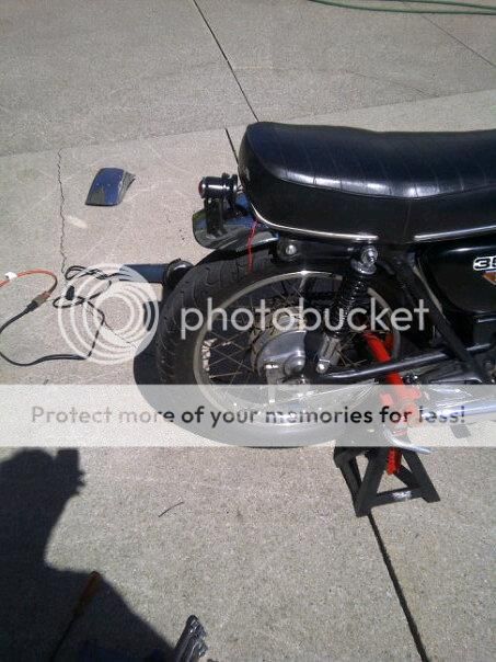

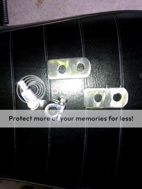

Fabbed up some new indicator light mounts for the rear (new lights after powder coating) and refurbished a shift linkage (found at salvage yard) as mine was causing me some grief.

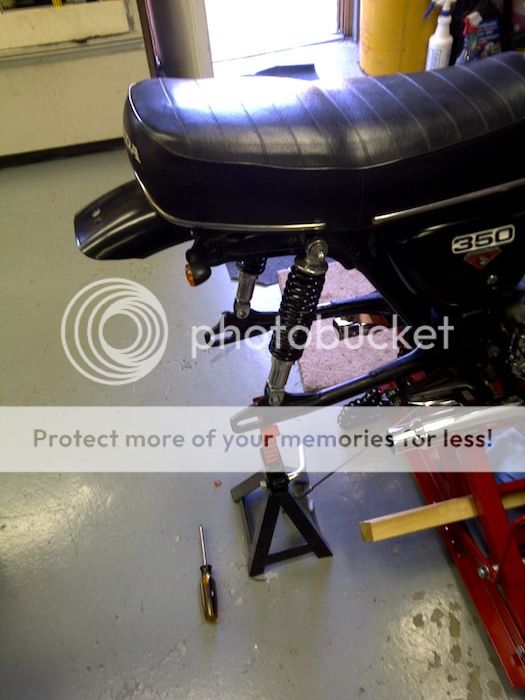

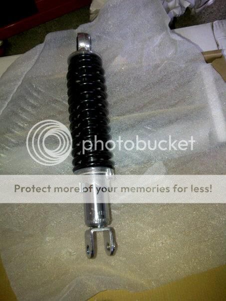

Then, on the very same day, my new rear shocks arrived.
Slapped those on and lowered the rear of the bike a hair.
Ground off the front fender (leaving just the arch for powder coat) and got into bobbing the rear fender.

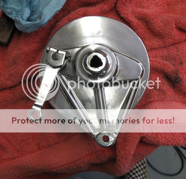

Then, while I waited for powder coated parts to return, I got to some polishing.
Before.......
After.........You know it's done when you can see my flannel jacket in the reflection :)
Before.......
After........

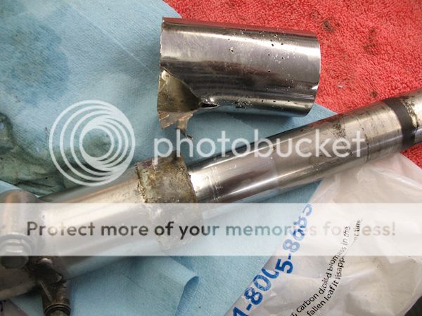

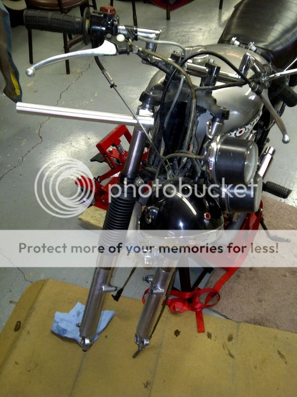

Once that was done, I started into the forks. Couldn't believe my eyes when I poured out the oil: milk white!! Yikes........
Internals and upper legs turned out to be quite nice after some cleaning/buffing though (thankfully) and I replaced the seals without issue. Well........ALMOST no issue.
I spent hours (literally) trying to free the left leg's chromed upper "crown" but there was no way. Had absolutely no choice but to hack the shit out of it to get it off.  ::)  I cleaned it up and straightened it enough temporarily so it's usable. I'll head to the salvage yard in a week or so and pick up a new one. It was going flawlessly until that point.
It started off very gentle with light twisting. Then a little more force. Then a slight bit of extra force with some lock jaws. Nervous about damage, I aborted that. I then poured the penetrating oil to it with some more attempts. Then some soaking and more attempts. Then I was back to the lock jaws with some soaking and more attempts - loads of force. Heat? Sure. A dab of heat. A dab of heat and oil and coaxing. OK Oil gentle tapping. A little more tapping. OK, a little heat, oil and tapping.........
Ah F#$% it!
BANG! BANG! BANG! BANG! BANG!!
There you go B#%&H!!
aaaaaand done.

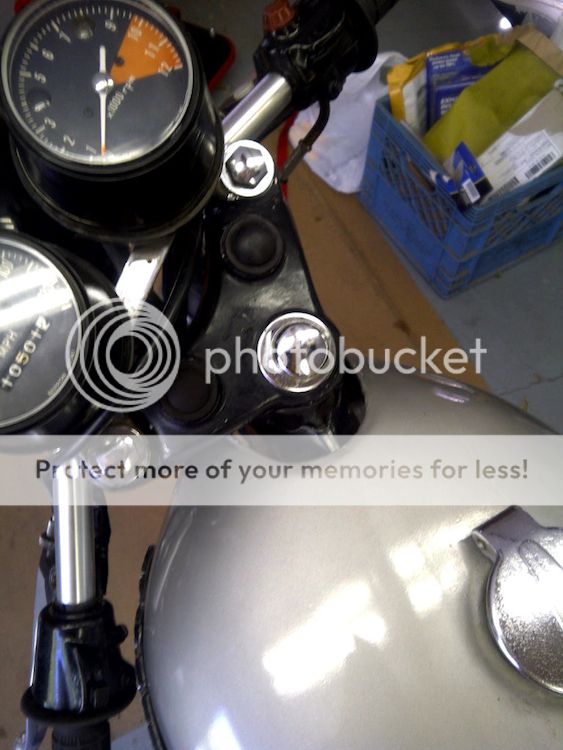

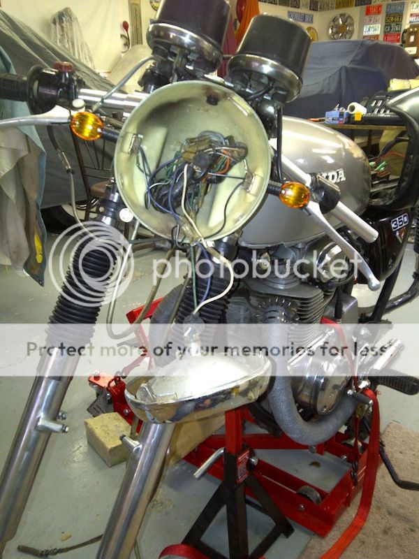

Mounted the new clip-ons and moved the controls down.
Re-wired the new lights, and manage to get everything running (using original stuff) right down to the neutral indicator and high-bean indicator lights. Everything works. Sweet!
Went back later in the day and cleaned up the wiring the best I could and finalized the bar and control positions (pic below). Doesn't look too bad, for now really. When the full mockup is complete and I have everything in order, I'll be tearing the entire bike down and redoing the whole wiring harness so........ Like I said, good enough for now.
Now that I see the gauges up there though, the look MASSIVE. I will no doubt be swapping them out at some point as well.

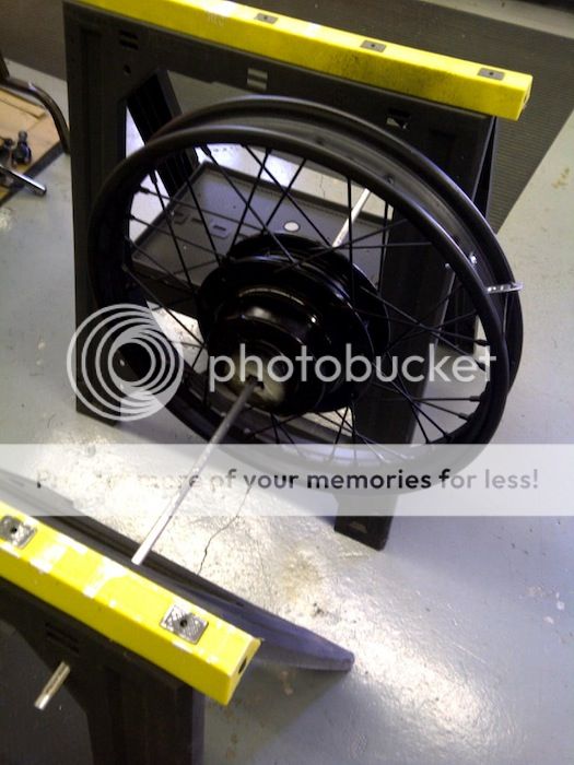

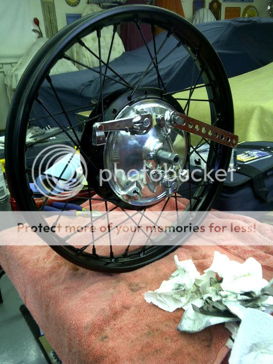

At the same time, I started the work on the wheels.
After a couple of days of prep, paint, sand, paint etc......... Move the plants, dry the wheels.  8)
Unable to resist, slap the polished bits on to visualize what's coming.  ;D

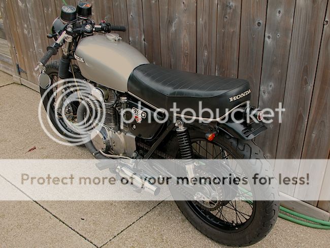

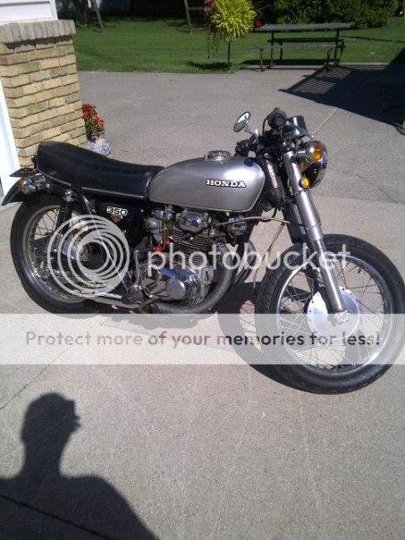

Slap the plate on and headed out for a 1 hour shakedown ride. YEEEHAAAWWWW!!!!  8)
Until.....
Bike runs awesome! Pretty stoked. That fork is so much nicer now that it actually functions as it was meant to and actually had good oil in both legs (as opposed to half water in one and NO oil in the other   :o )
Still loads to do on this build but not right now. I'm gonna run it a while.
