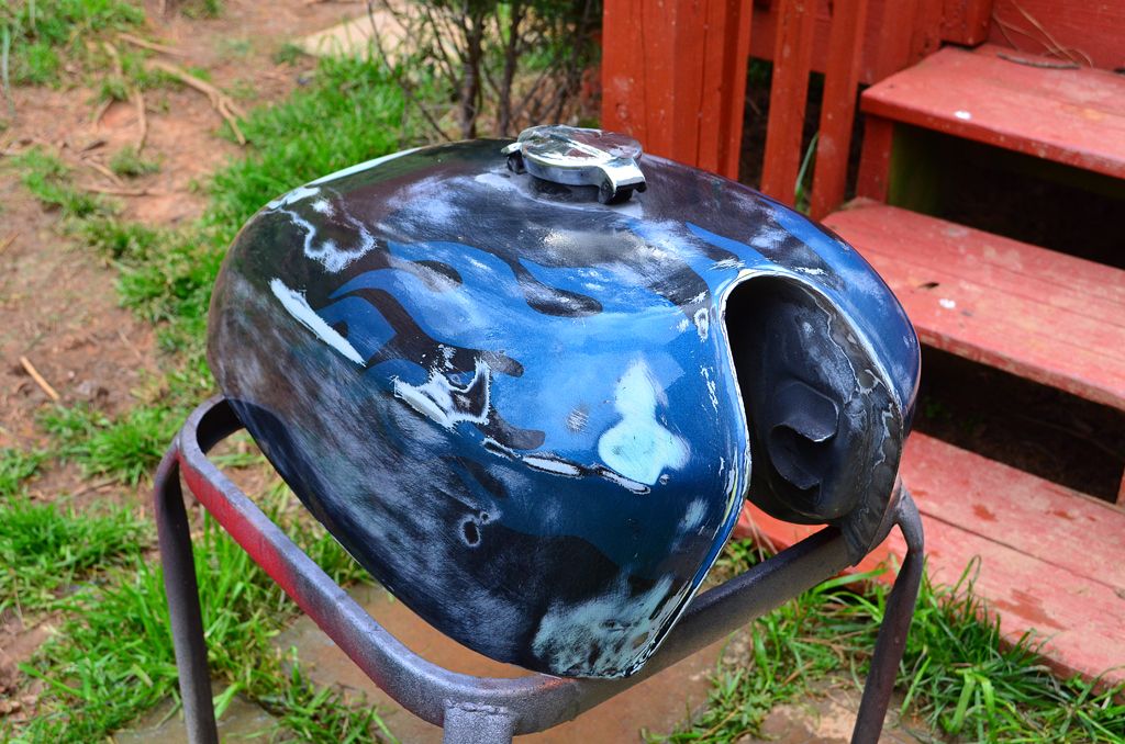

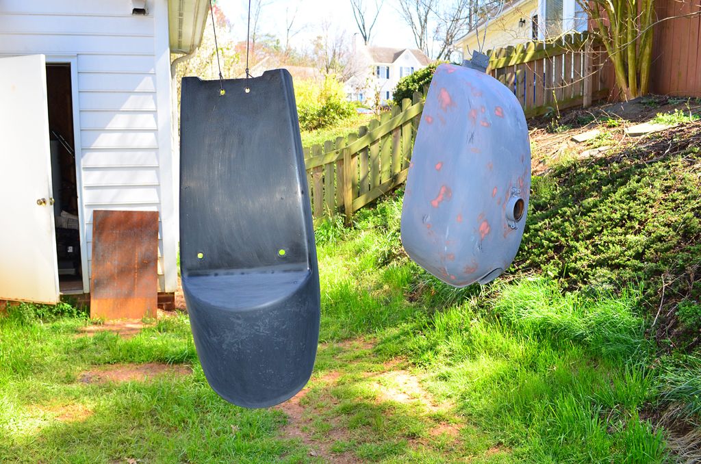

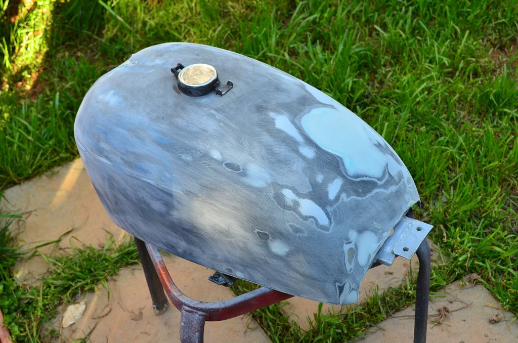

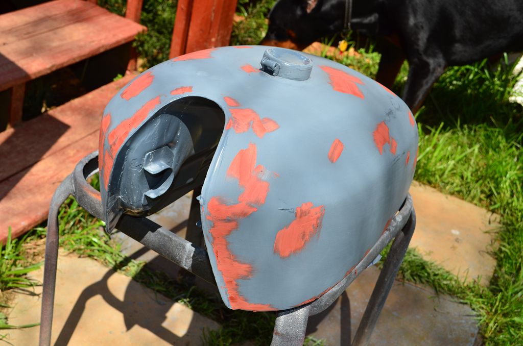

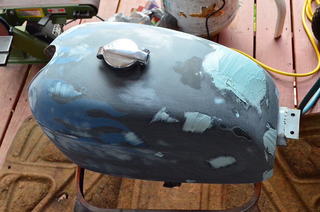

I'm not really happy with the rearsets thus far so I've put that on the backburner...  I hate looking at the bike without paint so I'm taking the plunge finally.
Sanded the spray paint off the tank with 80 grit.  I didn't want to strip it all the way down since the paint under the spray paint was okay besides the terrible chopper flames
Filler
Filler blocked down with 120 grit
Epoxied it
Sanded the epoxy down with 220 and added some glazing putty in areas I didn't think the 2k will build enough
Ready for 2k
2k!
That's where I'm at right now.  I'll be wetsanding then shooting the base for the special paint treatment tomorrow
