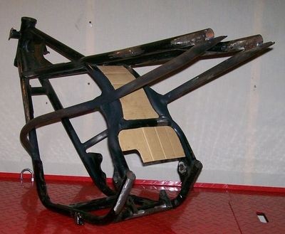

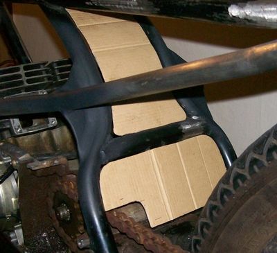

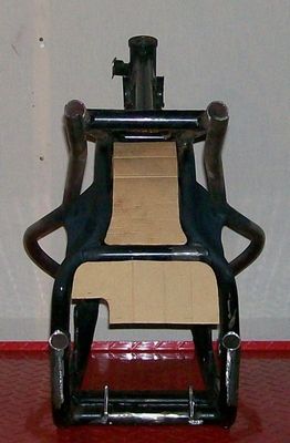

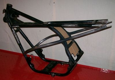

I set the engine back in the frame as well as the swingarm, rear wheel, chain, etc. so that I could check the clearances for the new rear guard that I am building.
We had originally thought about building a one piece guard out of aluminum however I really want to mount the guard just inside the rear down tubes so that it is flush with the back of the rails when looking at the bike from the side, there is a cross bar connecting the two rear down tubes which would prevent me from mounting a one piece guard that way so we decided to build a two piece guard with the cross bar in between them which I think will look even nicer when everything is finished!
I started to play with design ideas and cut some templates out of cardboard so that we could see what the guards would look like. Here are a few photos of the basic design that I think we will be using, these pieces of cardboard are not the exact shape that I will be cutting out of aluminum and the aluminum pieces will sit flush with the back of the frame rails instead of how the cardboard is sitting however I wanted to post these photos to share the basic design with you all!

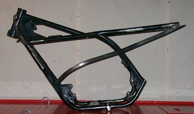

I really like this photo as it shows how you will not be able to see the guards from the side and how uniform the two new frame rails that I built are when looking at the frame from the side!
