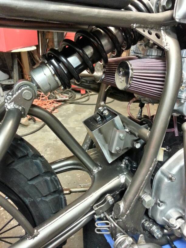

Hey compound, i do have a build thread. My reasoning for the geometry i used is all in it. I'll link when i get home, its hard to do on a phone. Its called "project Gretta". I used a Ducati monster shock body and a 888 spring. Rides really well and its lightweight. Neevo has a great design going as well. Really great build. I'll say again, any help you need man, just hit me up I'll be glad to offer anything i can.

thanks man! i'm very happy to have them done after a long time working on them. and i'm glad kanticoy commented with a pic of his build, i was going to refer you to him. i really like his design, and though i thought it looked like the bottom shock mount looked like it could use some extra beef, the results speak for themselves...he says he rides it every often and has had no problem, so more power to him! it's a beautiful swingarm.
