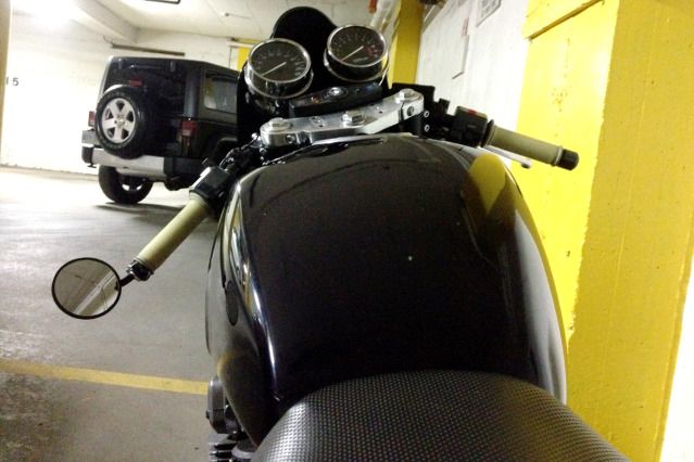

Here's another shot of the clip-ons:
For me, riding it is easy. It's a small bike and I'm 6 feet tall so it doesn't feel like that far of a reach. The bars are 41mm Woodcraft clip-ons with a custom spacer made to bring them down to the 39mm forks. Instead of using the aluminum bars that came with them, I cut up a pair of flat drag bars that had a 15 degree pullback. This makes the bars angle down even slightly lower and also helps them clear the tank. It took a lot of adjustments, but the bars are mounted symmetrically and will turn lock to lock without hitting the tank.
