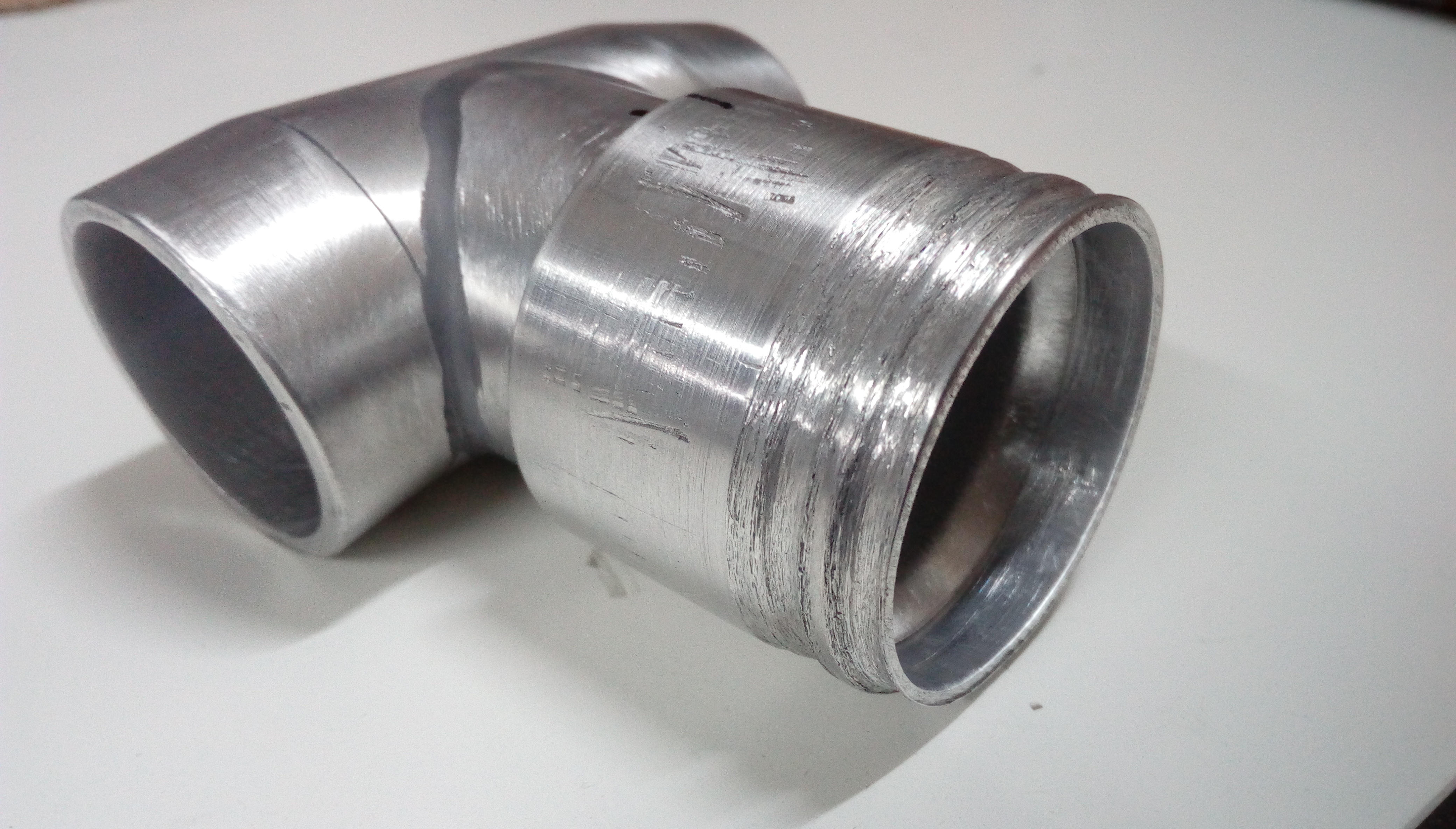

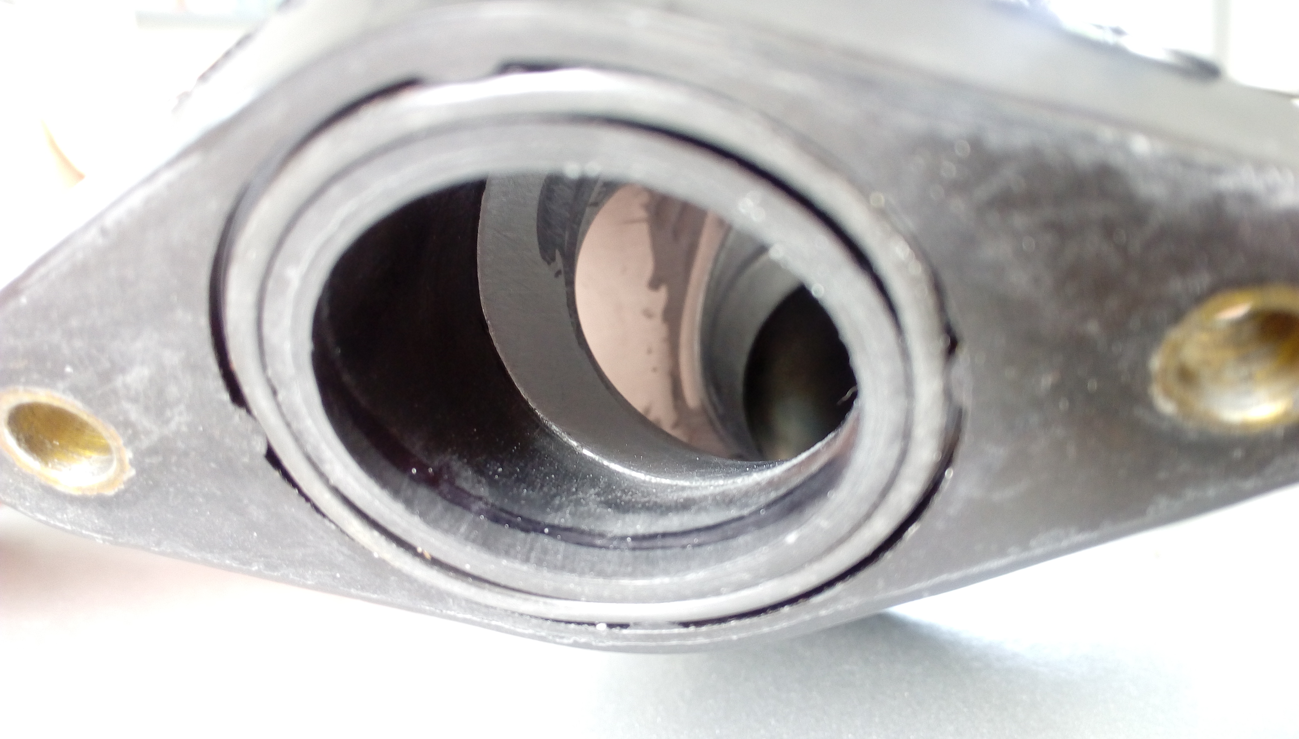

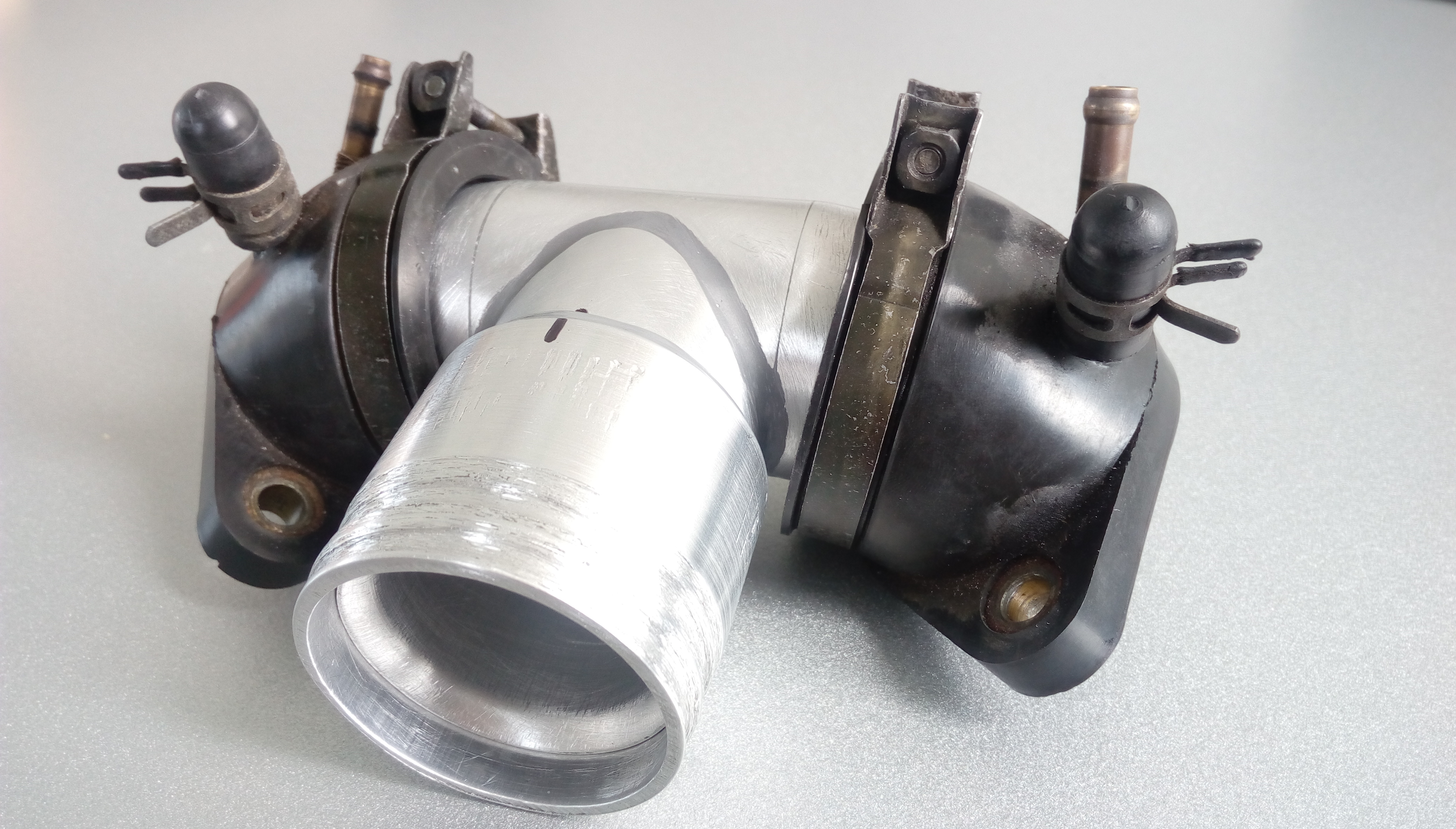

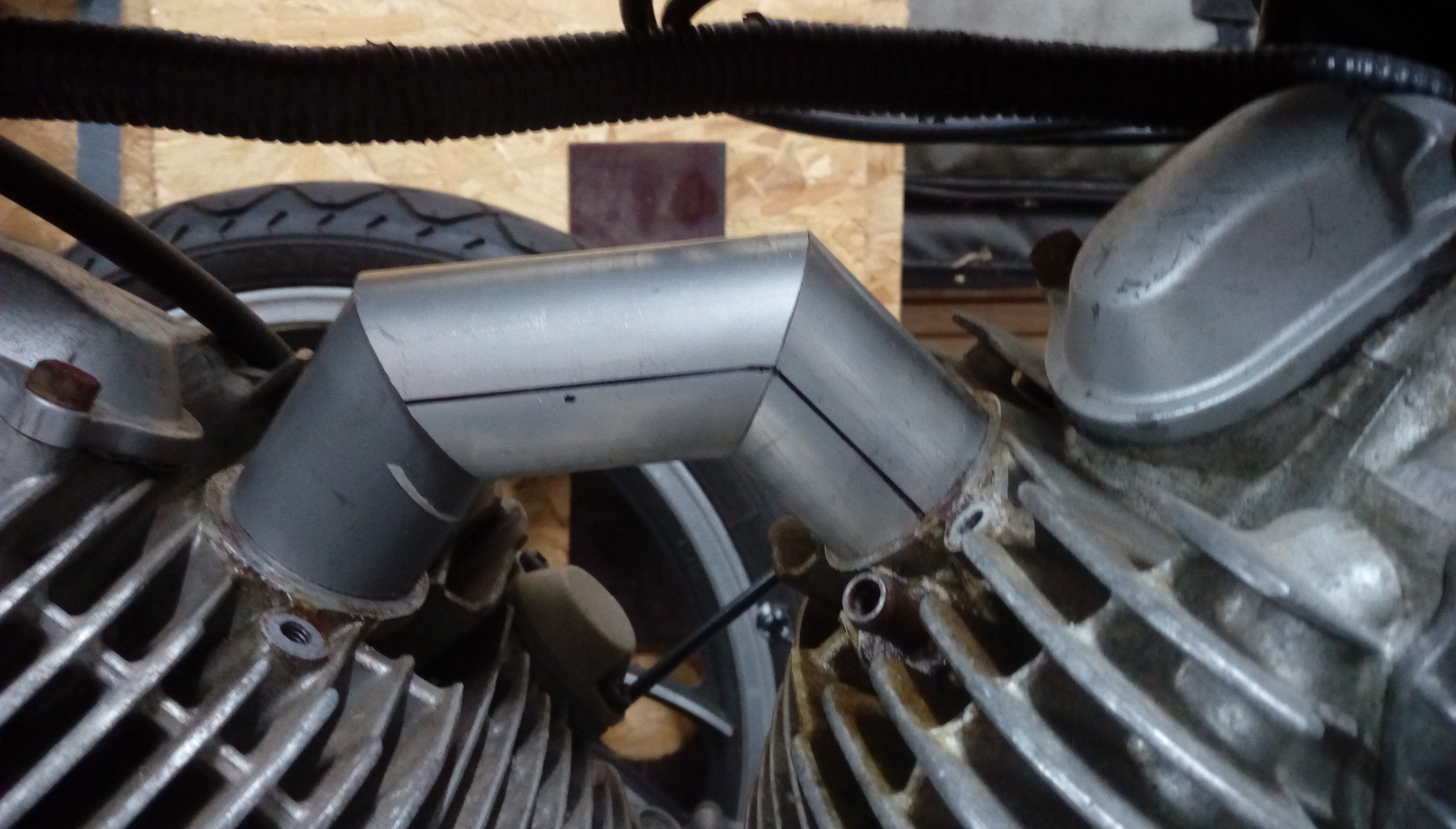

Yep I think the single carb is definitely the way forward, just need to figure out what carb and find out if there are any manifolds out there to covert to single carb, any ideas or advice will be gratefully received.
