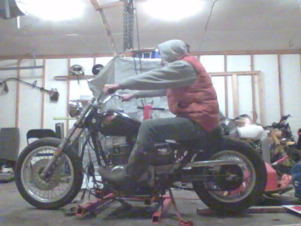

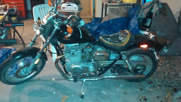

Picked up this 450 Rebel a few weeks ago for 125 bucks. Decided to do a quick build to fund my cl project.
Im going to lower it a few inches and clean it up a bit.

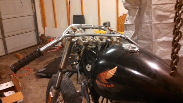

Can't decide if I want to go with more of an agressive/cramped stance or make it comfortable. I like the look of the lower bars...
If i used the lower bars id want something that sits kind of like this...
Any idea if this thing will handle right being lowered like that? I know 250 shocks fit the rears minus 2 inches and a some clip ons would allow me to lower the front forks by 2 inches.
Some parts for sale if anyone needs 450/250 parts.
Thoughts?? I am open to other bar options...

I say throw some window bars on that thing, lane splitting goodness.
“The only reason for time is so that everything doesn't happen at once.”
Offline gijoe13844
  • Posts: 536
    • Cafecustoms
Re: 86 Honda Rebel 450 Bob
« Reply #2 on: Jan 06, 2013, 00:54:51 »
I like those a lot...is there a different name for them???...ebay doesnt seem to like that description haha...
nvm i found them
