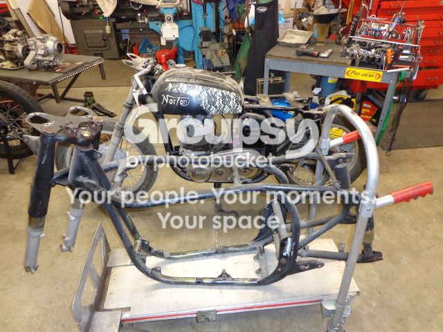

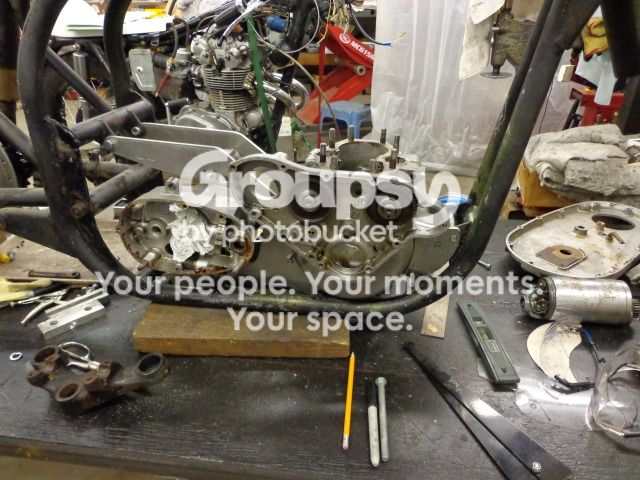

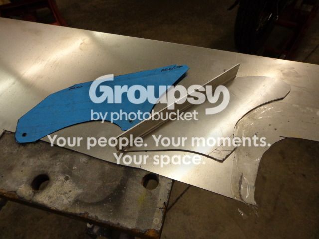

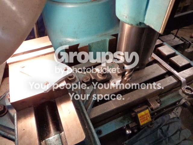

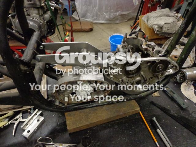

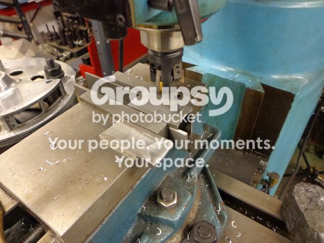

the w2 kawasaki engine in the slim line was sidelined as i need to build/buy a frame jig to widen the frame so i decided to slip in one of the two pre unit triumph engines.....
after making up templates and a dozen on/offs i have the 1/4" aluminum plates almost done..

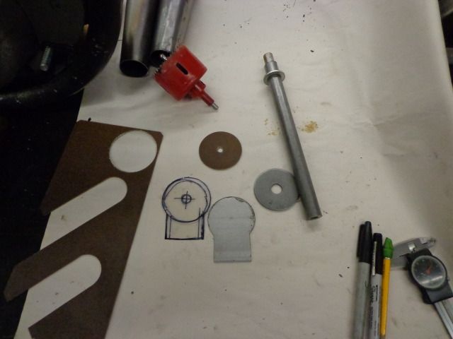

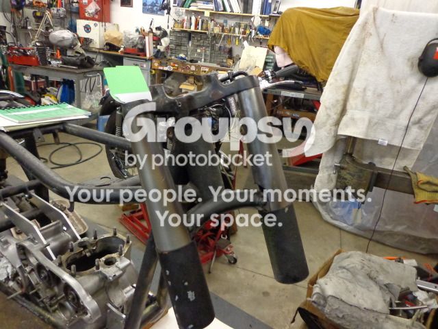

upper fork covers without headlight ears.....since i am going to make a half round tube set up like i did for the blue ducati
Last Edit: Jan 06, 2013, 14:04:30 by joea

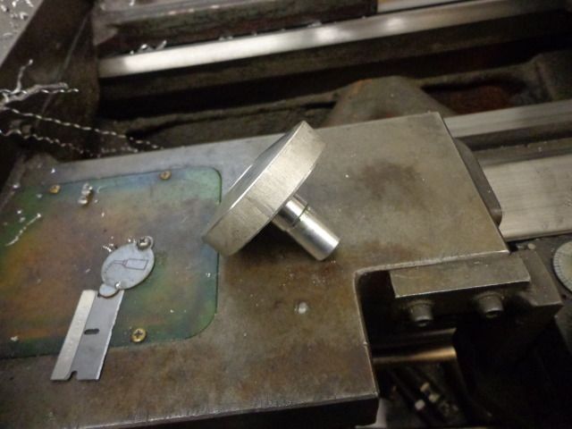

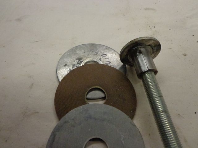

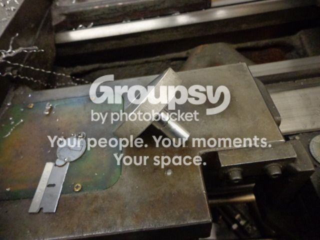

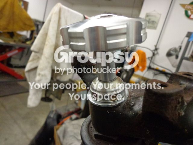

Friction type steering damper assembly.
aluminum knob made from two sections then pressed together,then threaded 3/8x24. lower nut had two slots milled to fit into lower triple clamp which was welded and machined for it to slide in and out, also threaded 3/8x24.friction disc cut from micarta sheet. upper/lower pressure plates, one made from 2024 t3 aluminum and the lower steel.
Last Edit: Jan 06, 2013, 21:58:56 by joea

finished up steering damper, all steel parts need plated yet....
Last Edit: Jan 07, 2013, 18:03:56 by joea

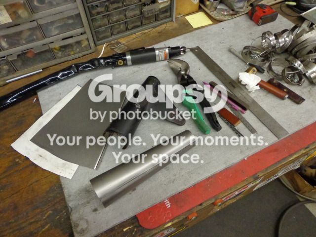

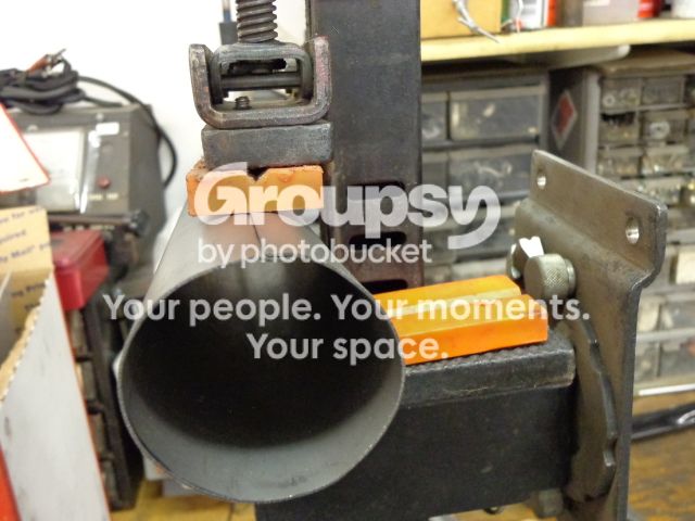

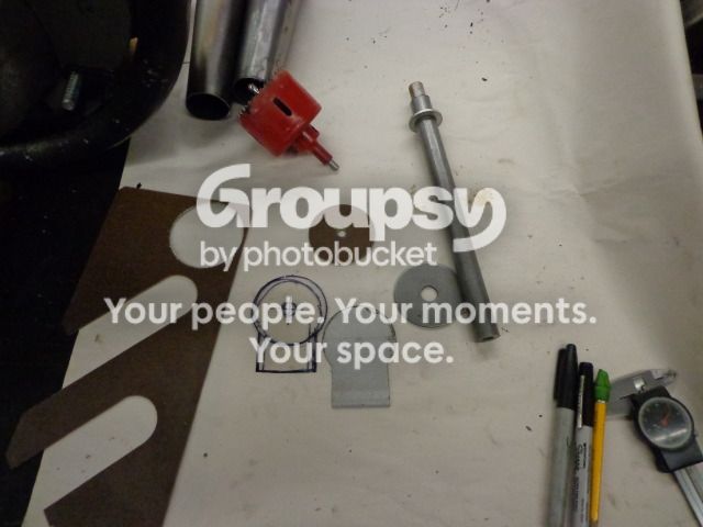

mount
tools made for dies for the tube type headlight mount assembly. i still need to fabricate several other parts for the mount.

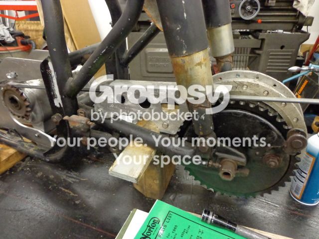

aluminum chain guard...still covered with clear vinyl to protect finish.
Last Edit: Jan 19, 2013, 01:58:29 by joea
