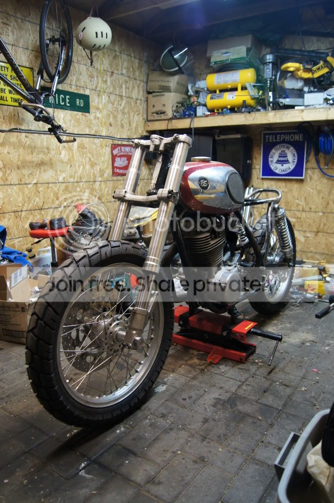

Good to know.  Honda and Yamaha front disc hubs also have the same PCD (80mm) and 60mm bore as many front rotors.  I have FZR1000 rotors bolted onto a Honda CB front hub, with bearings for a 20mm axle and a custom axle/spacer to put it in a GSXR set of forks, mounted to my SR500 frame.  Real mongrel.
