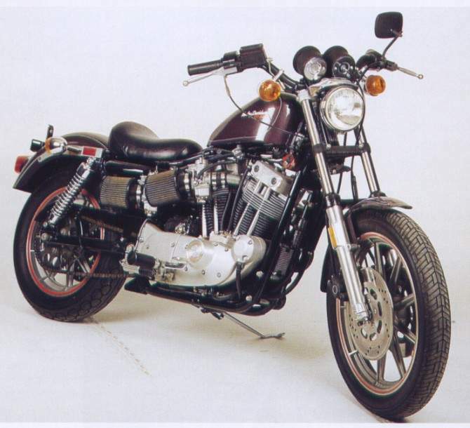

What HD engine is the one the resembles the XR's engine the most?
The XR1000 was the closest thing to a street version of the XR750 and probably the fastest air-cooled production Harley ever built. Unfortunately they are very rare, even more than the XLCR.
