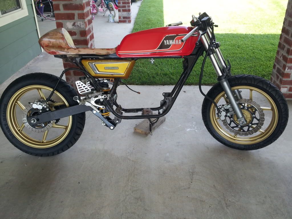

I haven't done a whole lot in the last couple of weeks but I figured that I'd post some info to show what's going on.
I made a bracket for the rear brake reservoir from the leftover tubular:
I finally got around to making the rear tank mounts for the RD400 tank:
I got the crank back from Lyn and it came back looking great, really like new. I need to take some pics of that.
I got a nice box of 6-speed from Brad and the gasket and seal kit to put the engine back together. I just need to finish cleaning the cases for that to happen
and somehow I need it to stop raining for longer than two days to make more progress on this project:
I was really trying to get this together for Barber but I think that may be pushing it. I am going to just take it one step at a time so that everything stays legit and I don't rush through anything.

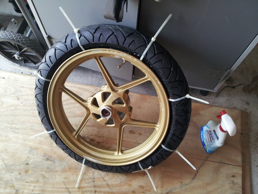

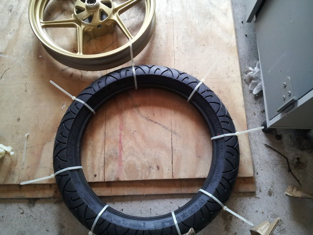

Making some progress here. I got my wheel back from the powder coater after some brake fluid ruined it for me. Darren at Cajun Powder Coating re-did the wheel at half price even though it was all my fault. He also blasted a 1970 CT70 frame for me for nothing. Good dude. Anyway, I thought that I would try out one of those youtube shortcuts on the tire installations and it went okay:
About 2 minutes later:

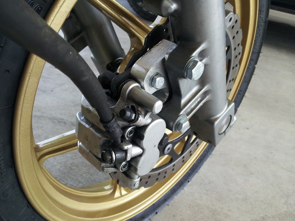

I took my hacksaw and file and made a front brake caliper adapter. I still need to smooth it out but looks good so far.

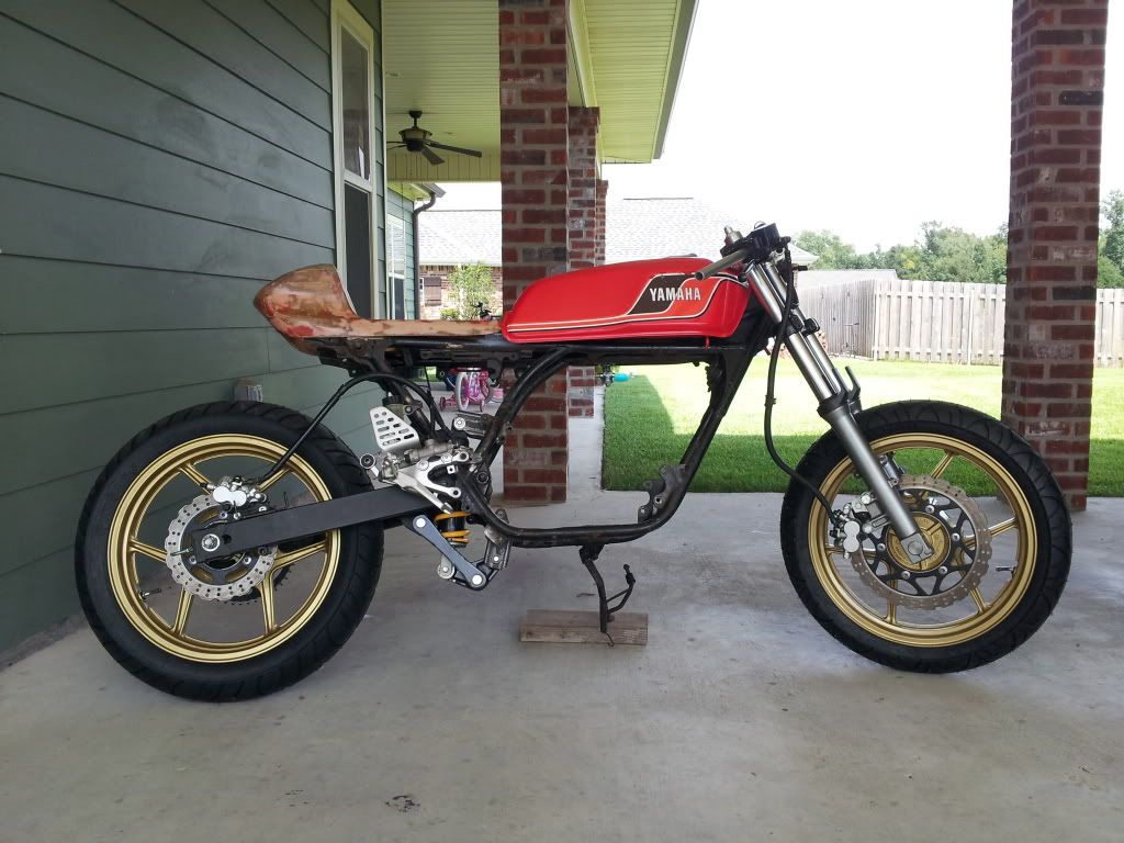

Now I have a roller!

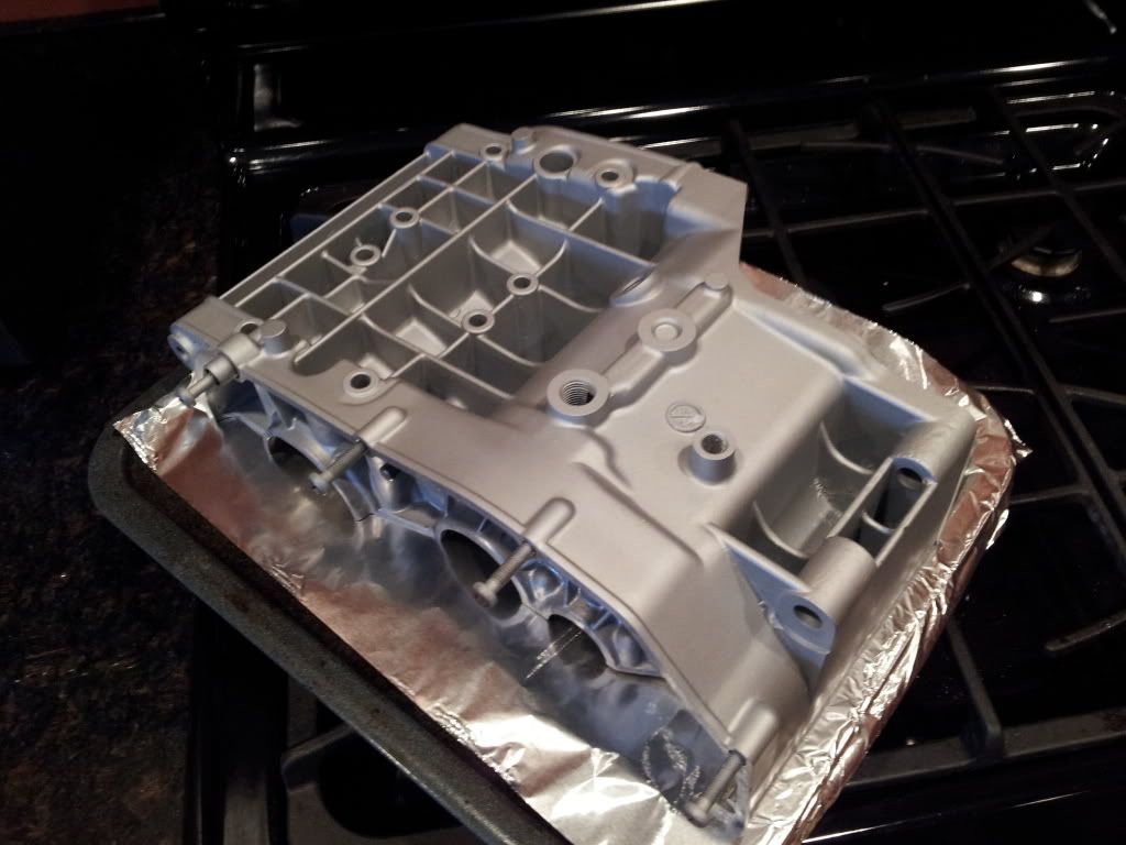

I started cleaning up the cases Here one is fresh from the oven. The wife busted me but she was pretty cool about it.

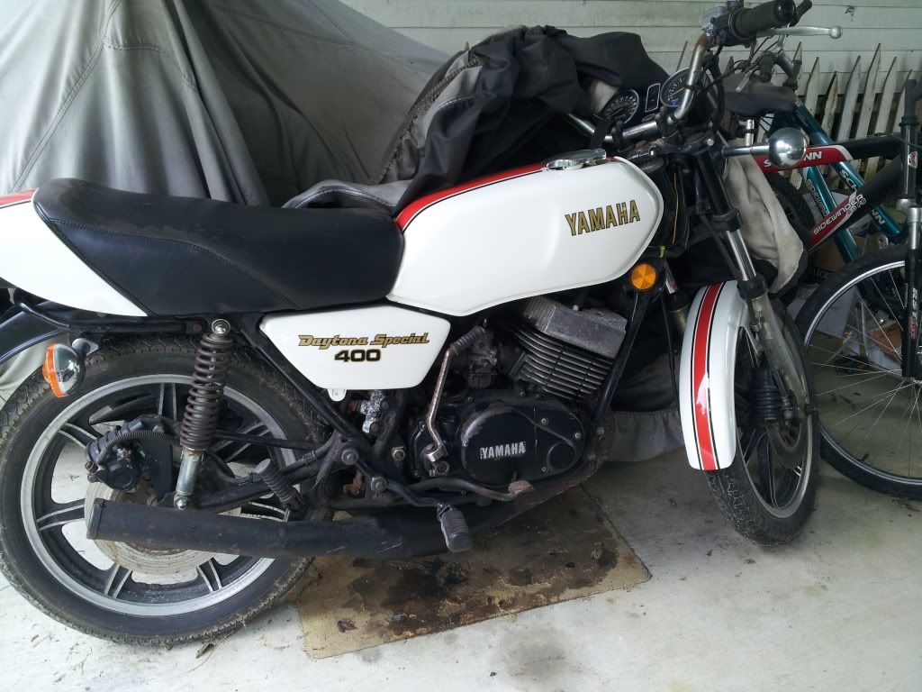

My dad talked to one of his old buddies who happened to have a Daytona special that he wants to sell. I really didn't know a good price for one but he wanted $3K for it. He said that he also has a 78 RD400 in good shape with a seized crank, another 400 engine, a couple of tanks and possibly a set of 350 jugs that he'll throw in the deal. I told him that the Daytona was probably worth $2200 but would have to look at the other stuff. The Daytona leaks oil out of every point possible but it does run. Maybe I went to high on the price? I told him that I need to finish the 250 first and he was cool with that. He said whenever I'm ready that the bike will be there.
