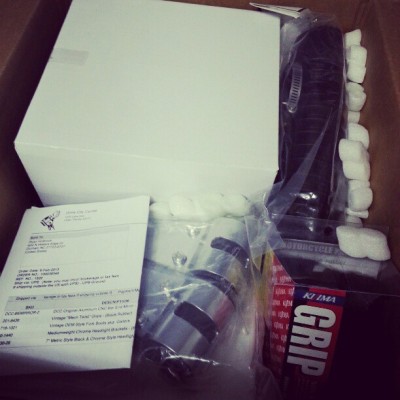

So a little update. Couple of days ago, got my package from Dime City Cycles in with some parts for the bike. Now just have to wait until my clip ons come in and I'll knock it all out in one go.
