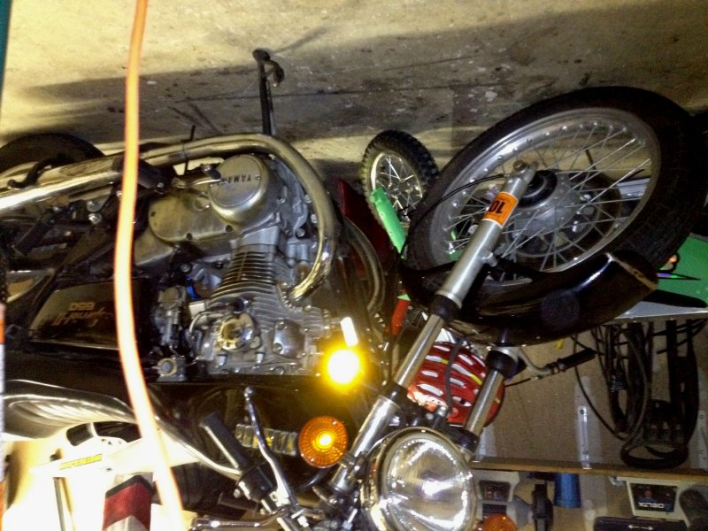

I am using a R6 conventional front end and a single shock design. My swingarm is from an XT550 and a shock from a Buell XB12. Here are a couple of pics with the forks mounted and the swingarm. I had to modify the arm a bit to get the right leverage ratio for the shock.

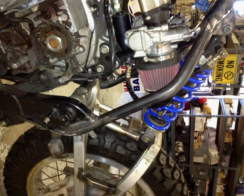

Ok here are some more pics. I cut the rear section of the frame away. I bent some tubing to strengthen the frame and tacked it in place. Similar to an MX bike design. For front rotors I am using Ducati 320mm discs with custom spacers. I had to make a special bracket for the brake caliper as well.

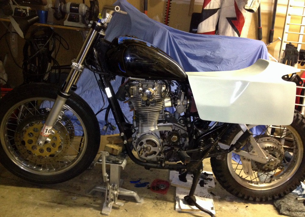

Some more pics, Here is a pic of the removable subframe I made. Also a side shot shows the bike with the Suzuki GN400 tank I am using and the Hotwings Glass street tracker tail section. Another pic of the bike after I trimmed the tail to give it a sleeker look. I cut out the gas cap from the Yamaha tank and welded it into the Suzuki tank. Here is a pic of the tank after I filled in the badges, smoothed out the cap area and hit it with some primer.

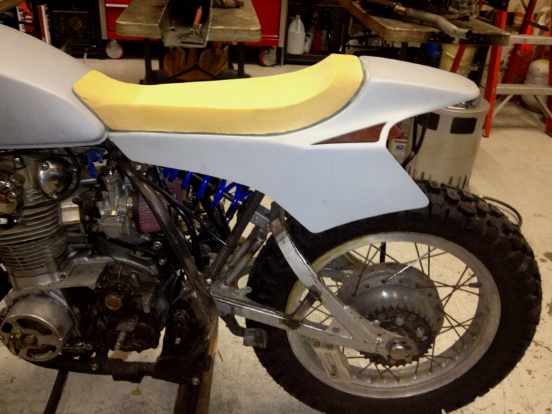

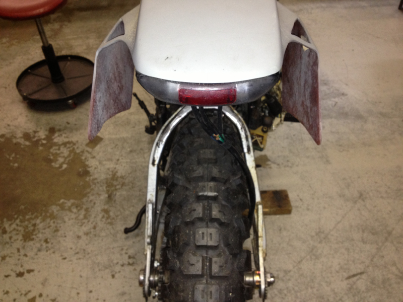

I made a seat for the bike. I laid fiberglass to make my seat pan so it contoured to the bike. I got a piece of seat foam from Hotwings Glass, cut and shaped it to fit my design. I still need to make a cover for it. I found a tail light from a mid size pocket bike that fit nicely. Also did a little more cutting to the tail just for style.

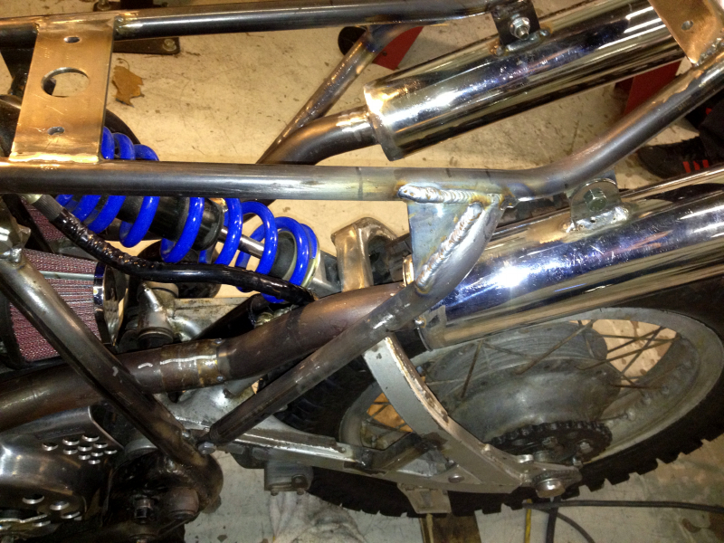

Now for the Exhaust. I decided to build 2 separate pipes. Kinda MX style routing. I started with 2 YFZ450 head pipes and a header from a CBR1000RR. As for the mufflers I used a couple of cobra cruiser units and cut them down, made my own end caps and welded it together. I used the resonators from the CBR pipe to make my own powerbomb header. Basically making use of some parts I had lying around. After cutting all the pieces and tacking it all together I am happy with how it turned out. The only issue was the oil dip-stick would not work so I cut it down to just an oil cap. I located a side cover from a newer XS that has a sight window, problem solved.

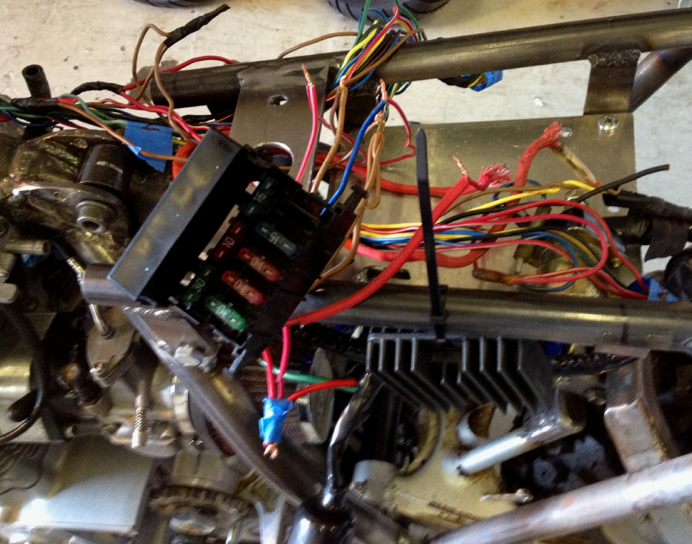

I started to attempt to re-wire the bike. I am trying to eliminate all the BS stuff from the XS harness. I also wired in a newer style fuse block from a XJ600. To make matters worse I am using newer R6 switches and the wiring is very different. I decided to do the banshee flywheel PMA swap at the same time. Using a ZX600 stator and CBR rectifier. I ordered one of the new Pamco Ignitions w/electronic advance, should be getting that soon so I can wire it all at the same time.
Some pic of the whole mess and the PMA swap.
