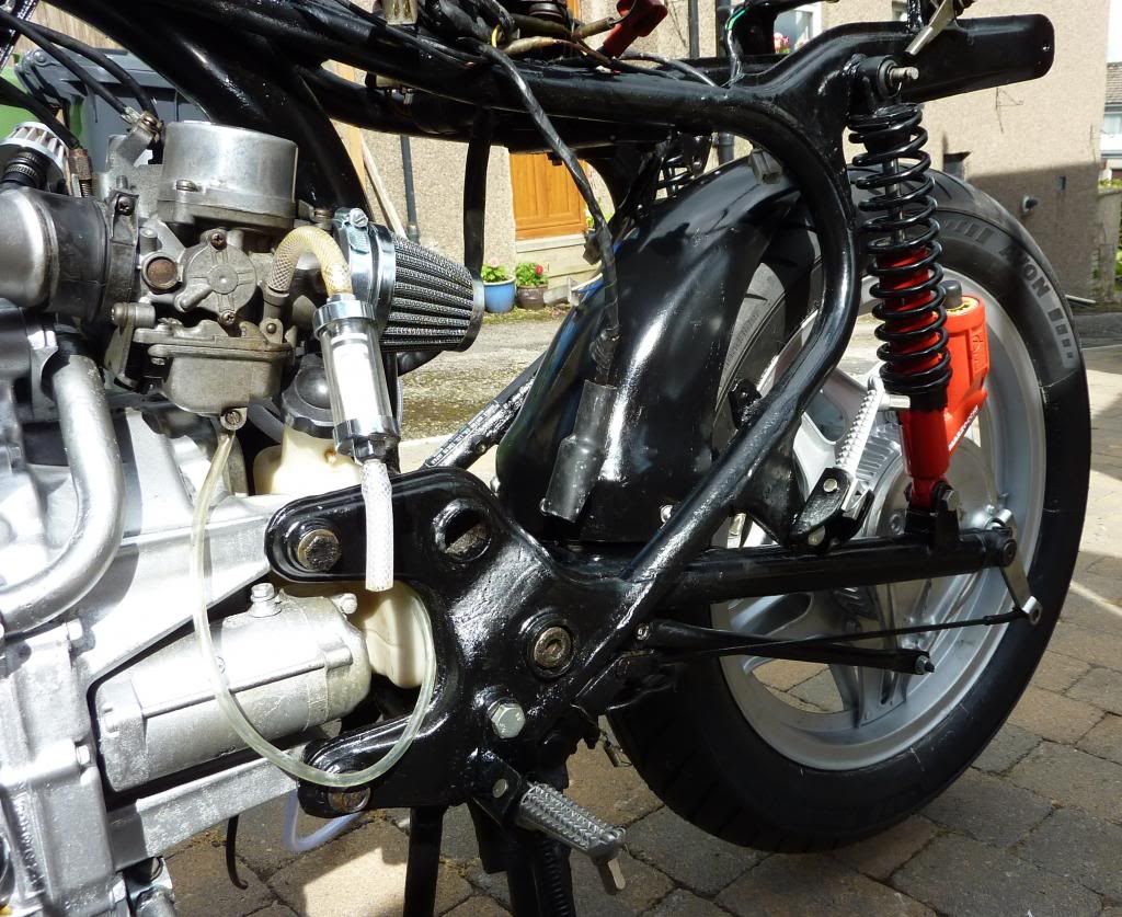

The carbs have been stripped, cleaned & balanced (just need to polish the carb bodies). Whilst I had them apart the jets were upgraded (guessed at 90/120), to match the pod air filters and free flowing exhaust (seen some nice Norton Pea Shooter replicas that should fit), the bike will be going on the dyno when finished, so it might get re-jetted again.
I've also been tinkering around with the footpegs. Rather than going for rear sets (I want a slightly more relaxing riding position), I decided to swap the standard rupper pegs for some alloy ones from a Yamaha R1. They fitted without too much modification - a little bit of grinding of the pegs & brackets, some tweaking of the springs and the rear brackets needed drilling out for the R1 pin to fit. The finished result looks pretty good. As this is going to be a two seater (probably more Cafe Cruiser than Cafe Racer), rear pegs have been fitted.
This is how they look on the bike

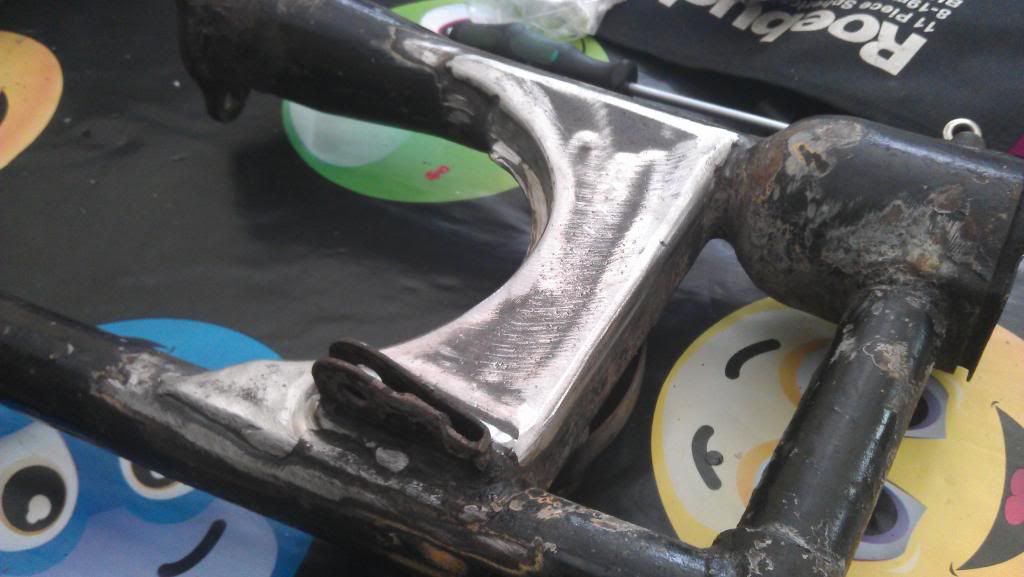

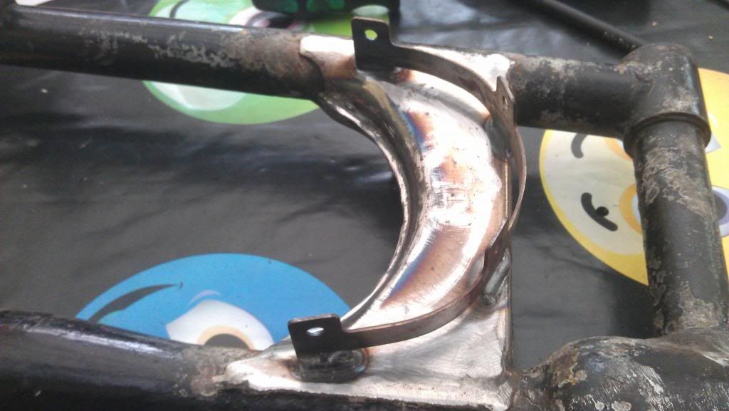

Things also got delayed due to the swinging arm going missing (a long story, but I gave it to a mate to weld the hugger bracket on and he found a bit of rot, so gave it to a local fabricator to weld - the trouble was my mate disappeared off to Spain and I didn't know where he had dropped it off).
As I mentioned, there was a bit of rot underneath the swinging arm, so it was completely cut out and a new piece fabricated and welded into place (along with the hugger bracket). It was then cleaned up and painted.

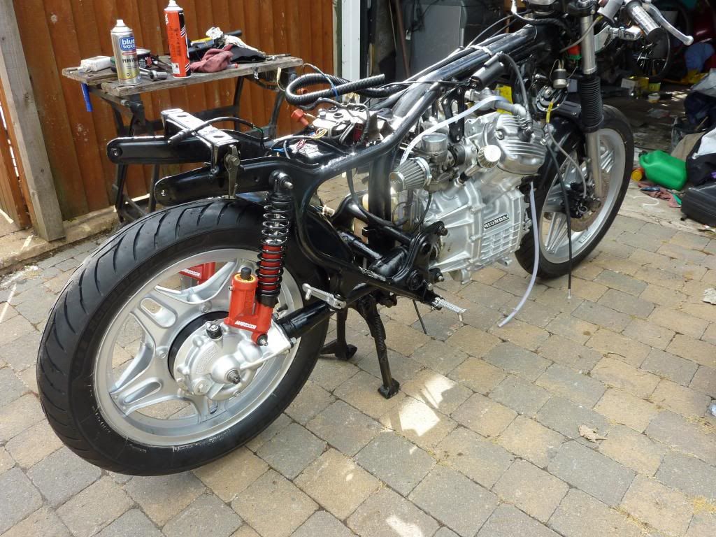

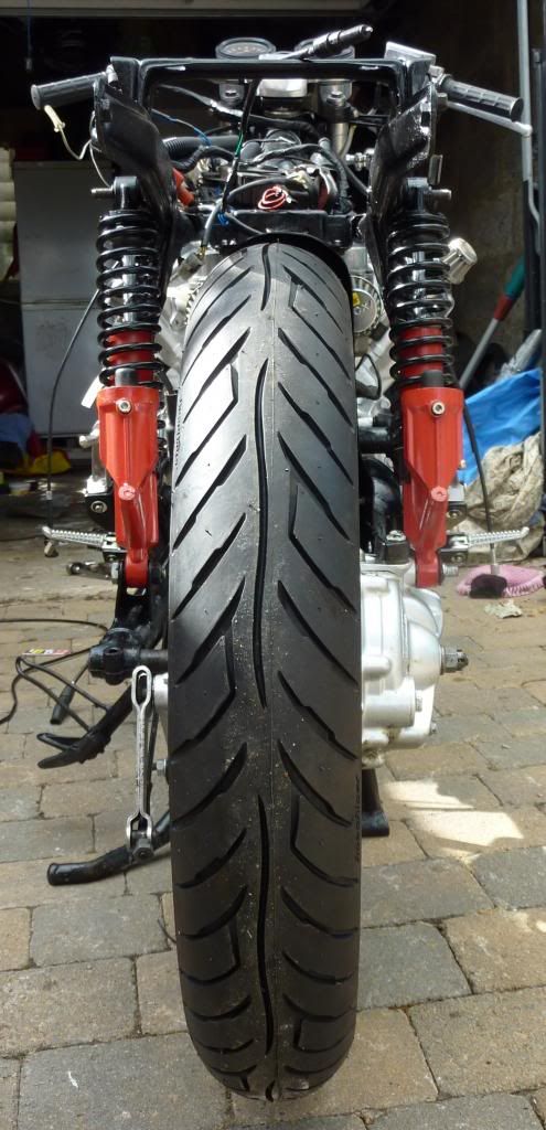

It's now beginning to look like I'm making some progress, now the rear end has been refitted.
The next job is to sort out the electrics and relocate the battery where the collector box was. Then sort the fuel tank (the original was too far gone, so I have picked a replacement up off ebay), prep it and paint it. Fit the exhausts, then hopefully fire her up. Then decide what I am going to do with the seat.
