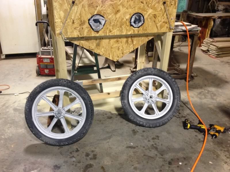

I really like these wheels.
I think I am going to powdercoat them in an oil rubbed aged bronze.....

did you blast them with the bearings in? if so, order some new ones. the grid gets everywhere.
Also a tip on blasting different workpieces.. if you blast steel first, particles of steel will mix with the medium. When you blast alu after that, the steel particles will embed in the alu and rust will occur.

Yeah ill be ordering bearings, I just didn't feel like spending the time to remove those haha.

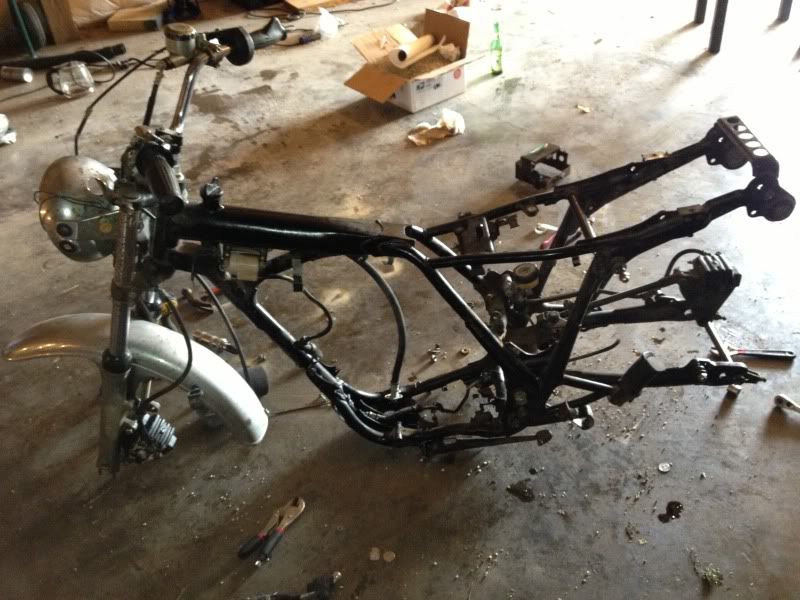

So Ive decided I may as well tear the engine out and do this right the first time.
While I've got it out I am considering getting a little more pep, Id like it to lift the front tire effortlessly in second.
Anybody know enough about SR500's to give me a good idea on where to start?
Wiseco piston, megacycle cam?
Etc?

Got the wheels, rotors, kickstarter, brake lever, and sprocket blasted today
Then tackled disassembly
Jesus god there are a ton of bolts holding this motor in the frame. I bet i tried pulling it 5 times only to find more bolts.
ANd then theres 2 oil lines holding it in
And then theres the clutch cable
and then theres the wiring harness
jesus
Got it out just in time to set it up on my rolling workbench things, which promptly flipped over from the weight, landing an SR500 motor right on my toe. Awesome.
but hassles aside there is real progress here!
Now I just need to figure out what to do with that atrocious rear frame.
WTF was Mr. Yamaha thinking with that one? Wouldn't it be much easier just to run a single tube?
« Last Edit: Jun 30, 2013, 21:04:37 by SONICJK »
