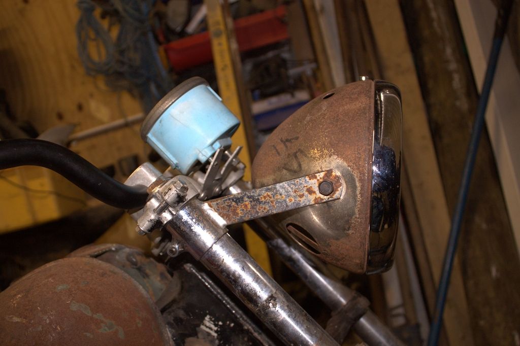

small update from some work we managed to get done. we had planned to try and get everything done in a day, a bit ambitious maybe but we felt good about what needed doing, Finish off the frame welding/tidying, make weld mounts and new petrol tap bungs into the tank and make some gusset plates to hide the large gaps front and back along the backbone, modify the rib in the rear fender to allow the brake light to sit in it and weld some small plates underneath to allow cables to run without fear of being ripped out by the rear tire, fabricate and fit the forward controls using my prototypes as a template/ guide. we had an early start on it and got the frame knocked out in afew hours but the tank had i bent over a barrel and spanked its an old BSA Bantam tank and thin in places so the welding had to be done very slowly and built up. but we finished the day with the frame done and the front mounts and petrol tap bungs in place and the rear mounts made and just needing welding.
i managed to find a while back some 60s john tickle headlight ears in 33mm and they look much better than the universal onse that didnt fit at all also a lucas haedlight shell at an auto jumble which suits the bike much better.
all in all it was a good day and i have another book in the workshop on the 15th may and we arnt leaving untill the other jobs are done and the build phase is finished.
