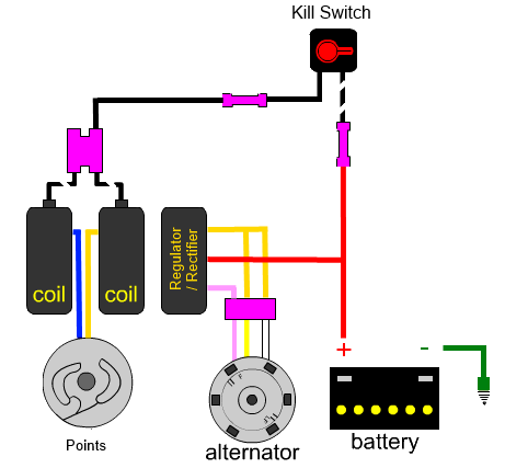

Barebones diagram for the Honda twins and singles. Only enough to get the bike running and keep it that way. No lights, signals, or gauges included. Though not pictured, I recommend a 5A fuse on the black wire leading to the coils.

Sonrier, sorry if I am being slow, but when I read the first pic it looks like the neutral light is connected to the R/R. What am I missing?
I'll clean up that pic... it's mean to be running behind it and connecting to the same connector that runs from the alternator.
Ok. Cool. Thought I was losing it.
