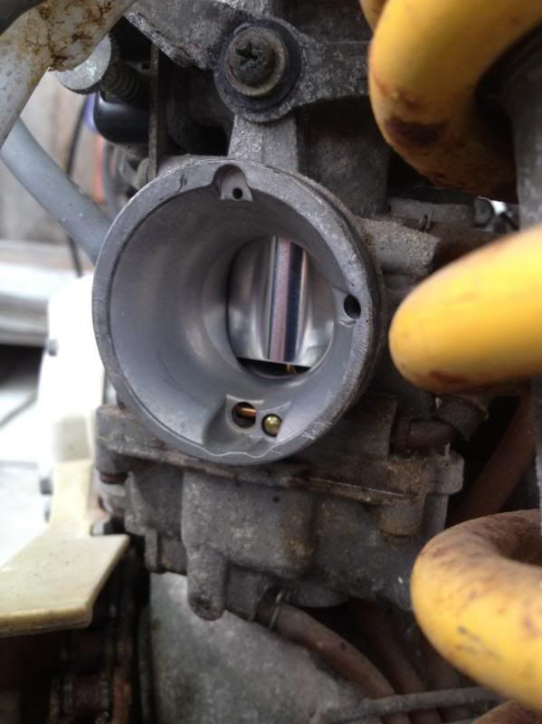

It sure takes a lot longer than planned to get things done when you want to just move ahead  >:(.....anyway....

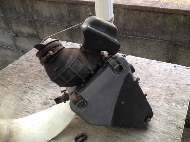

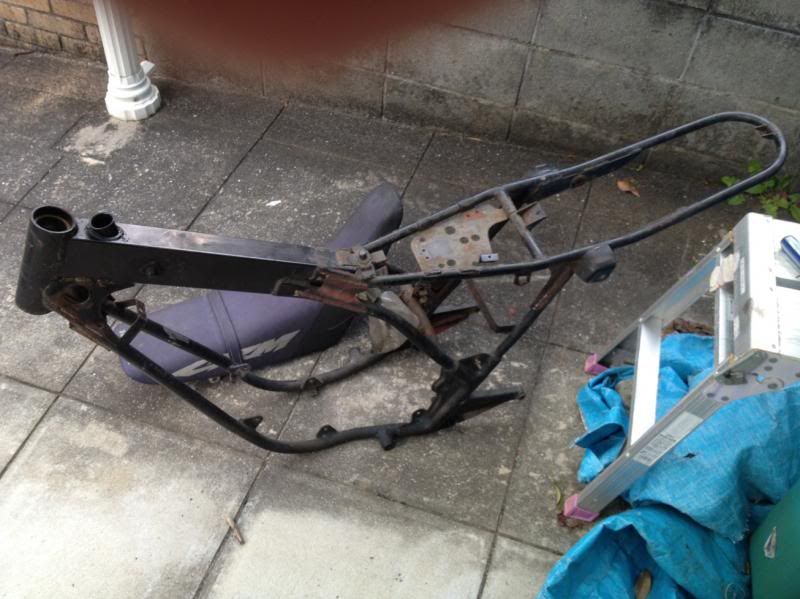

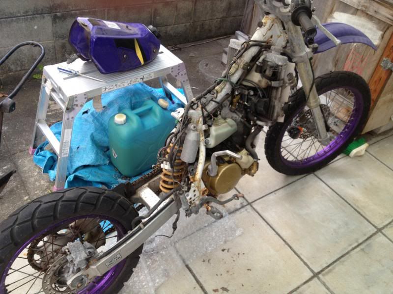

Spent more time measuring the AMF-HD frame against the CRM frame and components. I have to work out how to get the CRM engine monitoring system working with the AMF-HD airbox, as the CRM airbox is way too big.
I pulled all the electrics out and sorted out the main loom (I plan to do a straight swap of the CRM loom to ensure all the sensors / solenoids are powered.  I did manage to get bad welds redone and gussets welded in for better rigidity, with patterns taken from the later Cagiva SST frame. I am going to have the welds smoothed and redone to be sure there are no bad welds.
Next, the engine / cooling system will be removed and matched up to the frame.
The best part today was when I removed the airbox to check the condition of the carb intake......
More later.

Out of curiosity - since you're cutting everything up anyway, why not build around the frame that already fits the motor?
