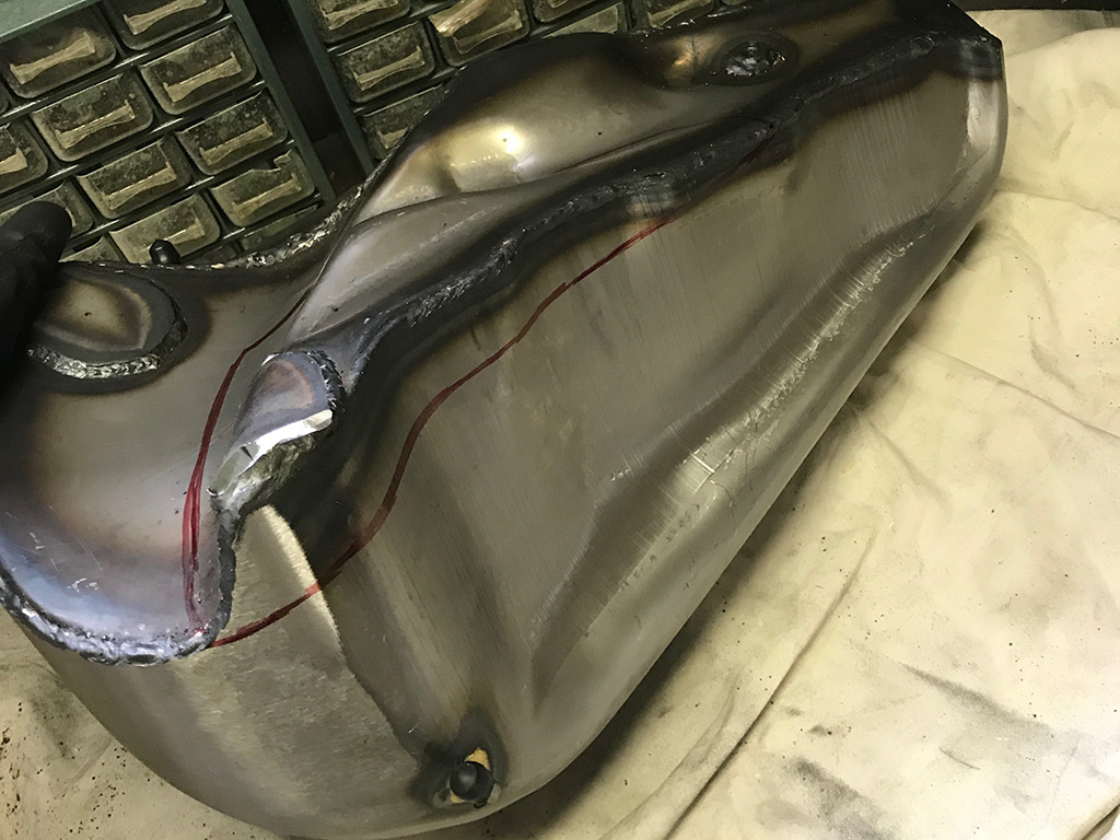

Working on a facelift this weekend. A few months ago I snatched up a set of the same old harley split tanks I had already setup on this bike. They were brand new ones, bare metal. Once I'm finished re-fabricating the bottoms of them, I'll sand and polish the metal, then just seal with a clear coat (and redkote the inside). The original tanks I setup on here were just in terrible shape, massive dents and all filled with puddy. So there was no way I was going to be able to use them for a bare metal look.
So far so good, I've cut out both bottom ends of the tanks, and have already re-covered/welded one of them back up. Here's an idea of how it's going to look.
And if any of you are wondering how much work is involved to make tanks like this work on a goldwing 😳...
Also ordered a few new toys: New headlight (found this one was broken, looked like some rocks from the road destroyed it), drag bars (I've seriously gone through at least 4 different types of handlebars, still trying to find the right ones that look just right), and a new wiring loom. The original loom is a bit of a mess, and I'd like to try to start from scratch with a good one.
