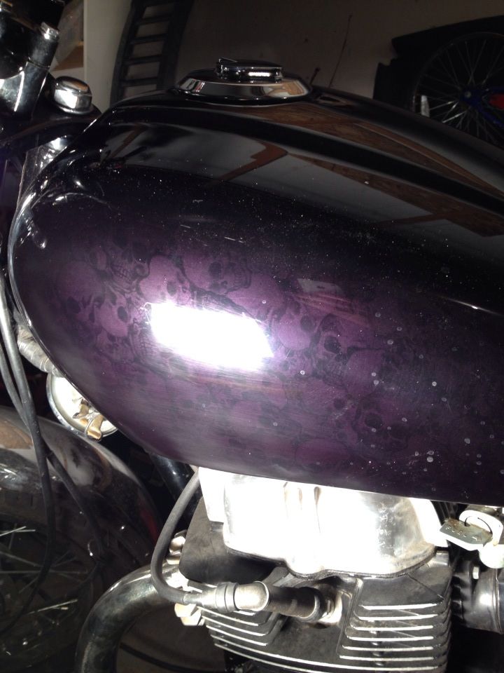

close up of the sweet tank paint job

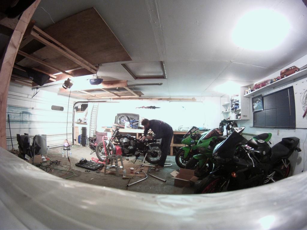

Im doing a 30 second interval time laps with the gopro of the entire build, here is the start and finish last night. Ill upload each nights work then a final complete video at the end.

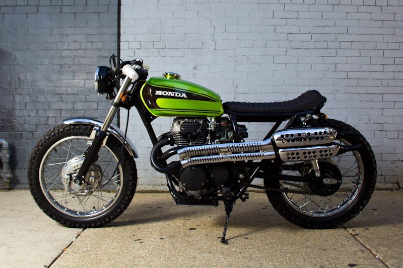

a little inspiration

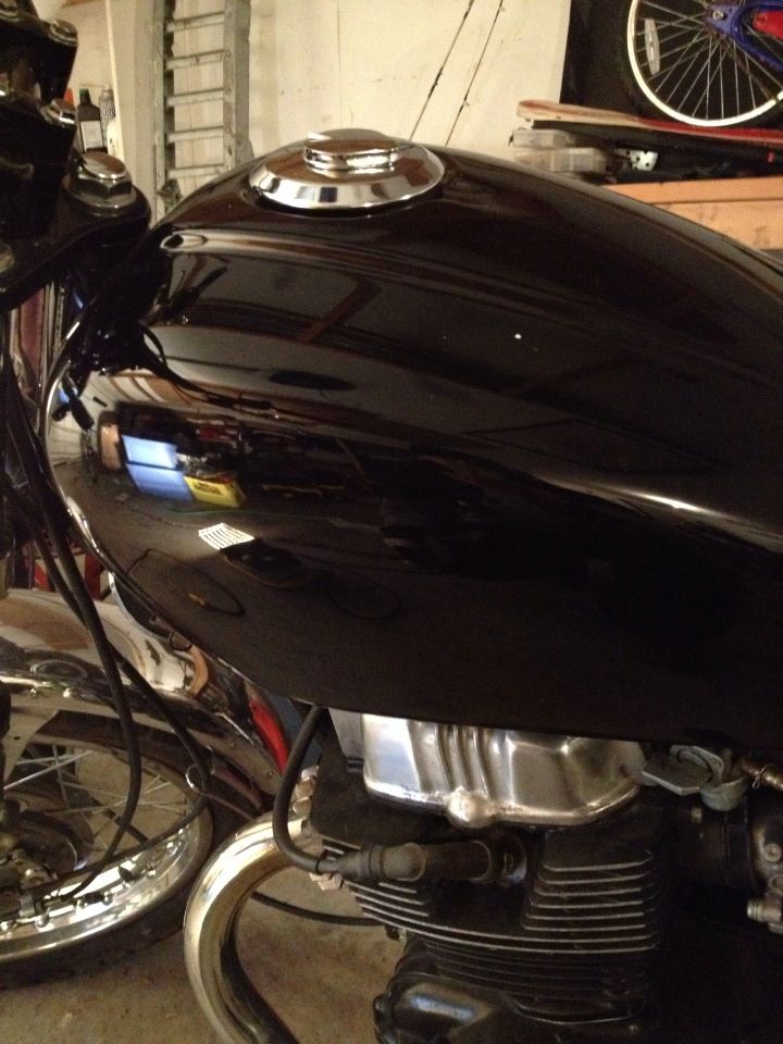

Removed parts, not shown are the cables and harness and all that junk
the first problem with the exhaust

I'm on board! Can't wait to see what you have in store. Love your inspiration bike. Where can I find out more about that one?
Offline D4N63R
  • Posts: 325
Re: '83 CM450e brat tracker ride it to work type thing
« Reply #3 on: Dec 17, 2013, 15:57:36 »
I found it on this forum actually! hold on ill go find the link to the build.
here it is http://www.dotheton.com/forum/index.php?topic=36443.0

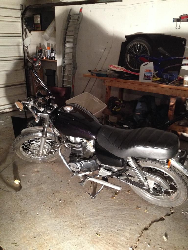

A better shot of the current state.
