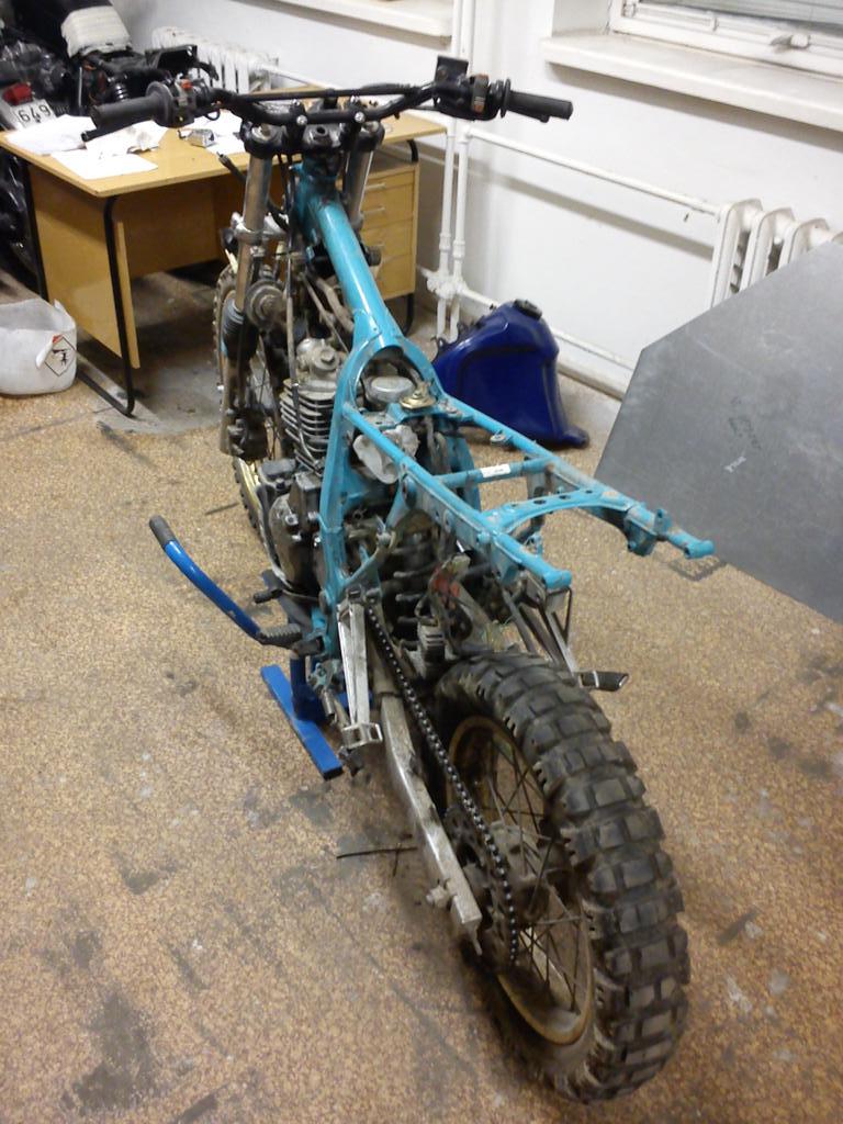

Managed to strip it down a bit already. It was missing the tank plastics to begin with but it was in quite a decent condition for that price.
Stripped, wiring still attached:

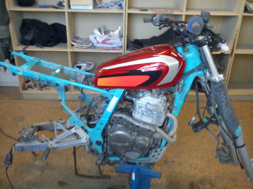

Trying on the tank i bought from German eBay. It's a classic version Honda CG125 replica if i remember it correctly. It's used in Thailand or Vietnam or India even nowadays, on replica bikes with strange names. Since i live in Estonia (Eastern Europe), we don't have used rareish parts on sale locally, they must be ordered from the web. By the way, the German guy had also built a Dominator tracker.

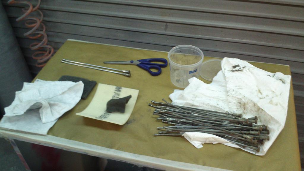

So what now? Now we brake the wheels into peaces. Domy's front wheel is 21" inches which may be practical, but is also ugly as f*ck. Managed to get rear spokes open, probably due to the chain oil that had been spilled onto them. But had to cut the front ones. Otherways i could have rethreaded them. They say it can't be done but there are some guys who can do it. Working on the spokes:

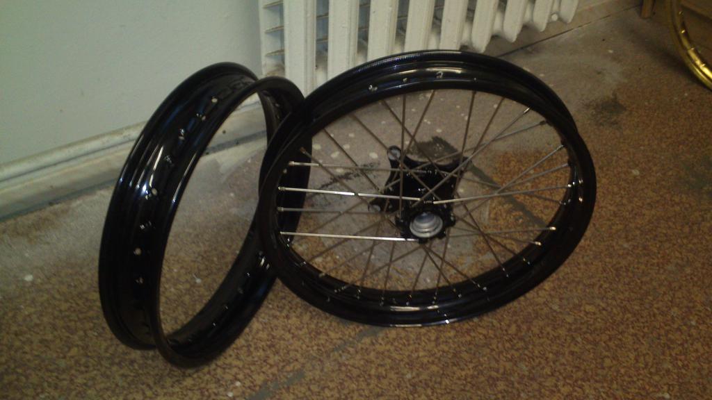

I decided to use original hubs when refurbishing. You can also use 19" Honda SLR front wheel but it also means that you must get a new caliper. Since wheelbuilding is really expencive, i decided to keep the rear wheel (17" X 2.50, 32 spokes) and buy a new front one, 19" 2.10 SM Pro rim. Again, due to my location, i ordered a new one from UK. Also, measured the original spokes, did a little calculating and got new spokes. DAYYYUMN they were beautiful. Polished the old rear ones too and had them zinc-plated or coated, however you call it. Cost like 2 euros or something (2.75 bucks  :) )

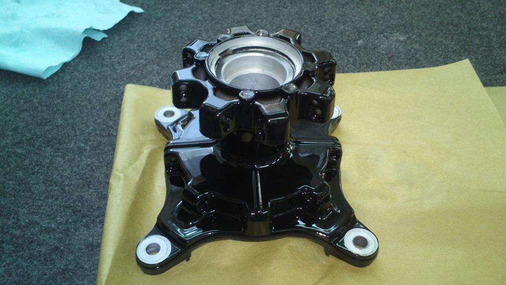

Repainted the hubs, the front one below. No spray-canning here, proper coating and varnish.
The rims were powder-coated to gain durability. And voila, partially assembled (new bearings for both, obviously, not in the picture):

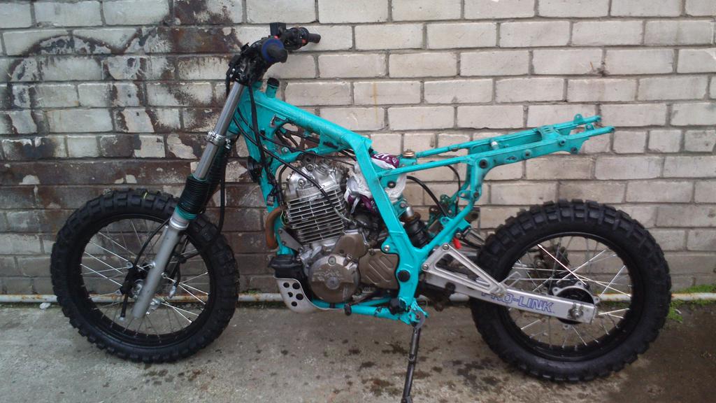

Got myself a brand new pair of Conti TKC 80s, from Germany again, and the result (not lowered yet):

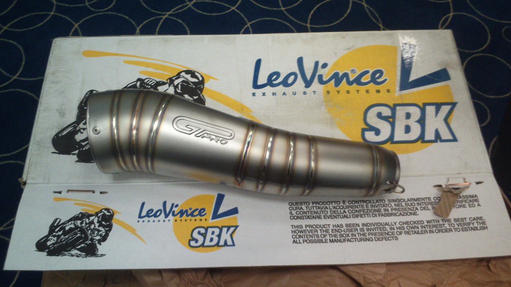

Next i got myself a new Leo Vince muffler, again from Gremany. Originally it came with fittings to a Yamaha (i dont remember which one but i didnt really care since i needed a custom manifold anyways). I call it the wasp's ass.

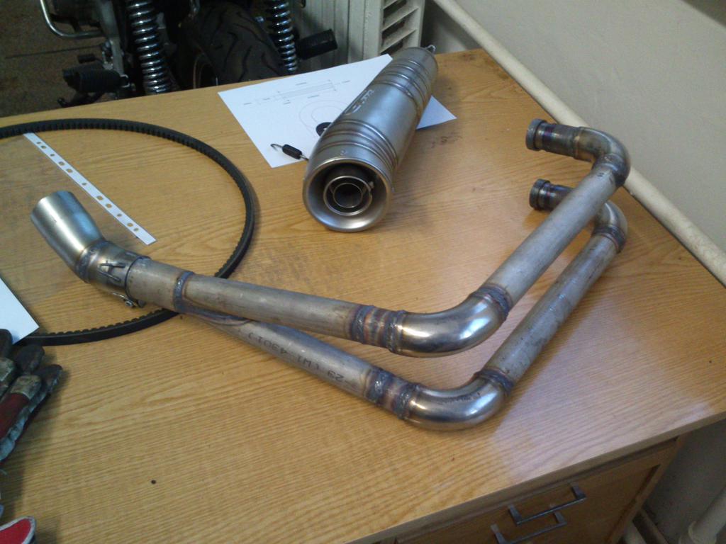

Then, i had a new stainless exhaust manifold made, since i dont have proper gear for bending pipes in my garage. The original ones were really thin. Besides, i couldnt have used them anyway because original mufflers were under the seat and this didnt go well with my "evil plans".
The manifold:

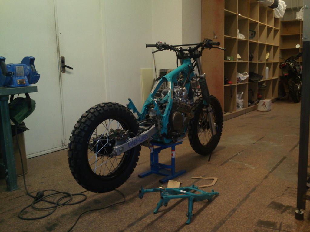

Next i cut the tail off because it was sticking up in the sky, especially after i had lowered the bike from the front for approximately 5 cm. This we cant have. Now, this took a few weeks of proper thinking since we have a proverb here - measure 9 times, cut once.

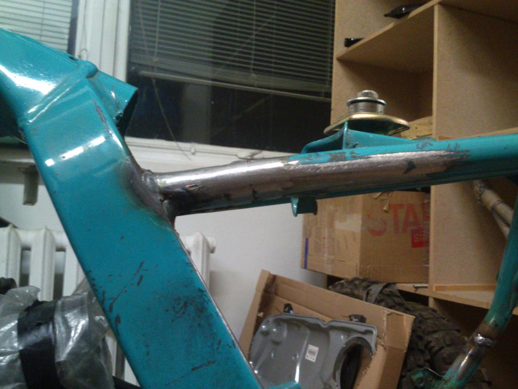

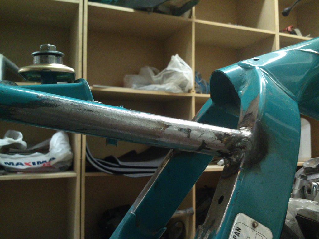

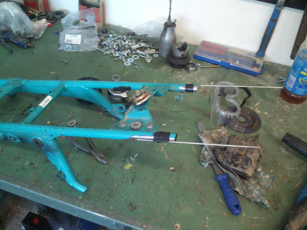

Then used the ripped spokes to measure the new "entry-points" :) The horisontal tubes had to be extended and bent just a bit aswell.

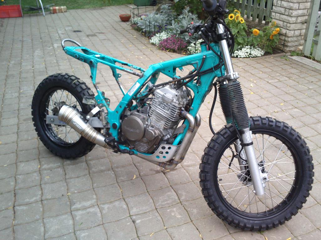

I didnt think that id like straight diagonal tubes of the subframe, its too sterile and minimal for this kind of a bike. Anyhow, after re-attaching, with loop in the back. Looks a bit like a dachshund in this picture but its really a nifty piece of machinery.
Some pics of working on the frame, still in progress:

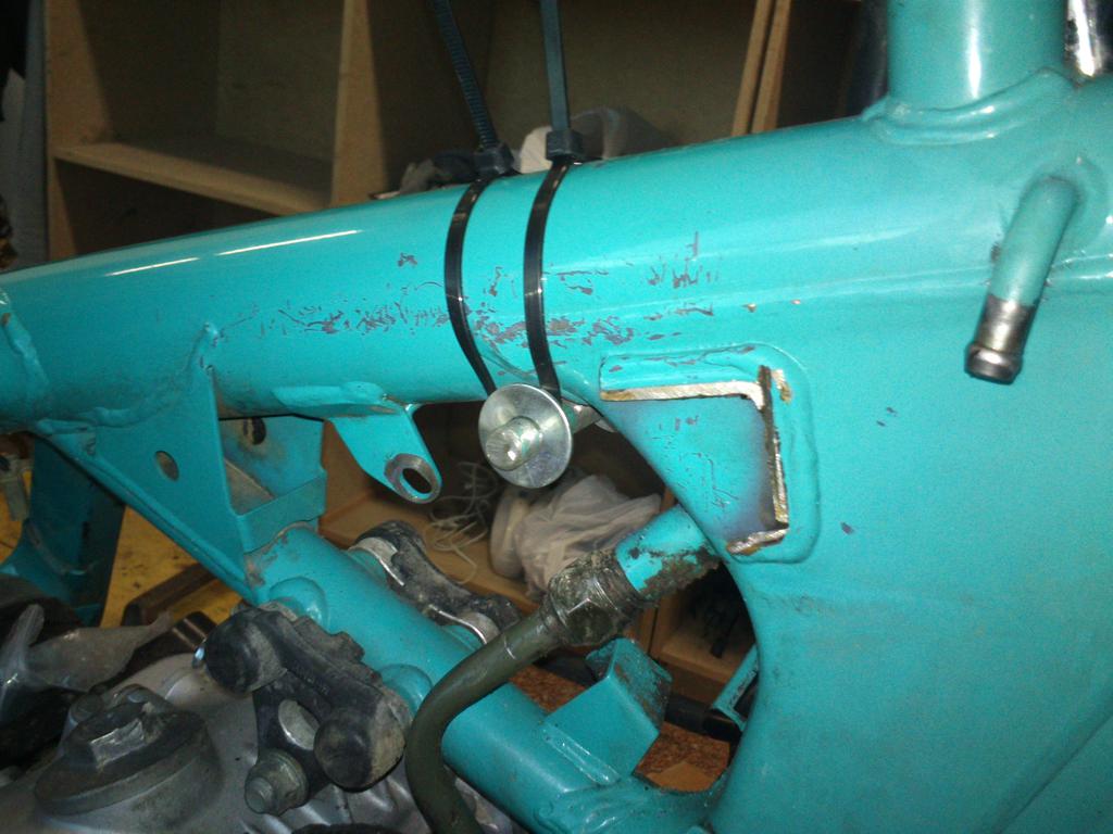

See the hole below the horisontal tube, this is where it used to be attached:
Working on attaching new tank, attached and measured but waiting for a weld:
Last week i welded new brackets below the the tank i had cut off previously. The location is perfect but also managed to weld a hole in the tank. DAYYYYYYYYYNG! But hey, aint nothing that cant be fixed.

2 guys in the garage is always more productive than one. Today my friend Dave helped me to fix the little hole in the tank i made when welding the mounts. Doesnt look very pretty, but fits like a charm and is strong enough. Im really pleased how it turned out, got one thing done again.
