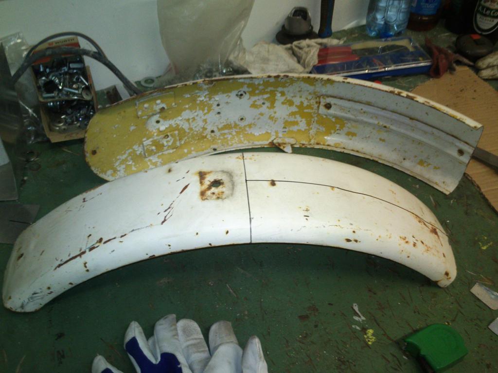

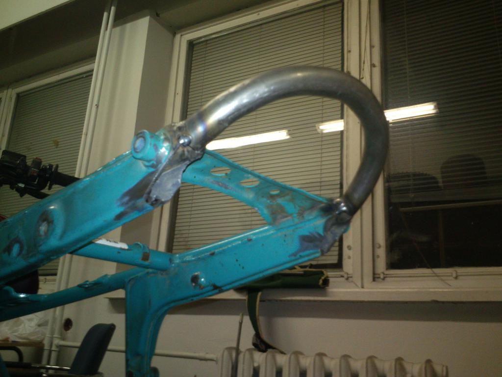

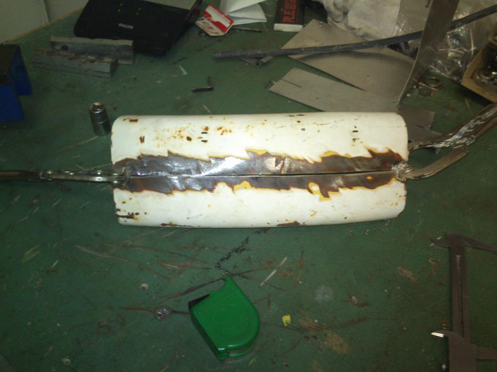

Taking baby steps. Here's the old sawed off rear end:
And here's the same thing with a bit welding and grinding done (a bad pic due to flash but no holes anymore):
You can also notice the small bar added to support the front end of rear fender. Did a bit of cutting on an old soviet bike's rear fender and got myself a rear and a front one both. I was thinking about going short MX style rear fender with led-stripe rear taillight, but the soviet one has a cool spot for a light on the top rear end so this is ideal for retro style fender-light. A bit longer, just below the cross-bar rear fender is also more practical, because it protects the KN pod a bit.
Cut in half, its was a huge one:
Front one in progress:
« Last Edit: Jan 04, 2014, 14:51:11 by tort »

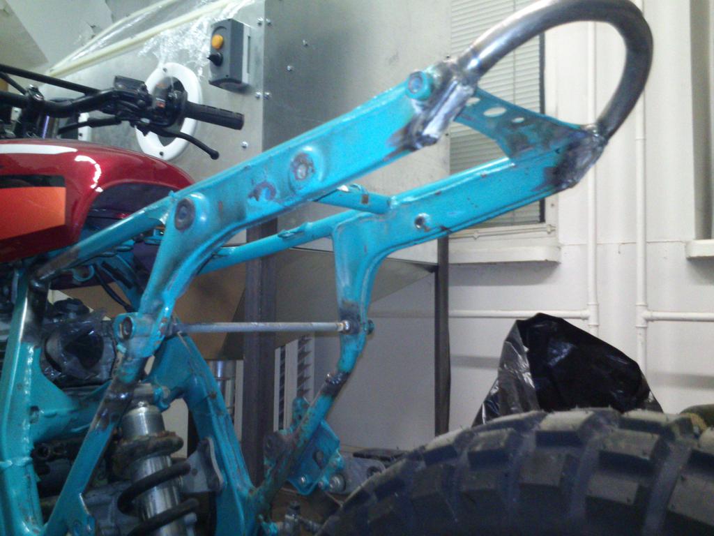

Thought of riveting old original front attachment to new seat pan but the rivets were not long enough so i welded this ultra-beautiful thing from a steel bar and a washer. Its even better solution because i got the thank to be as high as i want, with exact perfect space between the tank and frame.
The seat pan is mostly ready, needs some grinding from sides but it fits great. There's a higher cross-bar in the back of the original subframe, which i didnt want to cut so instead i cut and re-welded the pan. The rear end is actually lower since the bike is on a stand. Also attached temporarily the rear fender for testing. Needs a lot of work though and its going to be just a bit shorter.
« Last Edit: Jan 18, 2014, 14:17:31 by tort »
