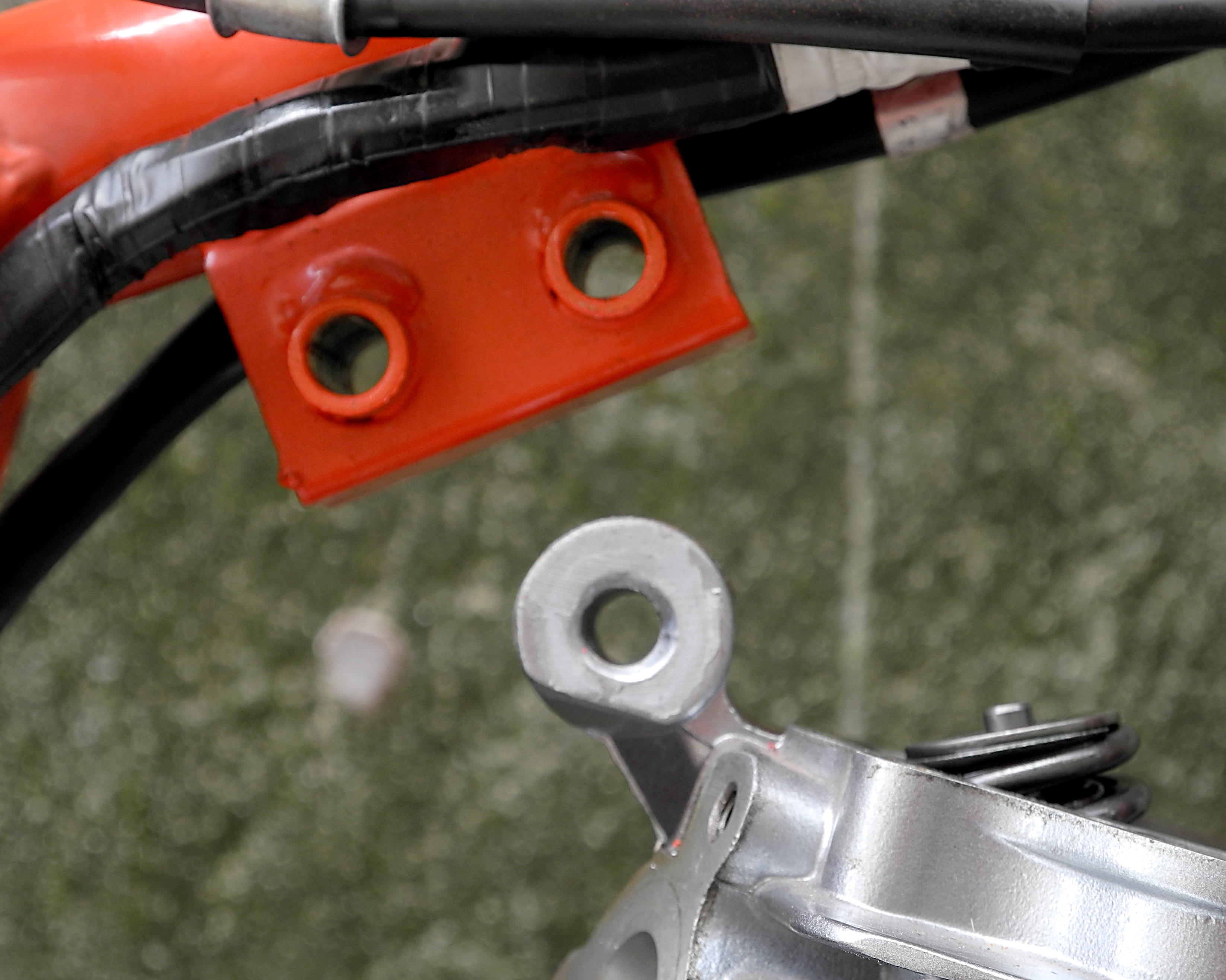

Remove head steady bracket, the two bolts holding the front engine mounting bracket to downtube, top rear mounting bolt, and loosen bottom rear mounting bolt:

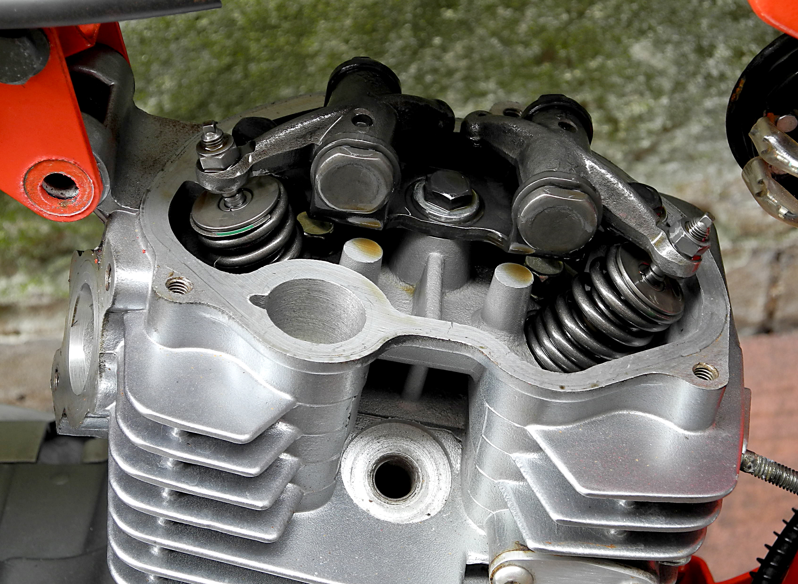

Remove tappet cover:

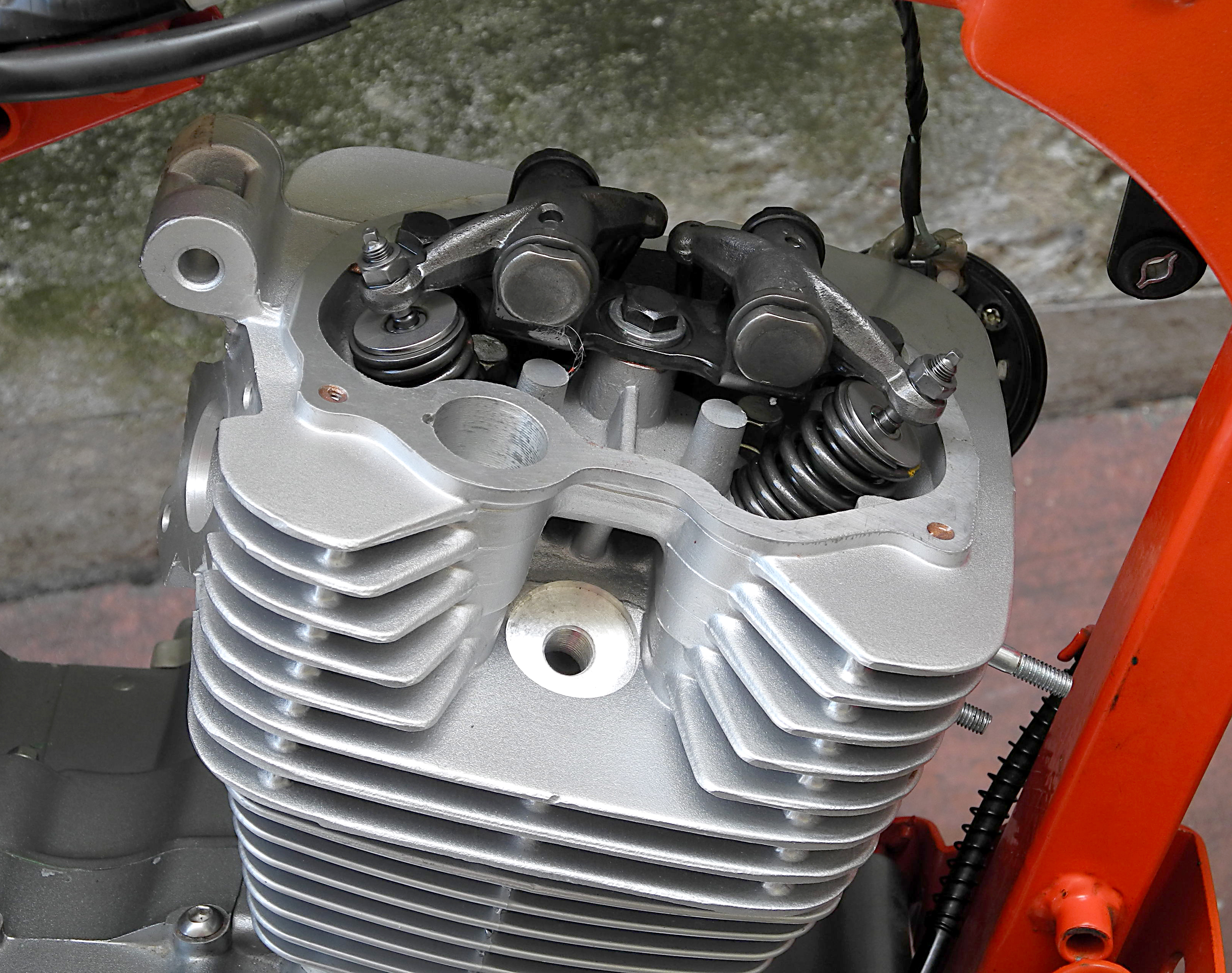

Remove rocker assembly; when lifting pushrods, make a note of which is intake and which exhaust:

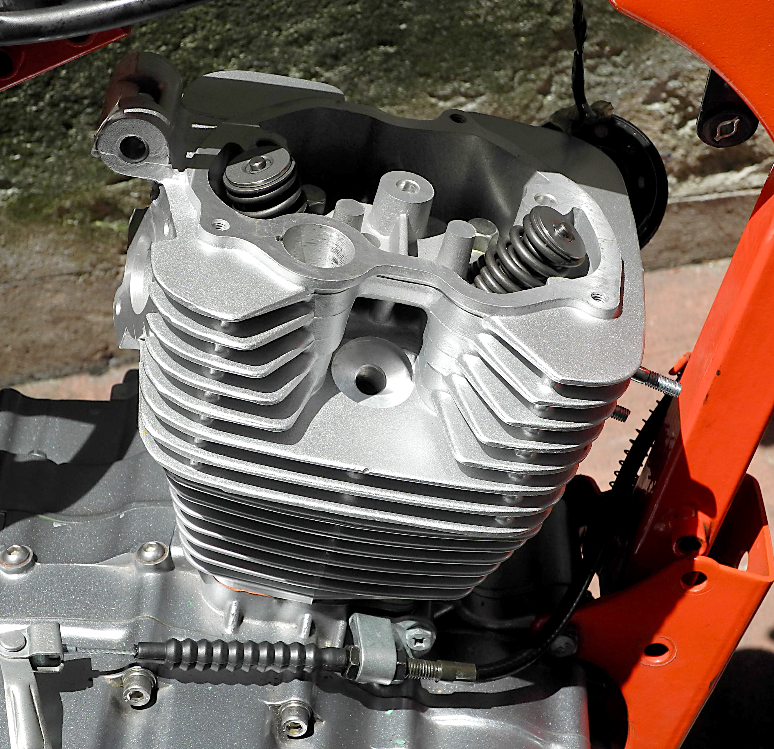

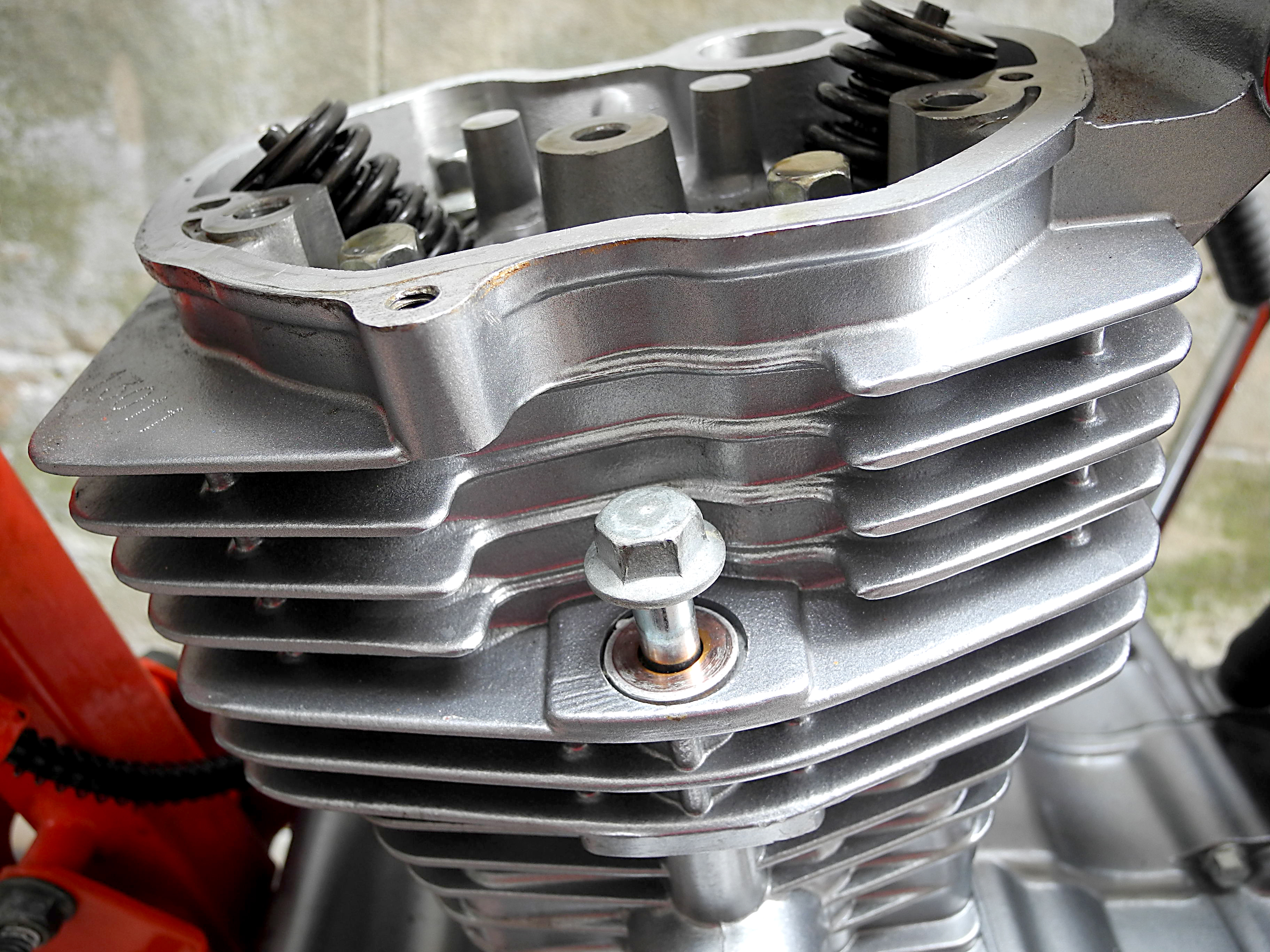

Remove the four head bolts, not forgetting the cam locating bolt on LHS of motor:
Lift head clear, keeping a look out for the dowels between head and cylinder:

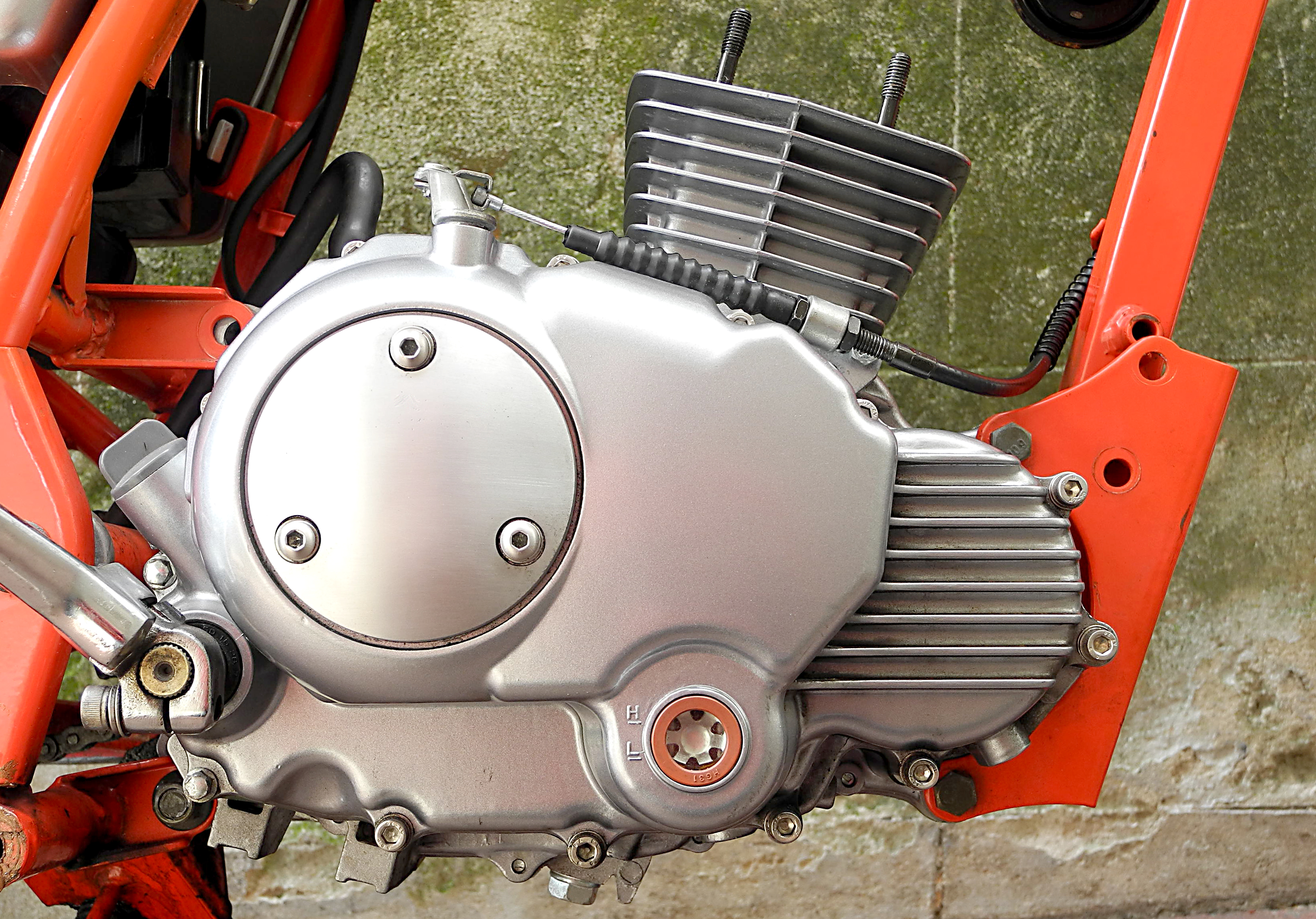

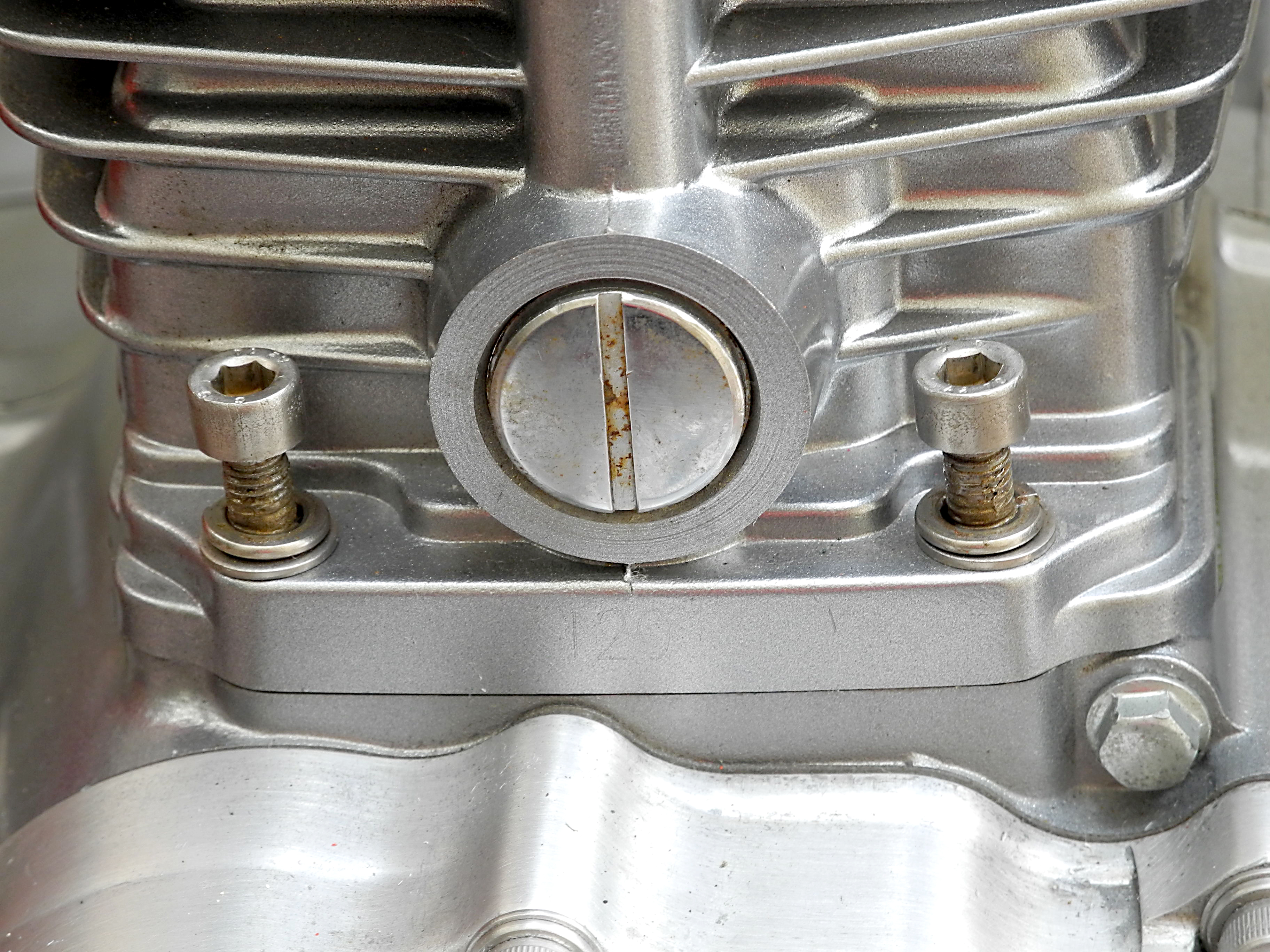

Undo cylinder location screws on LHS of motor:

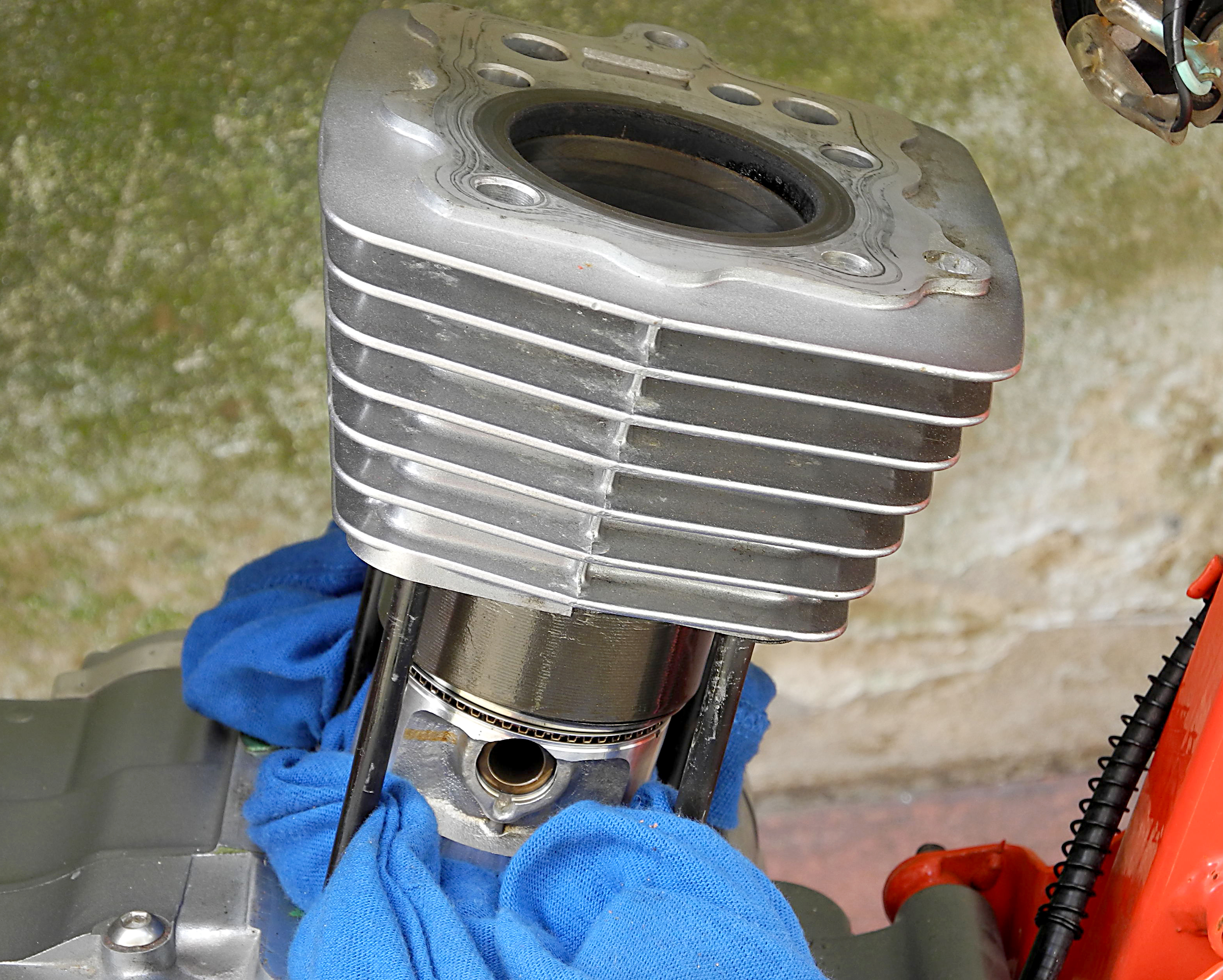

Lift cylinder, taking care to stuff crankcase openings as soon as possible

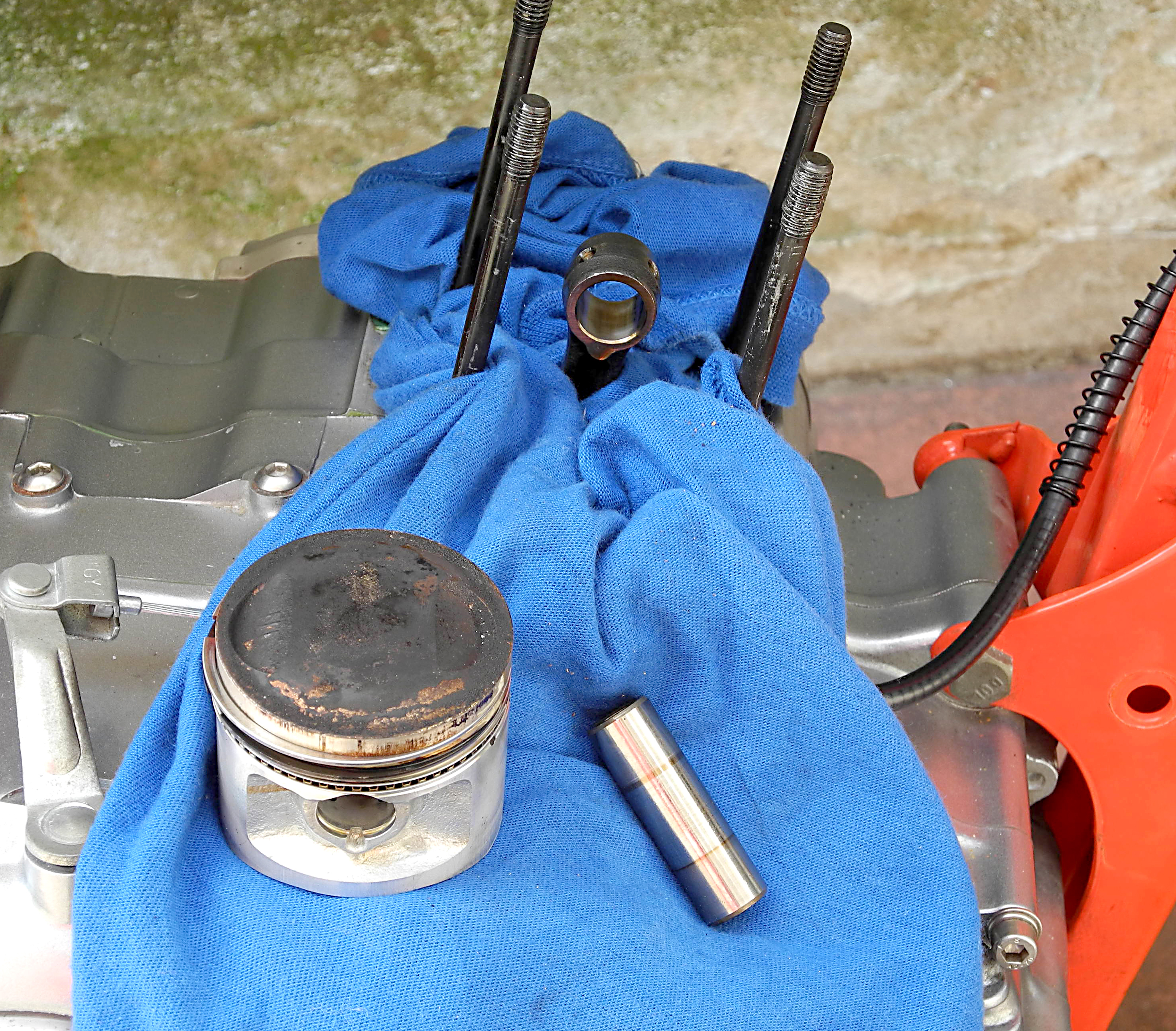

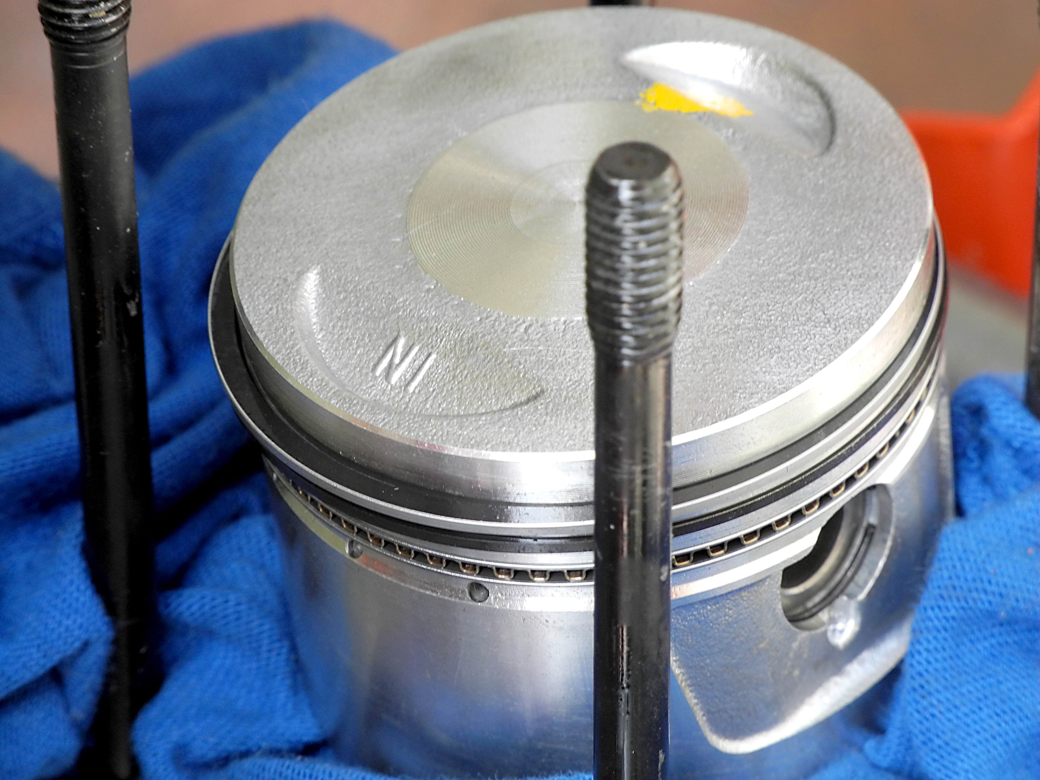

Pry out circlip from one end of gudgeon pin and push pin through the piston from the opposite side. (do not re-use circlips!)

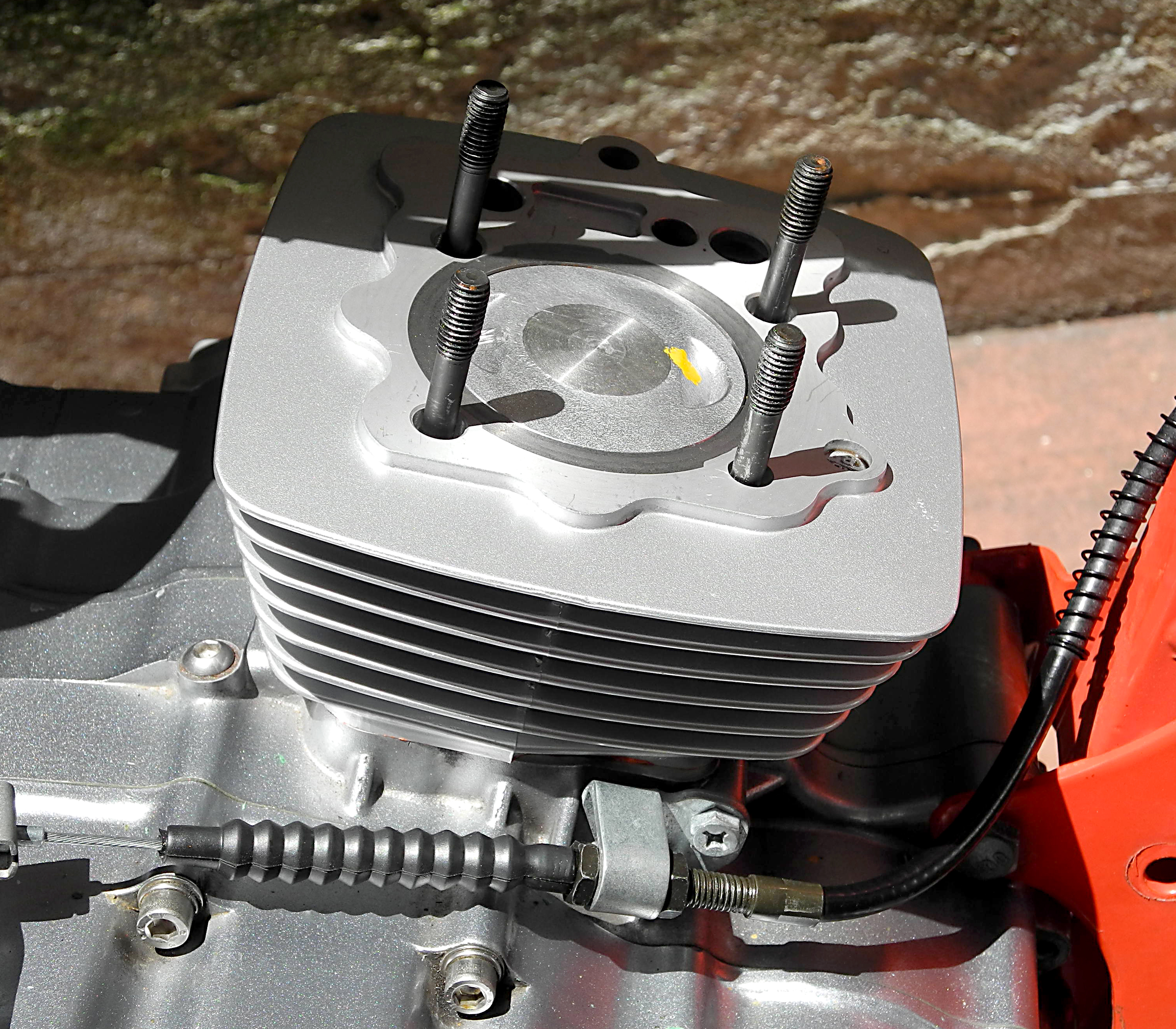

Install new piston noting marked inlet side (lightly oil gudgeon pin to install),
make sure circlip gaps are to top or bottom rotate rings so that the gaps are 60 degrees apart:

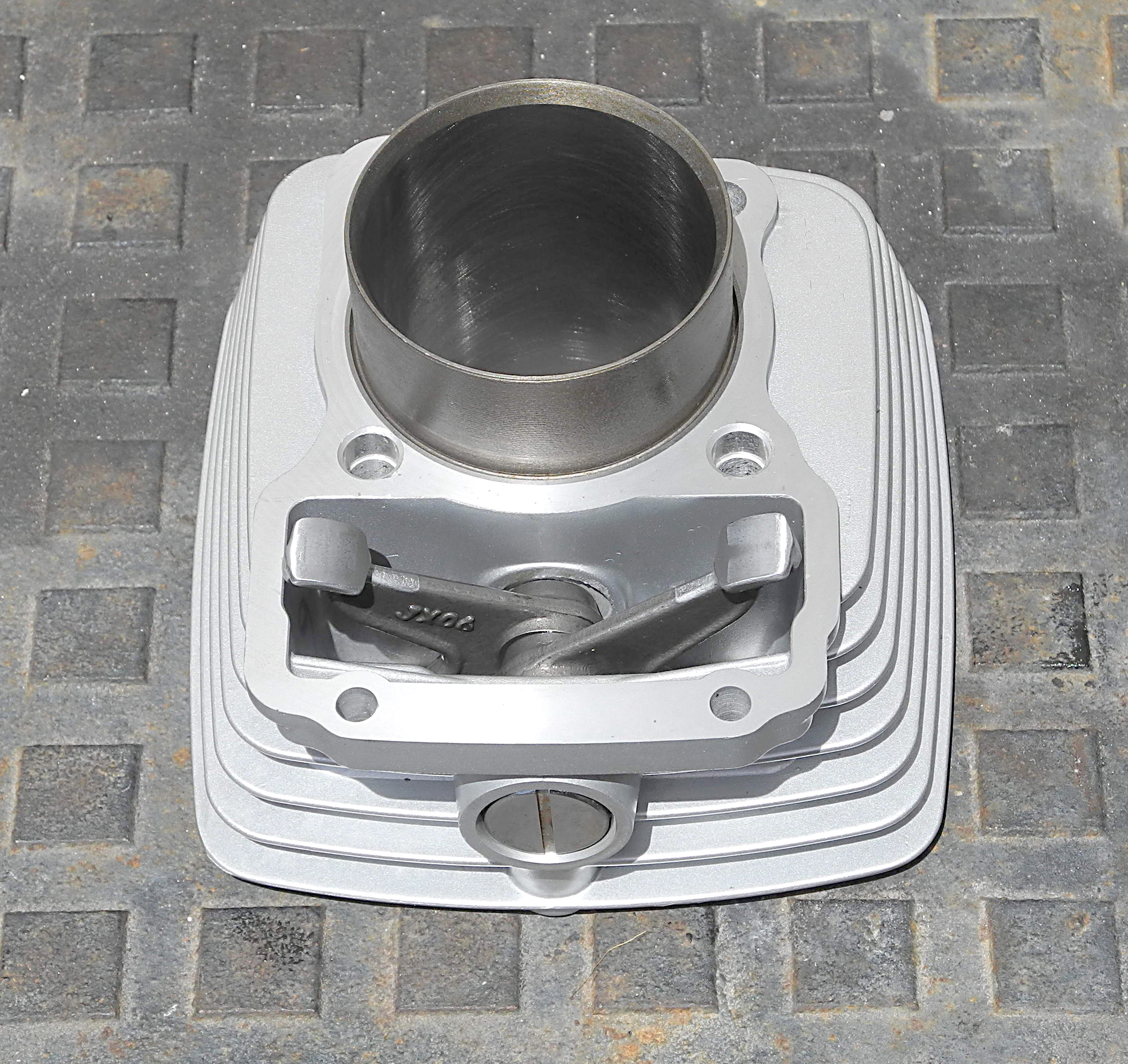

Swap cam followers from original cylinder (be careful not to lose the wave washer) to the new cylinder:

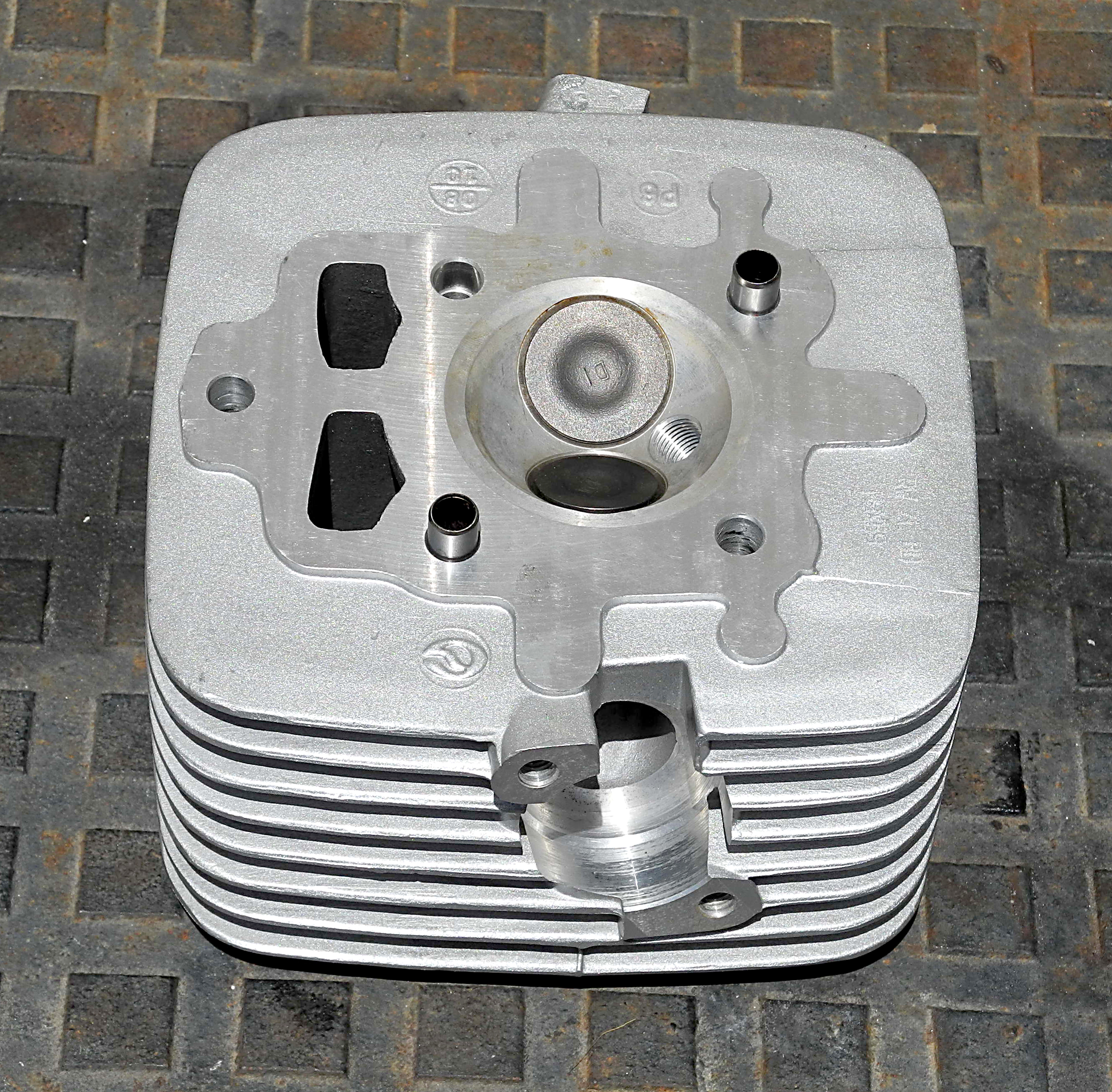

Dowels in place in head:

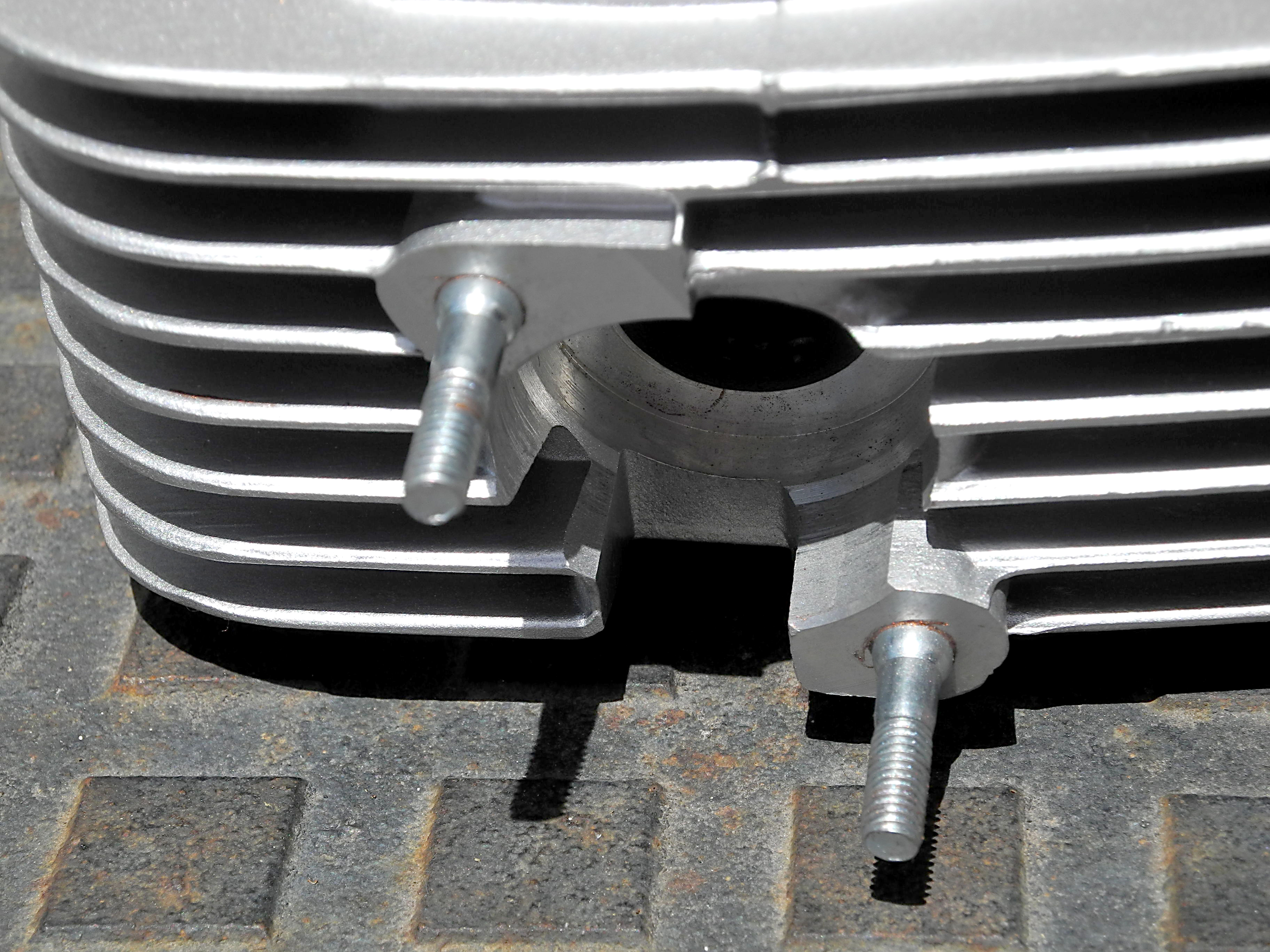

Install 8mm/6mm exhaust studs:

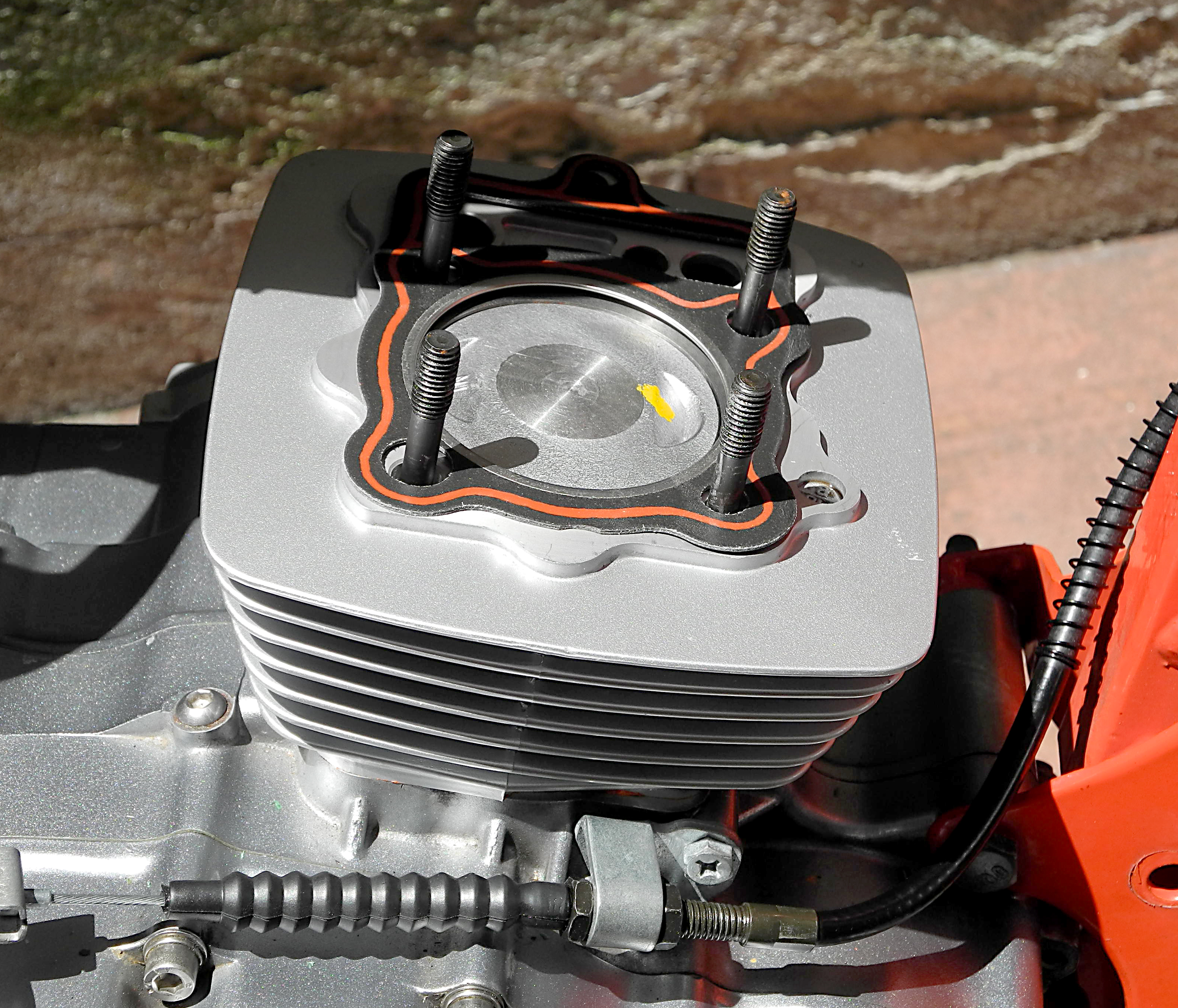

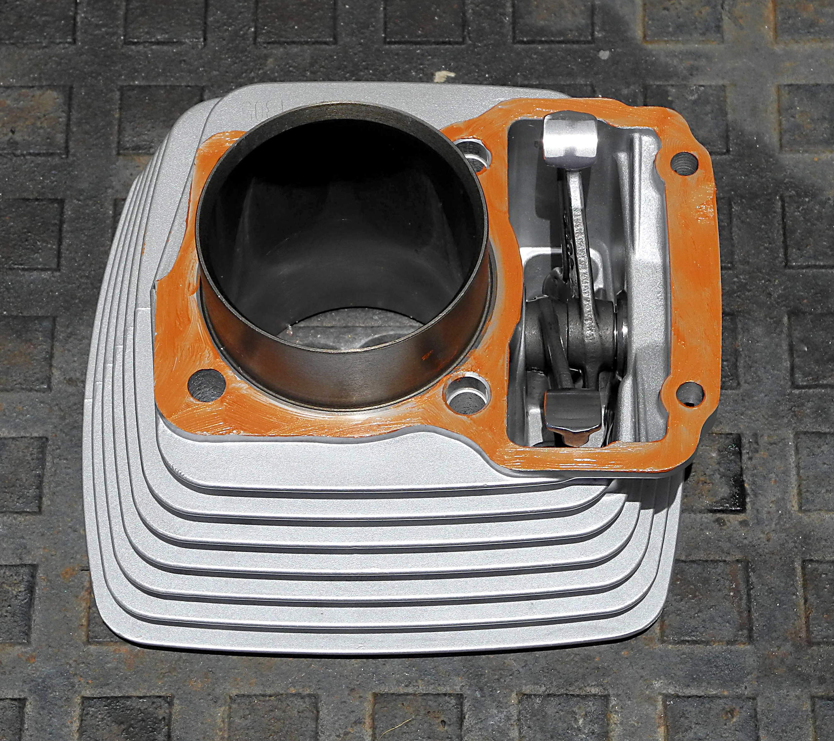

Smear a very light coat of silcon sealant on cylinder mating surface, if you are not using a base gasket:
After cleaning any gasket remains from crankcase and replacing dowels, lightly oil the cylinder and carefully slide into place over the piston (remove the stuffing when the rings are inside the cylinder):
Position head gasket and top dowels:

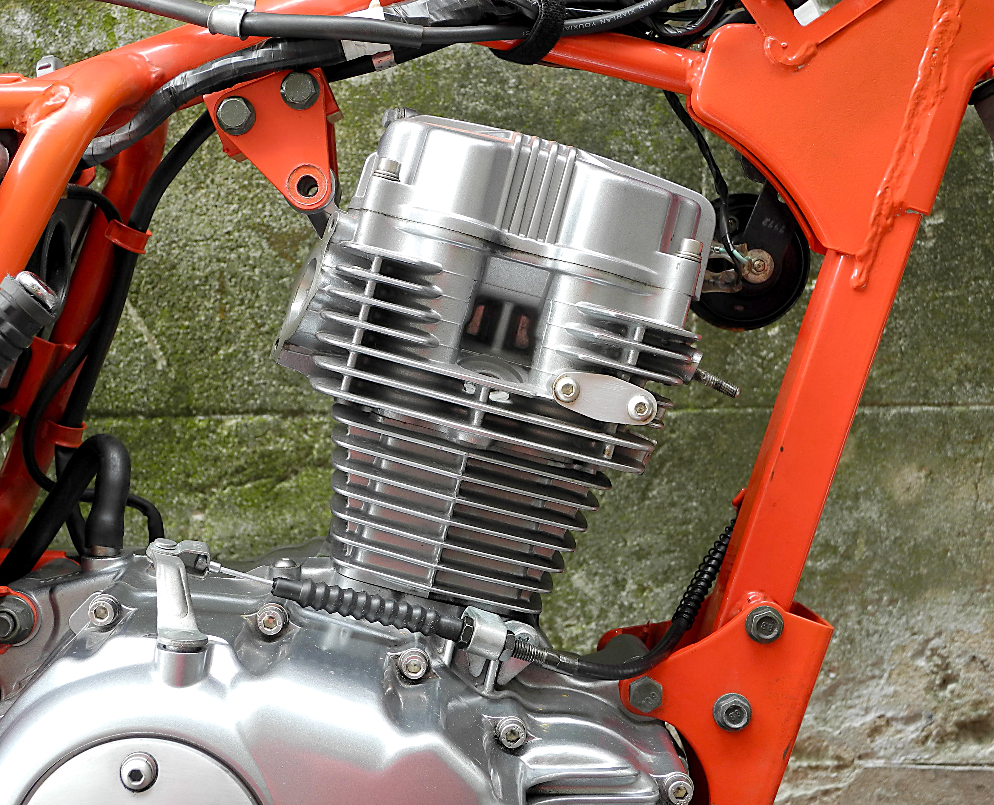

Bolt head in place (20–22lbf. or 28–30n/m) and replace cam locating bolt (13–16.5 lbf.). Be very careful when replacing the pushrods – angle them toward the outside corner and rock the cam using the kick-start lever to ensure contact. If not positioned correctly they will drop into the motor, necessitating the removal of the head and cylinder in order to retrieve them:

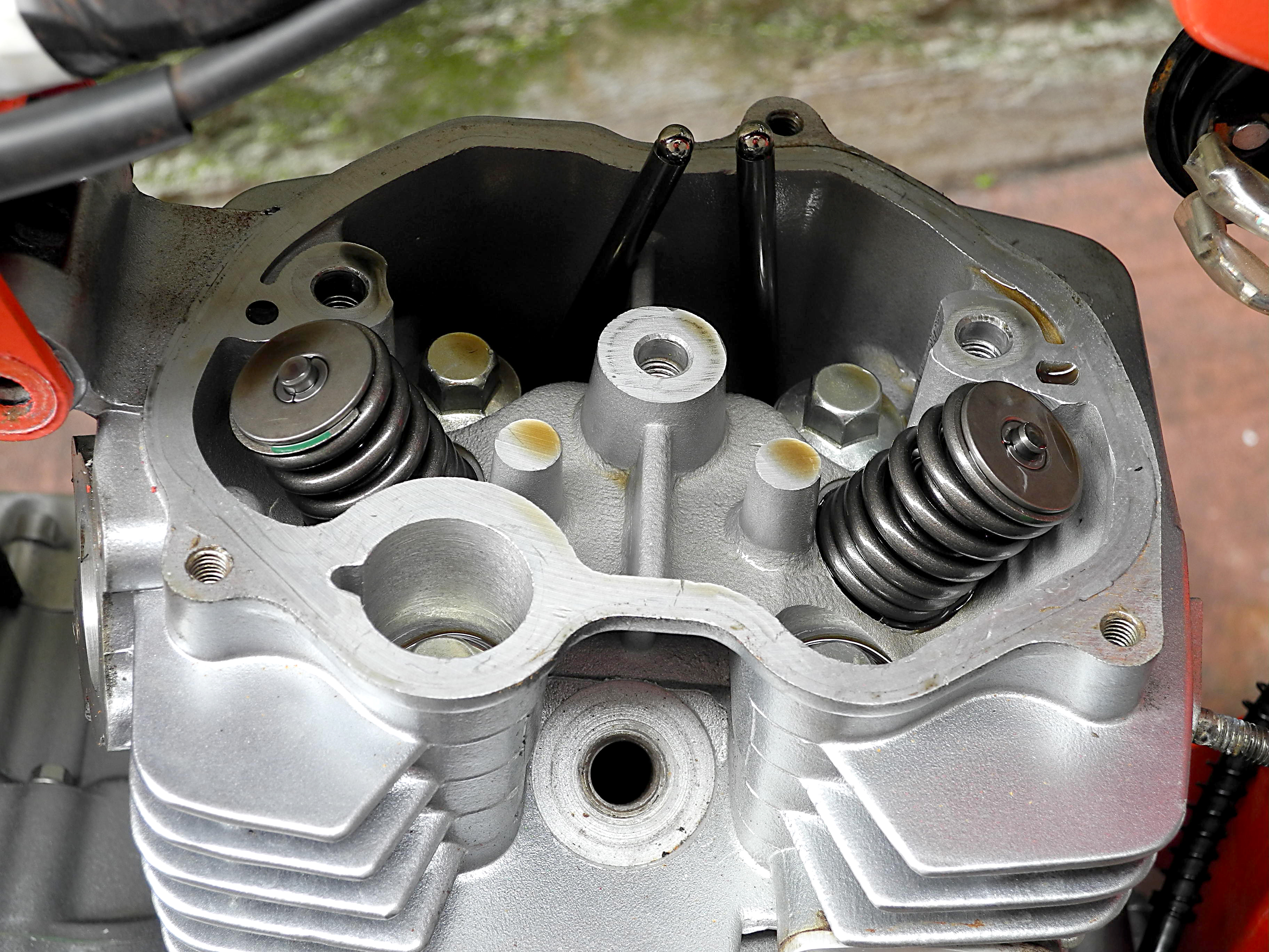

Replace rocker assembly:
Replace engine mounting bolts (8mm 22.5–27.5 n/m)
Adjust valve clearances – intake 0.1mm (0.004˝), exhaust 0.15mm (0.006˝). For correct TDC inlet valve should be closing as piston rises.

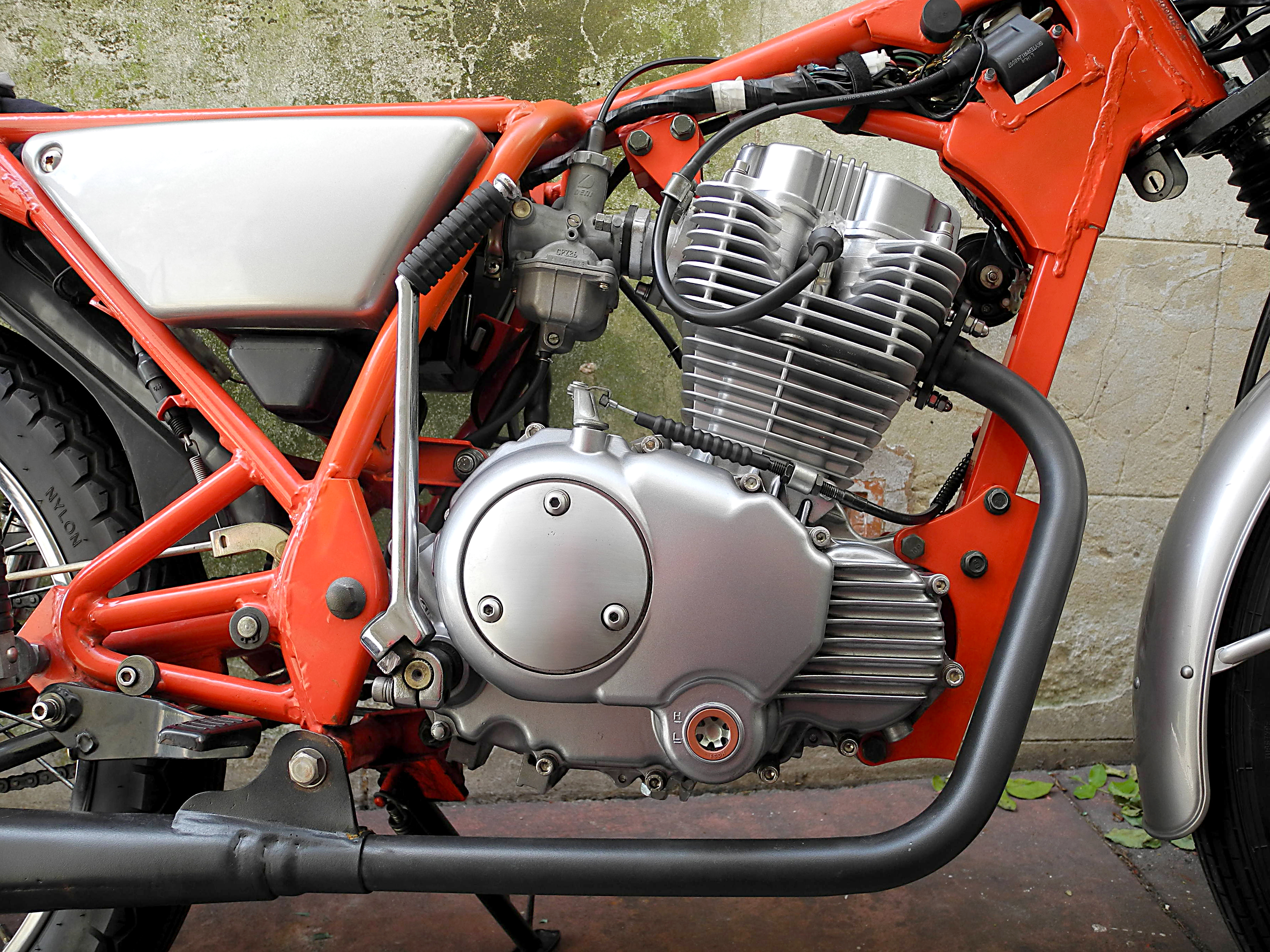

Replace tappet cover, refit head steady, carby, spark plug, horn, tank, etc.

Did you need to use a piston ring compressor or does the bore slot over the piston easily? Dis you get the kit from OORacing?
Wayne
Offline stroker crazy
  • Posts: 4437
  • crazy as a fox
Re: Lifan 150cc big-bore kit: Installation
« Reply #4 on: Jan 02, 2014, 07:34:45 »
No, you don't need a ring compressor and yes, it's the OORacing kit.
