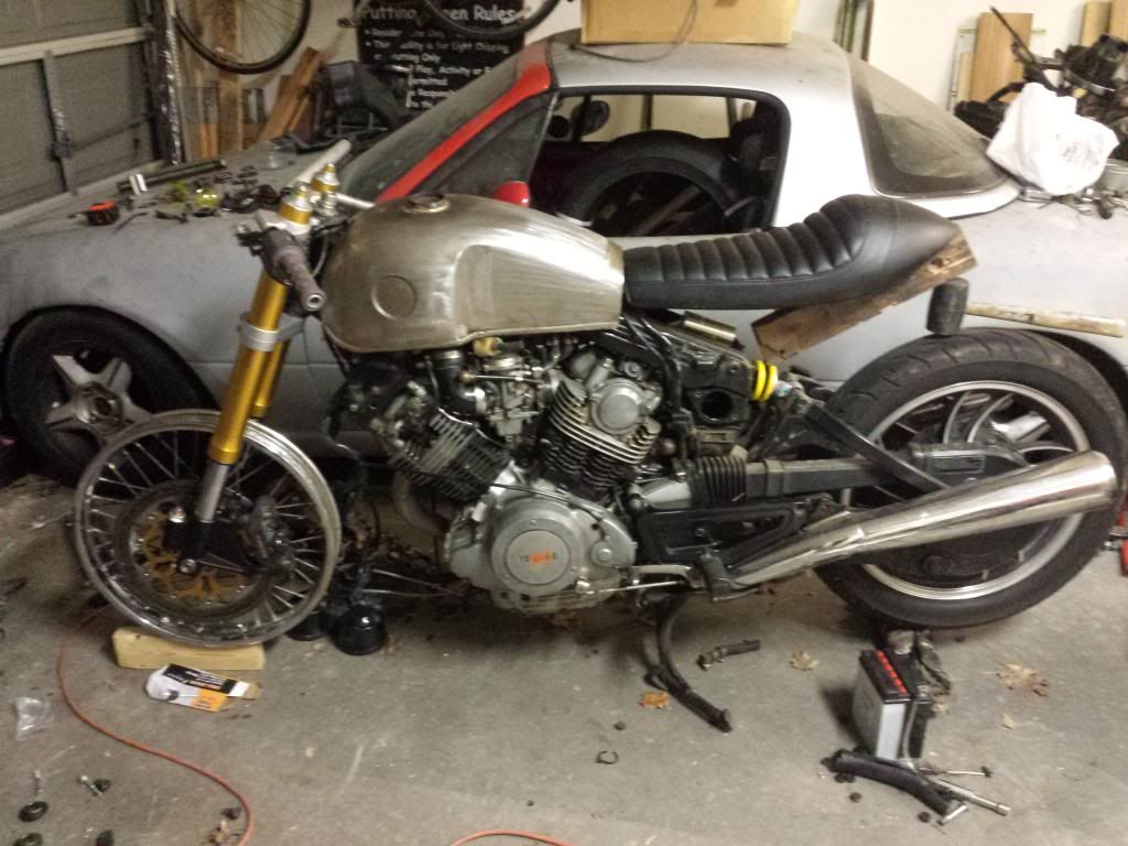

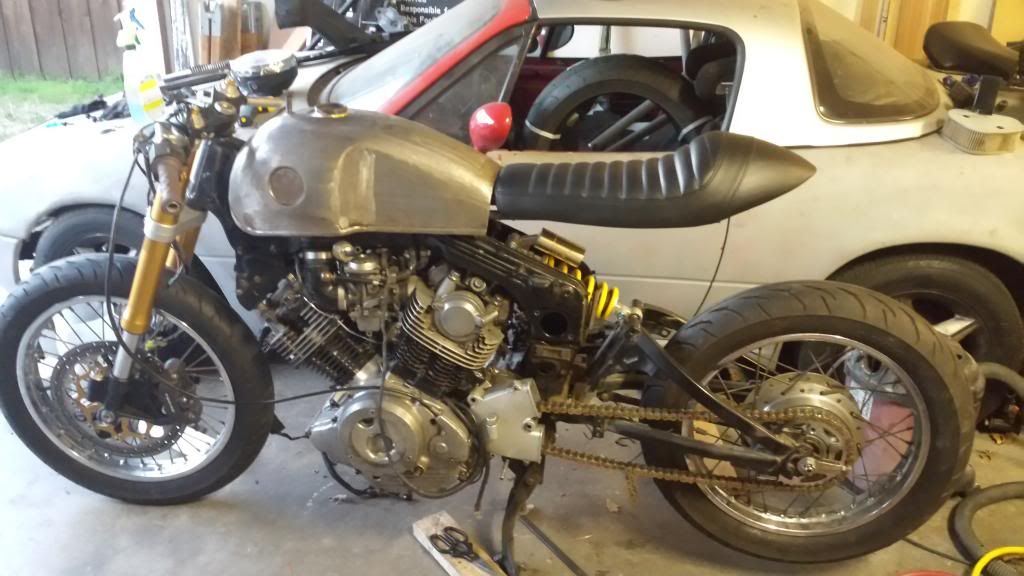

So I I figured it was time for me to start a build thread. Virago's being all the craze these days I couldn't help but try my hand at one when I found a nice deal on a '81 XV920R chain drive. Might as well be taken from different pages of the same cookbook I know (Benelli tank, motolana seat, spoke wheels).
The fun part is the R6 forks with spoke wheels, r1 rear shock. At some point I plan on getting some sumo rims to lace to my hubs, but the wheels I got fit the tires already on it so for now I'm sticking with them.
The day I got her. Bought it from the coolest old dude that lived out in the boonies. Of course it was labeled "Beast"...
My now ever growing collection...
Started to strip the her down.
Got a pair of stem bearings from AllBalls and pressed out the stem from my 07 R6 forks I scored cheap on craigslist, turned it down 1mm, and stuck them on.
For wheels I bought a set off a TX500 which the front hub is as far as I can tell the same as a xs650 (for a heck of a lot less money on ebay). I'm going with a single floating disk off a Ducati 748S. The center bore and bolt holes are perfect (idk why), but the rotor spacing is completely wrong so I turned a hubcentric spacer:
Also turned a couple bearing spacers to align the wheel in the forks.
Started mocking up the rear R1 shock (which should be about right on the spring rate). Also threw the Benelli tank on there for good measure. Caliper is off a GSXR. I'll probably put a R6 caliper on it at some point, but I'll have to make some spacers to get one to fit. Since the r6 has 310mm rotors, the gsxr has 320 (like the Ducati) and the calipers otherwise bolt into place. I have r6 calipers on my gsxr forks on another bike, but it took some spacers to make it work. Yes I know the caliper is for the wrong side, just mocking it up.

And a crappy seat mockup.

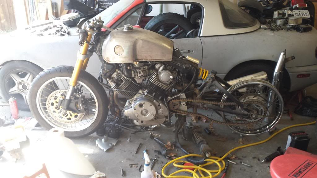

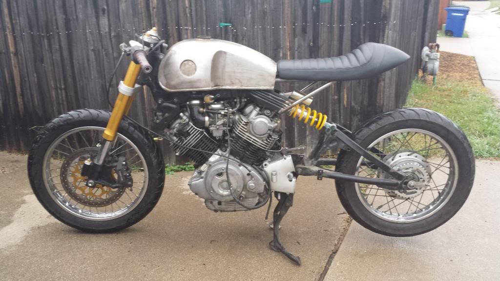

Got the front tire swapped from the swirly mag onto the spoke wheel.
mocking up the rear wheel

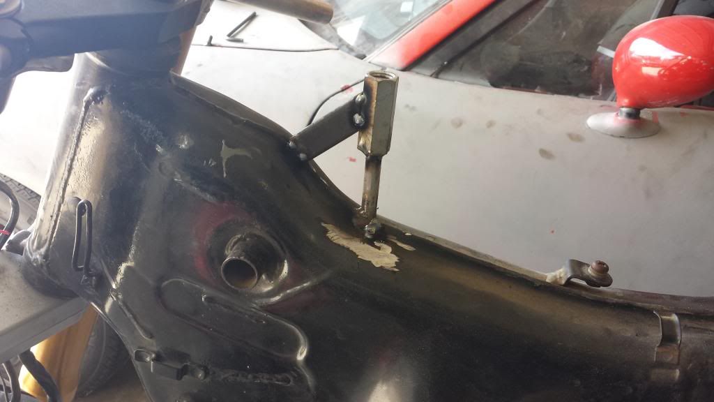

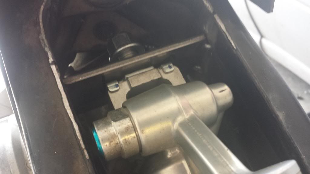

How I'm mounting the shock. I'm going to gusset this more, but for now I just have the mount tacked into place.

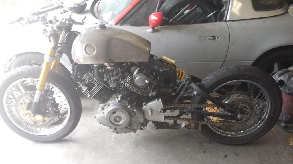

Finally got her sitting on her own suspension
Once I had the bike sitting at the stance I wanted, I could plan my tank and seat angles.
Front tank mount was easy. I actually have it mounted with 2 more gussets to the rear not pictured. It's probably overkill, but it's solid.
Subframe started to get the seat on it. I need to take some more pictures of the subframe, but you get the idea. I also chopped the frame. The rear of the tank is sitting lower than it will since I don't have the rear tank mount completely done.

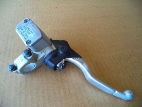

Brakes. I ordered a Brembo brake master off of a KTM dirtbike that is a 11mm bore that should be just about right with the single R6 caliper.

 what wiil you use to replace the frame you cut out ?

Yeah, there has to be at least a dozen I've seen (didn't know this when I got the thing). But then again how many CB's are there lol.
I'm not planning to tie the frame together, I'm chopping the frame similarly to how Sepp Koch has been doing it for a few years. Some people have arguments both ways on weather that's a wise decision but the damage is done and I like the look. if it proves to be unstable I'll tie it back together somehow.
One challenge with that is running wiring from the starter and crankcase up to the under-seat area.
The air filter I plan on running in front of the tank on the left side. I'll try to take some pictures of where I mean. I don't want to run single pods on the carbs since it's so hard to tune these things in the first place. Running a HD cv carb would be cool, but I've heard it suffers on the top end. Wonder if anyone's used something like SV650 carbs.
« Last Edit: May 16, 2014, 12:35:34 by claytonisbob »

 it is a great looking bike
what you are doing is putting 100% of all the suspension loading, front and rear , thru the engine castings
they were never designed for anywhere near all those loads a certain % yes but not 100%
 it all depends I am sure on whether you ride hard and put on a lot of miles
it will definitely flex more which usually adversely effects handling
if you do a lot of miles and on rougher roads eventually it mayfail in an ugly manner
think about twisting a piece of steel bailing wire until it breaks takes quite a while
 well aluminum castings are  way way worse in huge way when it comes to that type of failure from flexing
in the meantime be prepared for oil/head gasket leaks as the constantly varying loads will be shifting the engine at its joints
good luck
