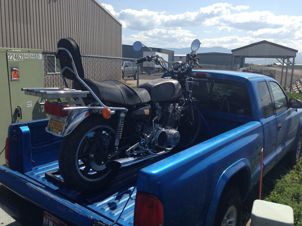

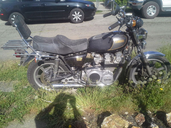

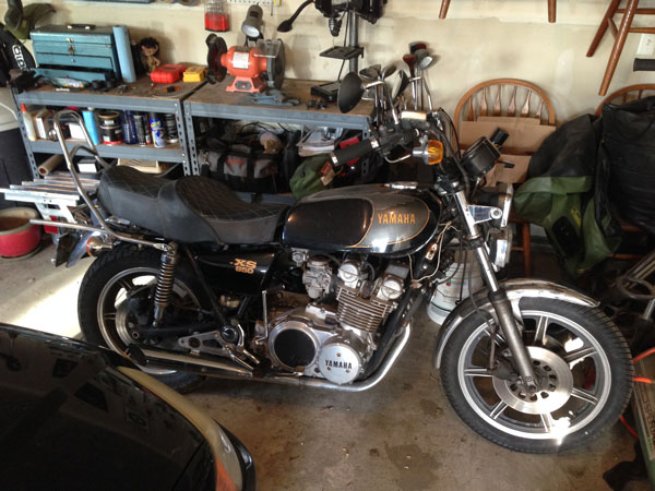

First few pictures of the day I got it, getting it home, and the first day in my garage. Luggage rack and sissy bar are already gone and the seat and tank have been pulled.

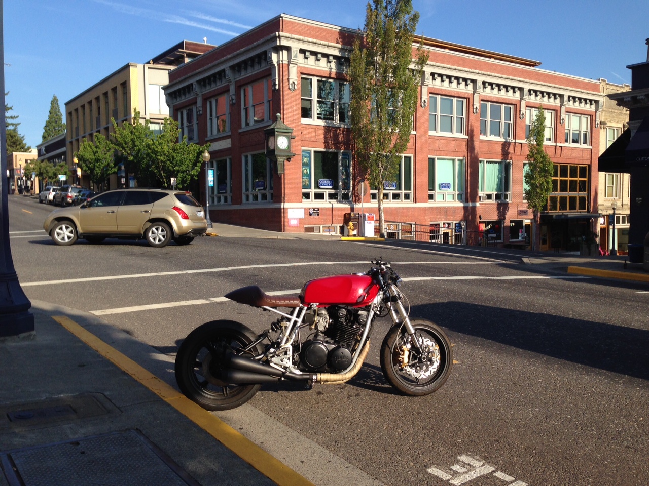

Last few pictures are how she looks today.

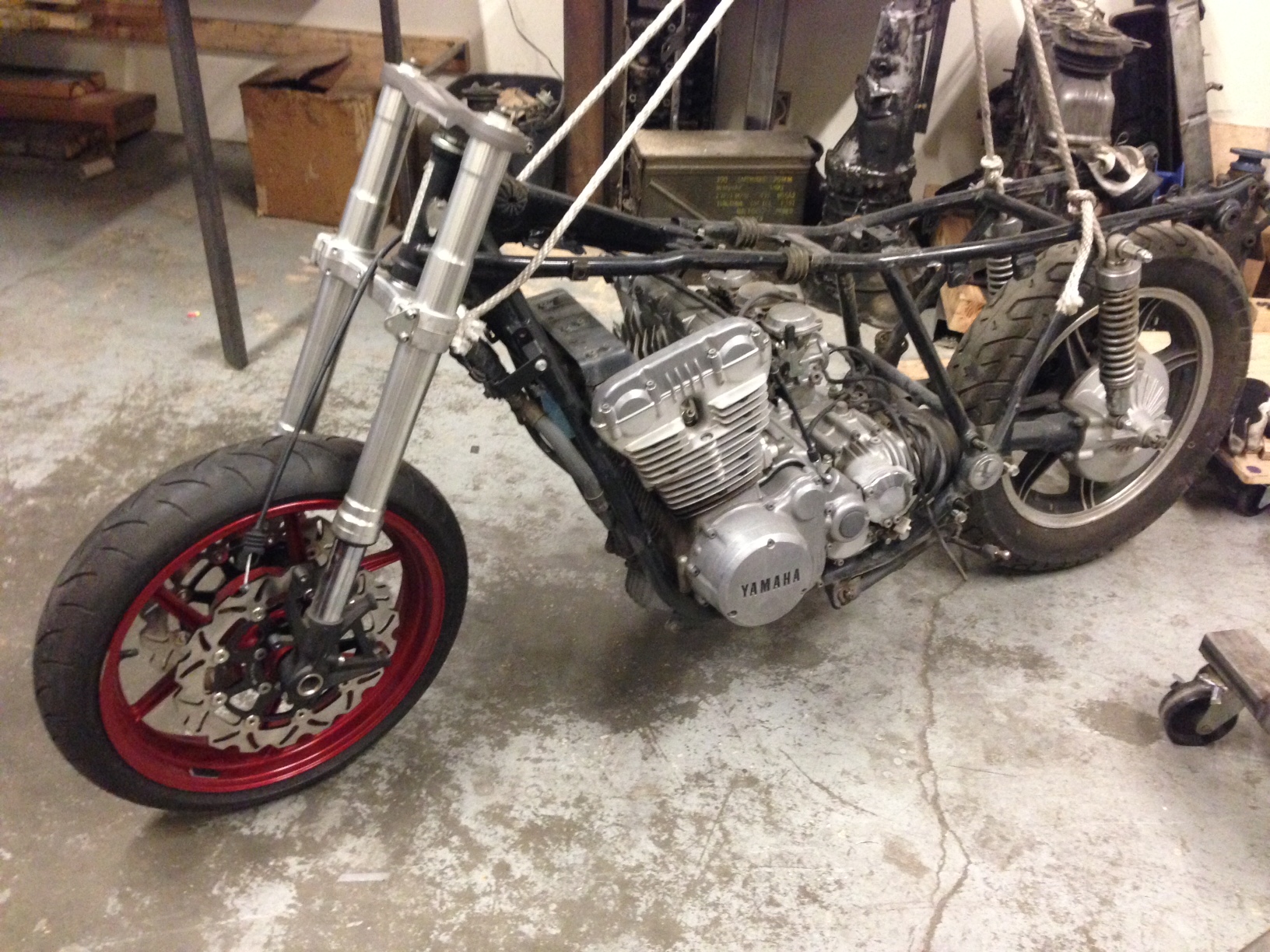

So I know there are some haters... but for everyone else, here's a front end and mono-shock update.
Love how it's coming together. Next up, rear sets.

Wow that rear end shot is stunning!
Thank you sir. More to come!
