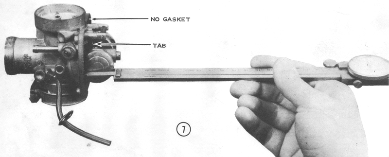

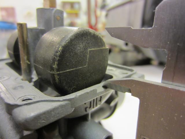

so after a good clean up of my RD carbs im no setting them to standard float height.
the manual says that i should measure from the area where the gasket of the float chamber sits....
the picture in the manual shows the carb lying upside down (like in my pic) is this right the way i measure it with my sliding gauge?
manual says 23 MM plus 2,5 MM....i set it to 23 MM is this ok for a first start up or do you guys have any experiences on float heights on the first start up?

You should have a depth gauge at the other end of your vernier calipers. I find it easier to do it that way:
It should be +/- 2.5mm.....so 23mm would be in the "middle" which is where you should start.

thanks hillsy!so the orientation of the carb (like in my pic is right?)

Your measurement technique is fine, as long as you are measuring from the gasket mating surface and not the top of the lip that locates the gasket. Using the depth gage part of your caliper is probably more foolproof. I like the carbs upside down for this, but there is the notion that the little spring in the needle gets compressed afflicting accuracy.
This style carb with the floats that slide independently on vertical shafts have an important issue to keep in mind, especially if there is a lot of miles in them.
First, the shafts must be absolutely flawless with no evidence of wear. In operation, the floats live at nearly the same place all the time, and vibration wears parts in that particular spot. The effort that the floats exert towards shutting off the fuel when the level is high enough is very tiny, and it takes incredibly little to hang the mechanism so that the carb weeps or even pours fuel through the vents as if the needle and seat were bad or stuck.
The shafts are very hard in your RD's bowls, and not likely to have a problem, but check carefully.
Second, and this is far more common, the brass arm that the floats push against wear where the little pin in the float contacts it. There can be a (sometimes very) perceptible little groove there that will try to lock that pin in place and cause the needle and seat to hang up slightly. I think a lot of needle and seat assemblies are blamed for leaking (in this style carb) when it is actually the mechanism. I learned this on a pair of 34mm TZ carbs that I just couldn't make stop having an overflow problem. The brass arms did have wear, and as an act of desperation, I smoothed out all the wear on the arms and the little tab that contacts the needle, and BAM. Instantly solved! Since then, that's one of the first things I look for if the floats stick, and it turns out to surprisingly often to be the problem. I sand out any trace of wear with #600 sandpaper and smooth that out with #1000. Harder than it sounds actually. I can't remember the last time I needed a new needle and seat; I do this regardless on a "new" bike, and now actually EXPECT the carbs to never overflow. Get some genuine Mikuni bowl gaskets and I can almost guarantee you will never see a drop of fuel.
I do not use pre-mix on new engines (unless they have no pump of course!). Assuming you have cleaned the carbs (emulsion tubes out, flawless jet of carb cleaner from all holes and passageways, etc.), and have all authentic Mikuni parts (if you have used an aftermarket kit, take your carbs back apart, throw away all the aftermarket parts, and put back the originals or get new), your RD should be fine. Make sure the float bowls are on the correct carb (one has a drilling in the bottom for the fuel enricher (choke)). Don't forget the little hose that connects the choke between the carbs. Turn the air screws out 1 1/2 turns. Pull the oil lines off the carbs. Bleed the oil pump, then hold the throttle wide open and turn the pump by hand until you see heavy ooze of oil on each stroke of the pump (the two lines alternate on pump strokes) from each carb fitting and no air. If you have just assembled the motor, there should be plenty of oil from putting it together. Put the oil lines back in the carbs, and start the motor. If you are concerned, you can reach down and pull the oil pump cable to hold the pump at max rich for a bit. Once it is warmed up and running ok, you can pull each carb oil fitting out briefly one at a time while the engine is running to check that oil is pumping ok. You won't hurt anything in the short time this check will take.

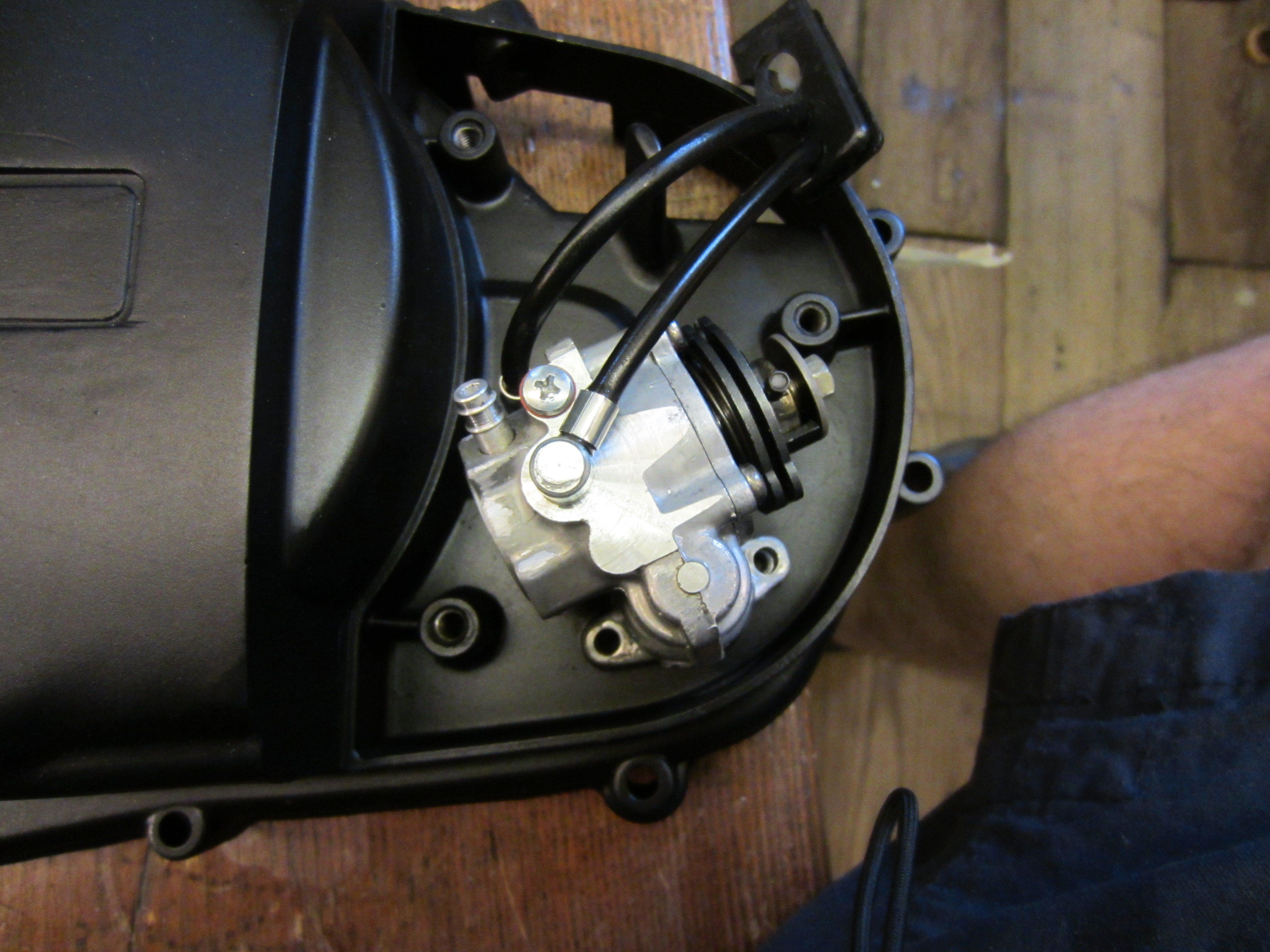

how do i bleed the oil pump?i guess the philipps screw with the orange seal is the bleeding screw.
i would put 2 stroke oil in the side tank and then manually repeatedly twisted the throttle with the motor not running till only bubble free oil would come out of the 2 hoses for the carb.

The oil pump is easy to bleed but messy. Obviously make sure there is plenty of oil in the tank, and remove the bleed screw (yes, in your pic, the one with the red fiber washer on it. These can be really tight, so get a new #2 phillips ( or JIS) driver and don't let it slip. DO NOT use a hand impact driver (the kind you use with a hammer) on the oil pump! If oil does not immediately come out, it will eventually. Hold the throttle wide open, and turn the nylon thumb wheel (looks like a gear on the bottom of the pump, it only goes around one way) about a million times or until no more air bubbles come out of the hole. I think if you just let it sit by itself for 5 minutes with the bleed screw out you achieve the same thing. Put the bleed screw back in, and thats it. You can bleed the lines to the carbs too as I described in the previous post, but likely you will have already achieved that bleeding the pump itself.

since this is a post 1976 model of the RD there is no nylon thumb wheel...only the philipps bleeding screw.
what i thought is that i maybe could spin the plastic wheel inside of the engine case (which grasps the primary gear) while the yet "empty" oil pump is connected to the oil tank....but since i already mounted the engine case and put fresh motor oil in i dont want to remove the case.
so my idea would be to open up the philipps screw connect the oil tank,wait till the oil is sucked down,maybe use my vaccum pump brake bleeding tool to suck it down to the pump....but how do i get the oil up in the 2 carb oil hoses?
the motor is in neutral...i could spin the generator in order to spin the primary to "activate" the pump...but my fear is that the fresh pistons I installed (with 2 stroke oil in the cylinders) will lose all their oil while i do this procedure.....

Well, it certainly is a nuisance there is no manual means to run the pump. I have had them leak at that seal, so maybe that is why Yamaha deleted it. Regardless, it won't be practical to "prime" it by turning the engine by hand. It is pretty heavily gear reduced. It is a pain with the thumb wheel, but 10 times faster than if you turned the gear from behind. I suppose that it is possible, just ridiculously time consuming. I think if it were me, I would make up about a liter of pre-mix fuel, and use that to start the engine and let it run the pump until all the air is gone. A couple points to keep in mind: If you assembled your engine like most people, you used plenty of 2-stroke oil putting it together. That usually makes a pretty good surplus of oil inside the crankcase, and you could likely run it for long enough to purge the oil system without concern anyway, but it pays to be careful. The oil pump pretty much fills up by gravity, and the bleed screw being at the top lets nearly all the air out without turning it. You could check it again the next day to see if any air made it's way to the top. That leaves just the lines to the carbs that really need to be filled by the pump. With the engine idling, you can manually reach down and pull the throttle cable housing to the oil pump to make the pump run wide open without increasing the engine speed. The carb feed lines fill up very quickly when you do this. So make up a little batch of pre-mix and have peace of mind that you will have plenty of oil. If you are running clear lines, you will see when the oil is getting to the engine. If solid lines, just pull out the injector nozzle out of the carb to see it is working. Once you know all is well, fill the tank with straight gas. Just leave your liter of pre-mix in there. a little extra oil won't hurt anything except the plugs, and you will go through several sets of those anyway getting the engine tuned. Then once you are riding the bike, run it almost empty and when you fill up again, you will have very little oil in the gas tank. Remember, the pump works with a piston inside that delivers oil in little pulses, and that is what you need to see to know it is working. Check both lines. The pumps are super reliable, and the only likely problems are the pump not getting oil for some obvious reason, or the check valves sticking. When the pumps sit for a while, sometimes the check balls stick. The check balls are directly under the pressed in brass fittings the carb lines connect to. Don't take them apart unless you know the pump is full and no oil pumps out. It is very unlikely you will have this problem unless your pump has been inactive for a really long time. One last thing: Yamaha set their pumps rich to start, and leaned them out at the first service interval. This is done with little brass shims on top of the cable pulley, which increases or decreases the pump stroke. You'll have to look at the service manual for your bike to know for sure what shims are needed. Most of the bikes I see still have the "rich" shims still installed, so likely not an issue. If you are worried, you can always add a couple of shots of oil to your tank during break in for peace of mind.

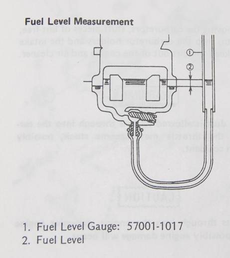

The "correct" way to measure float height is to tilt the carb until the float tang just starts to touch the spring loaded pin. Usually at their sides is OK but never upside down. If the pin is pressed in by the weight of the float, the adjustment will be way too low when it's full of fuel the right way up.
The better way to set fuel level is to do that and not the float level. Fuel should be 3mm +/- 1mm below that gasket surface and can only be measured by connecting and external tell tale. You can probably make up a float bowl drain screw with a pipe in it to place at the side of the carb to see what the fuel level actually is.
