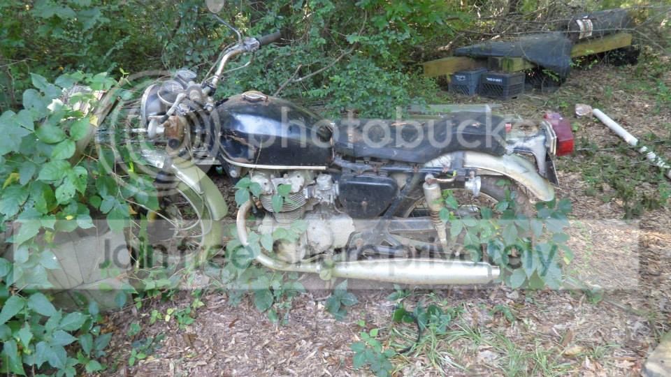

Hopefully this afternoon I can zip over to the "New Members" section and introduce myself properly. So I'll keep this thread about the bike... I've been wanting to do a brat/cafe project for years, and over the winter I was able to get my hands on this little beauty. :p ($75 sounded fair to me, I could scrap it for that)
I brought it home, stuck it on my messy pad behind my shed and I (and my son) started ripping it apart (carefully, of course).
Once I had her all torn down, I found a few surprises. The engine is none other than a Honda 500T engine. BUT... It's sitting on a 1973 CB450 frame, and has what appears to be a CL350 front end (forks and wheel). Since I am not taking it back to stock, I just smiled, shrugged and moved on with the build. ;D

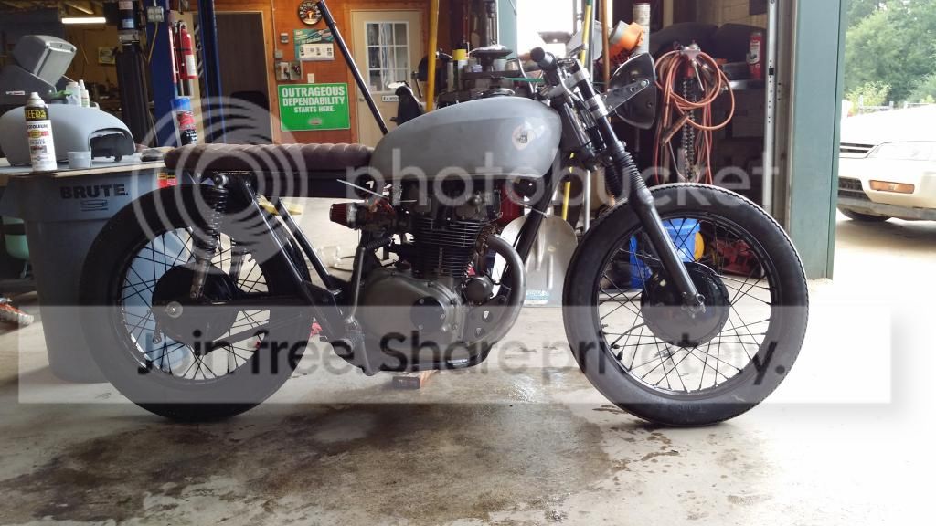

Here's a single pic update from my work over the past couple days. Lots of stuff that a pic can't show, but the seat is mounted... :) The tank needs a bit of adjusting to line up with the frame, but I'll work on that a bit later.
coming along nicely
those shocks wont work though unless you weld them solid,you haven't left any clearance to the seat
xb33bsa said:
coming along nicely
I was worried about the same thing... And I guess it might still turn into an issue. But apparently those shocks are HARD! I sat my 200lb frame down on that seat and bounced as hard as I could and couldn't get the seat to touch the tire. (Literally jumped up in the air and landed on the seat!) So I put my 70lb son on there with me, and then when I jumped really hard I could just barely get it to contact. I'm going to have a fender mounted to the bottom of the seat, and I'll keep you posted on how it's working out. If it becomes an issue, I guess it'll become a hardtail. :p
bouncing on the bike is not like hitting a pothole at speed,it will hit unless you restrict the shock travel
copying a show bike not meant to be ridden has its drawbacks
you really should just do it right,no ?

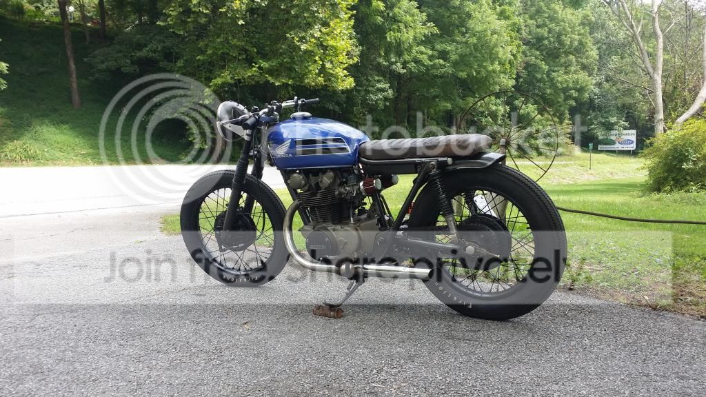

Ok, guys... I'm SO sorry that I've left this post die. I've finished my bike (at least for now) and owe all of you pictures. In reply to the last post, the seat pattern is just 1 inch stripes across it. So, I went on a ride up at Blood Mountain in north GA, and took these pictures. Please give me your input as I may be working on it more this winter and am always open to suggestions!!!
It looks great!
I would be worried about crashing when the rear tire stops turning when it hits the fender, but if you're going to somehow avoid that, you've got a sweet bike!
-Sherm
I've gotten a bunch of comments on that rear tire being too close. I have super stiff springs, and haven't had trouble with it at this point. I've put a bit over 500 miles, several of which were mountain riding. But I'll continue to watch out for it. Thanks for the comment!
Cool Bike.
If it doesn't hit, it rides like shit. Or you are a VERY conservative rider. You really should change it because the way it lets you know it's wrong is not a good way.
Be hard headed, but I sure hope you don't ride with passengers. They should not have to suffer from your ignorance.
