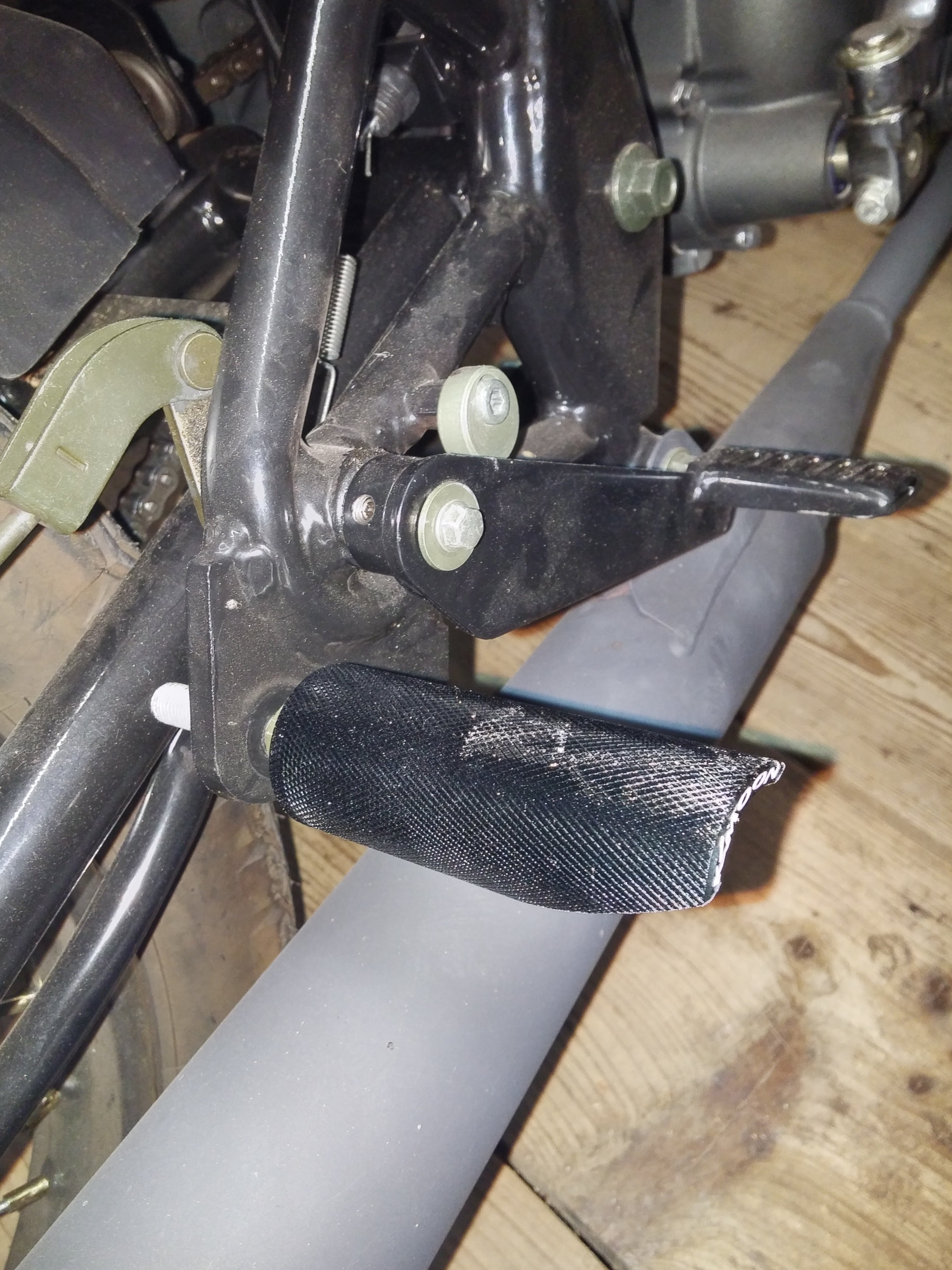

Hi Rob, here you go. hope this helps.

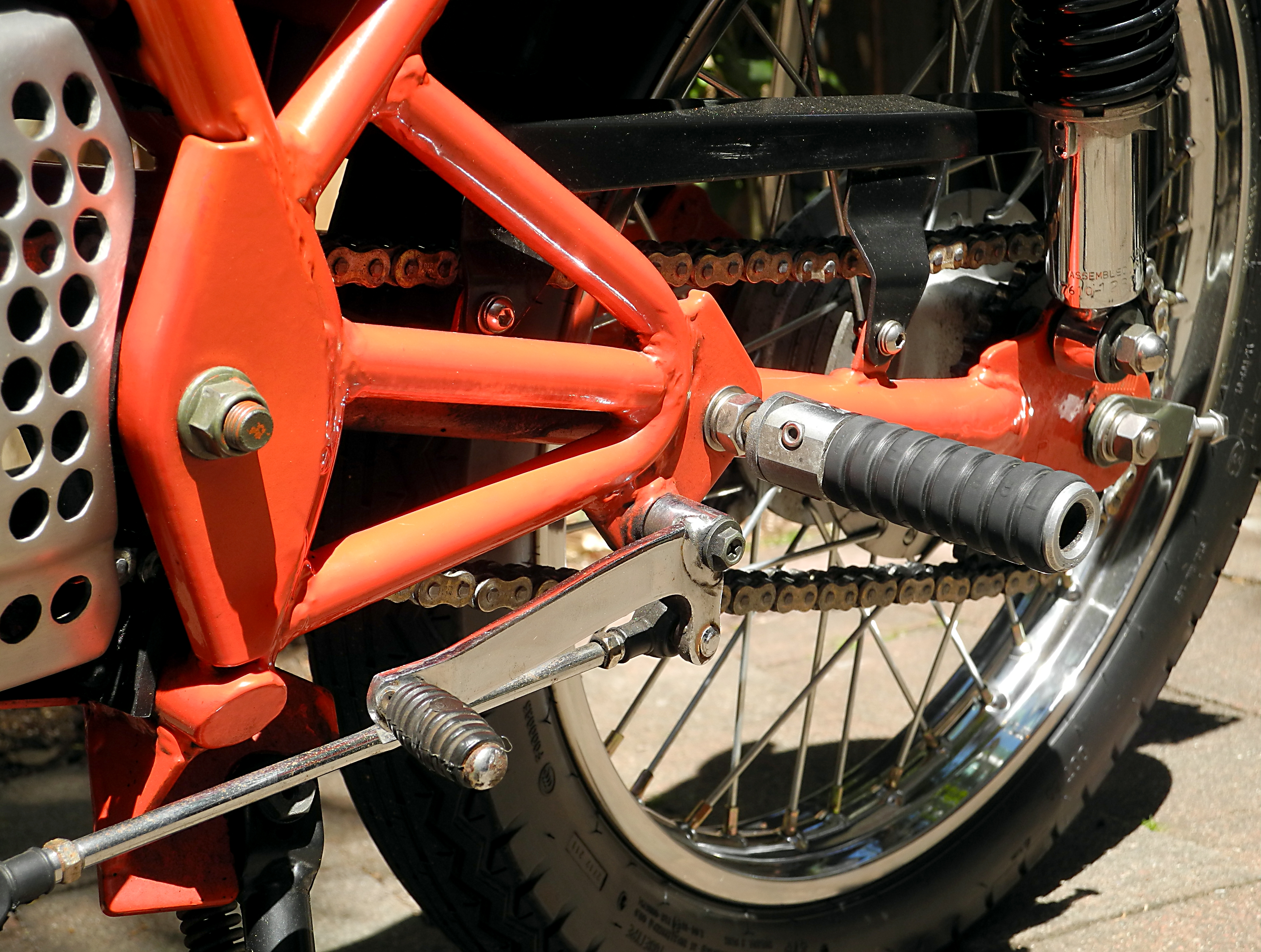

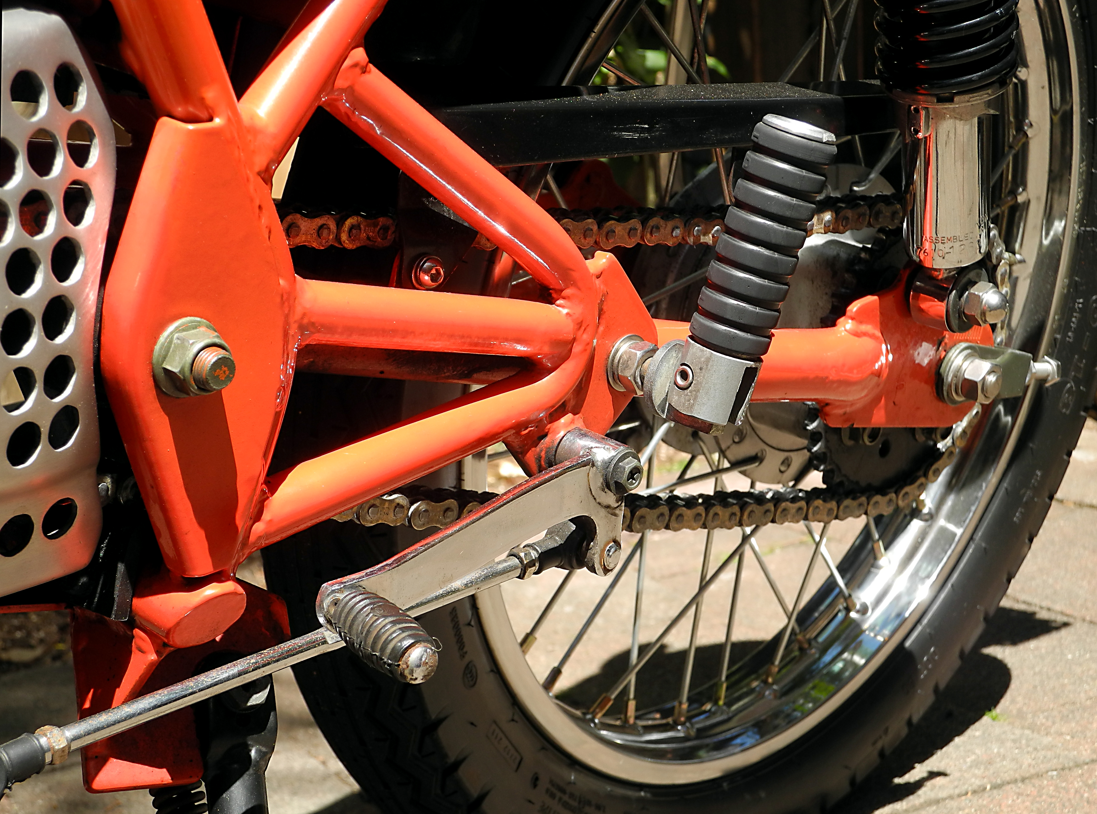

I used a set of Tarozzi folding pegs; very sturdy and suit the period:

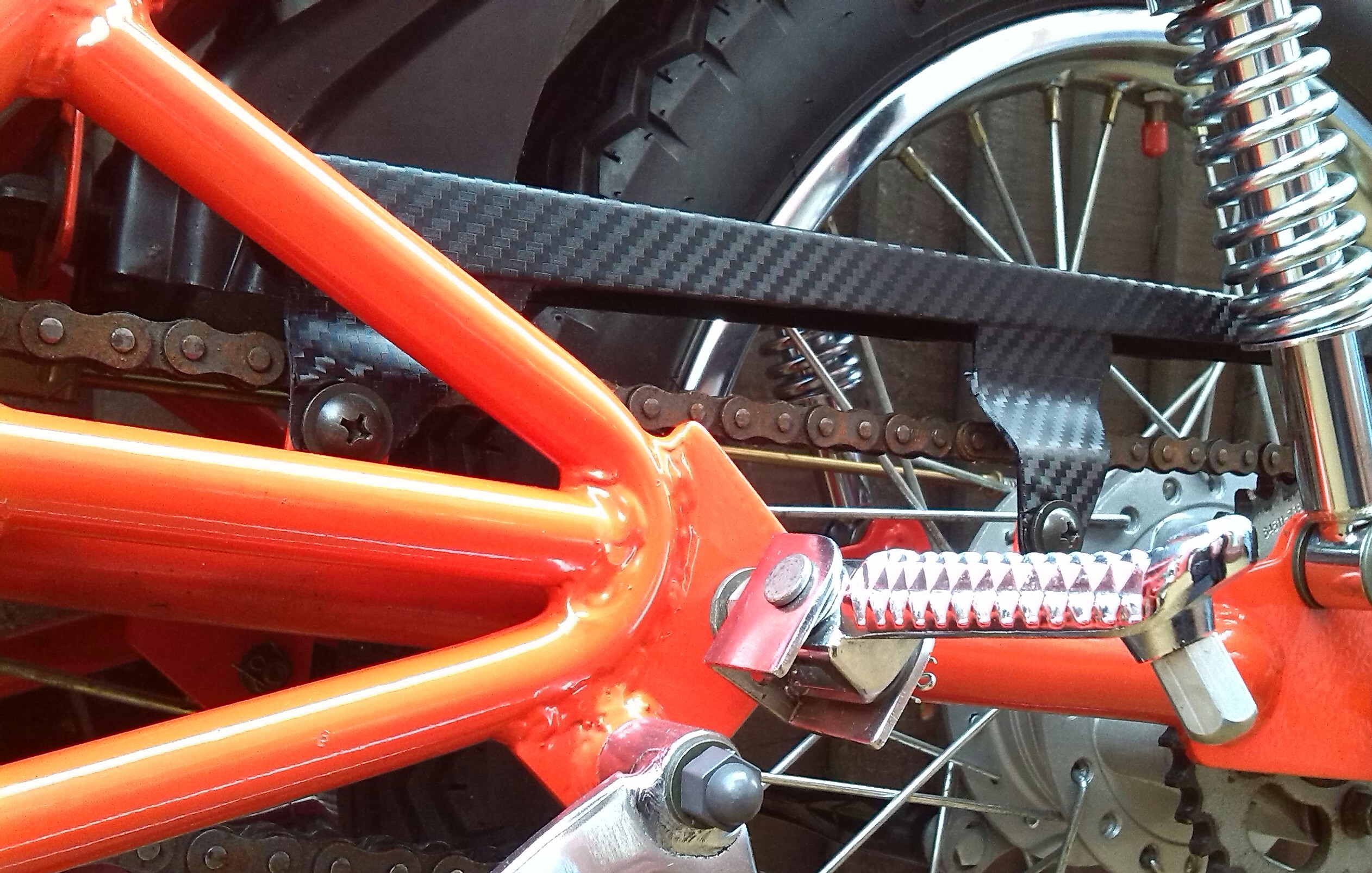

I ordered these pair in black for my black ace:
