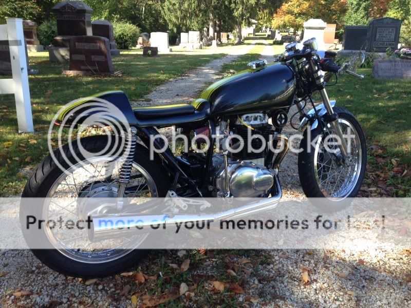

« Reply #9 on: Jul 04, 2016, 15:02:04 »
So... while I've got T120R parts out for service and after a year of disgust and cussing this bike. I must have had a clogged oil passage to the left side of the head. The thing ran dry and ground my rocker arms and cam down on that side... that sucked. So I let it sit all year last year while I worked on the XS650 and T120R. I got fired up this weekend and tore the top end of the motor apart and rebuilt it using top end parts from my parts motor. (Head, cam, rocker box, new valve seals, lapped the valves, made damn sure my oil passages were clear.)... Ditched the Mac exhaust and mocked up the Scrambler exhaust. I'm still planning to use the Mikuni Carbs, the bike was running great until that oil issue... I ordered a new throttle and cable with 90 degree ends at the carb... those carbs are huge and there's not a  whole lot of clearance between the top of the carb and the frame/tank. 90 degree connectors should help that.
Next steps...
* Fit the the new throttle and cable to the carbs
* Blast and powder coat the heat shield
* Wire wheel / sand exhaust and paint it. (Flat black pipes + gloss black shield should look trick..)
* Drain oil and clean out the oil filter and screen
* Re-assemble the side cover and add fresh oil
* Test fire it and see if the straight through extended scrambler pipes are gonna work well.
Here's an obligatory pic of the bike in its transitional state.
