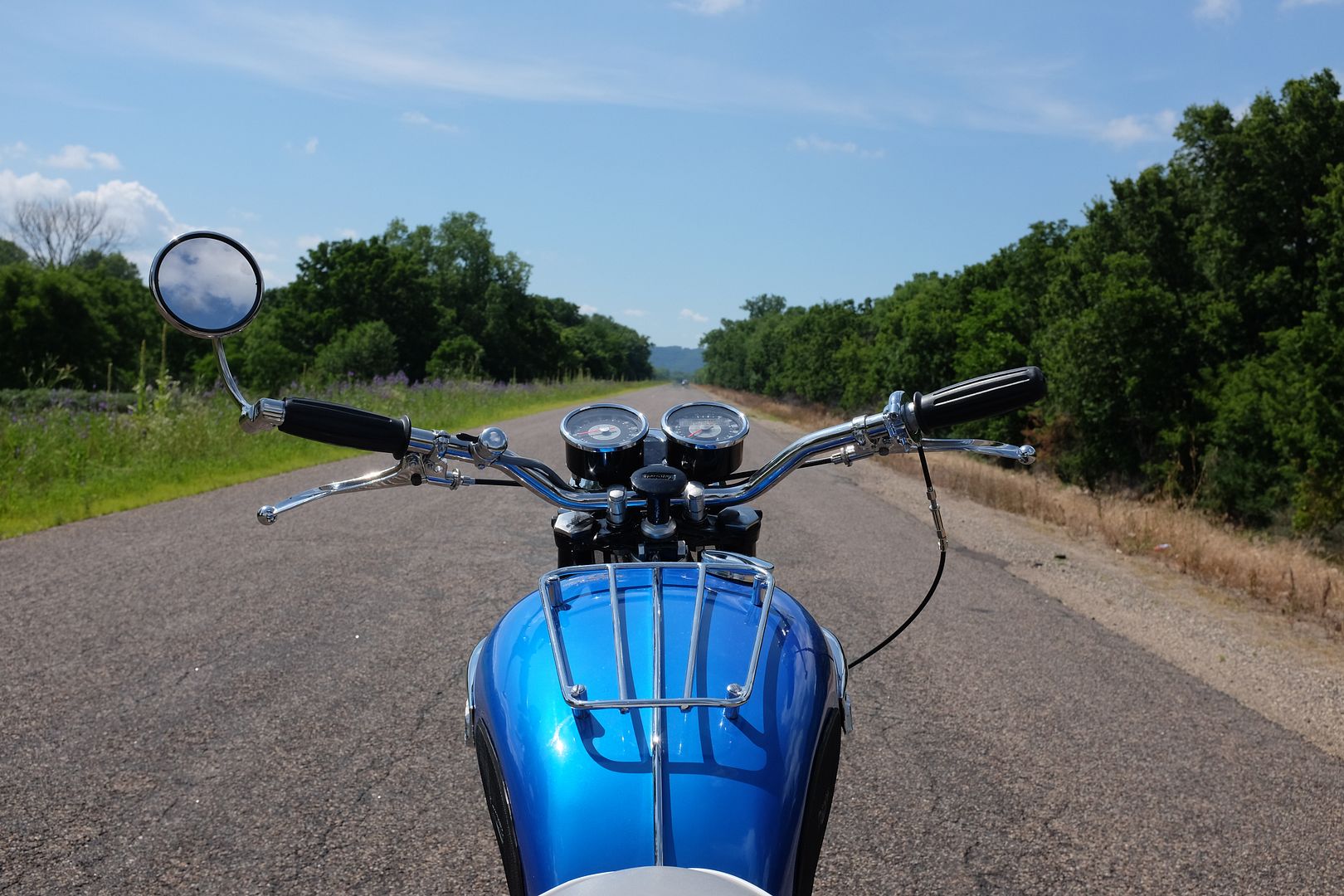

225 miles and all is good, almost. My bike starts, runs, and rides beautifully. Had a group ride this weekend with old friends, we bombed the back roads, and my bike ran perfectly. The only issue so far is that the odometer stopped working but the trip odometer is still recording mileage. The UK made speedo cable is tight and properly lubricated so it must be the internal parts of the speedo. I emailed the person who restored my gauges about the problem and I'll wait for his response.
Initially, I had intermittent noise around the top end and I finally discovered the source. One of the exhaust pipes was rubbing on the exhaust stub after it warmed up. It only happened at certain rpms so it was not the tappets, rocker spindles, etc. Of course I broke another cooling fin by tightening it too much. I used lock wire from the head to a new cooling fin and the noise is gone but I would like to find a better solution than lock wire.
I plan to change the primary oil tonight and tighten up the clutch springs because it slips a little when I really hit the throttle. The weather is perfect and I want to ride her as much as possible.
