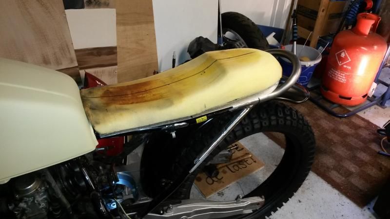

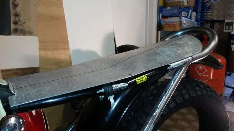

Seat update:
Using my knee I made a hump...
..and shaved a stock seat foam down to size. The original seat is mint and I didn't feel like hacking it about, so I bought a cheap split seat to play with. An electric carving knife cuts foam cleanly enough, and 80 grit paper smoothes it nicely.
Half n half...
I'm liking the overall shape.
My first attempt at beading....pleased with it to be honest.
The clamping strip is only partway done, it's there to hold the leather when I have it upholstered.
As I'm using real leather for the cover I thought to add a water proof layer....turns out a yoga mat is ideal  :D
To position the seat I used the stock subframe bridge, opened out two holes enough to accommodate two bungs (off a VW splitscreen) to locate the seat. Just need to figure a fixing system of some kind, might even use the stock lock mechanism?...of a simple bolt and wing nut through one of the other holes in the bridge.
More to follow....
