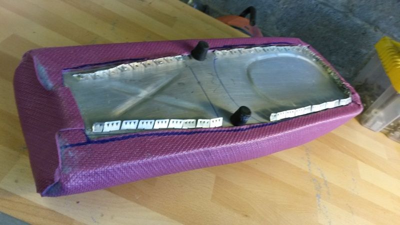

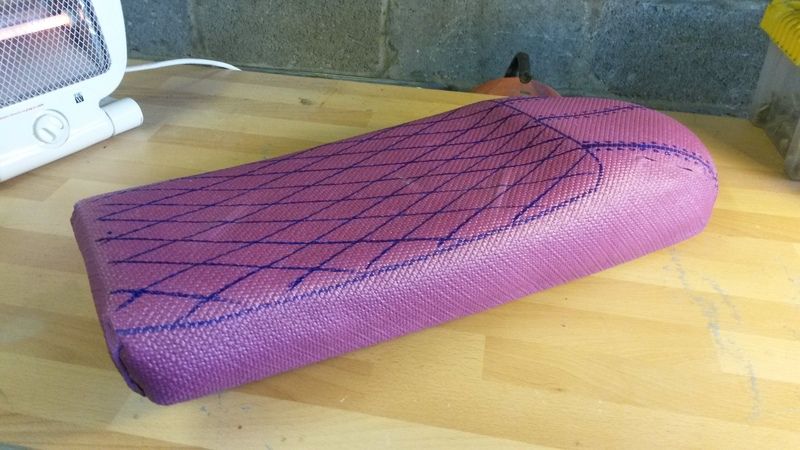

Really needed to get the seat in progress, so after an unsuccessful glueing marathon where the seat foam wouldn't stick around the edges due to too much elastacity I had to add another skin to tidy it all up. Turned out nice in the end me thinks :)
Drew a pattern to see how it might look....good imo.
Couldn't get the folds to suit the stitched seams I'd like but it's close enough.
Underside is neater and ready to take the cover. The razor sharp tin thingy is to hold down the cover securely.

Nice! Did you use chemical bonding medium (glue) to secure the yoga mat to the pan? What kind?
I used rattle can spray glue and wish I hadn't as it wasn't strong enough to hold the layers of mat to base and foam together. I then used a tin of EvoStik which was much better but by now I had a rough, multi-layered finish that would've looked gash when covered. So, I wrapped another skin over the whole lot and fixed it underneath as well, much better.
I was relying on the EvoStik to hold the foam to the ally base, but as I hadn't trimmed the foam to sit snugly enough (only roughly) it pulled away.
So my tip would be to make sure the foam is in good contact before glueing, rather than hope the glue will pull down the foam....it's all a learning curve :-)
Looking forward to seeing it covered :-)
